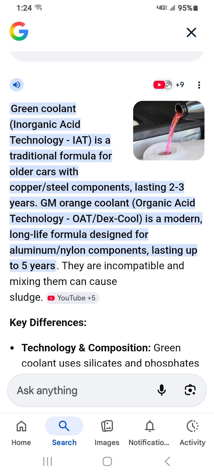

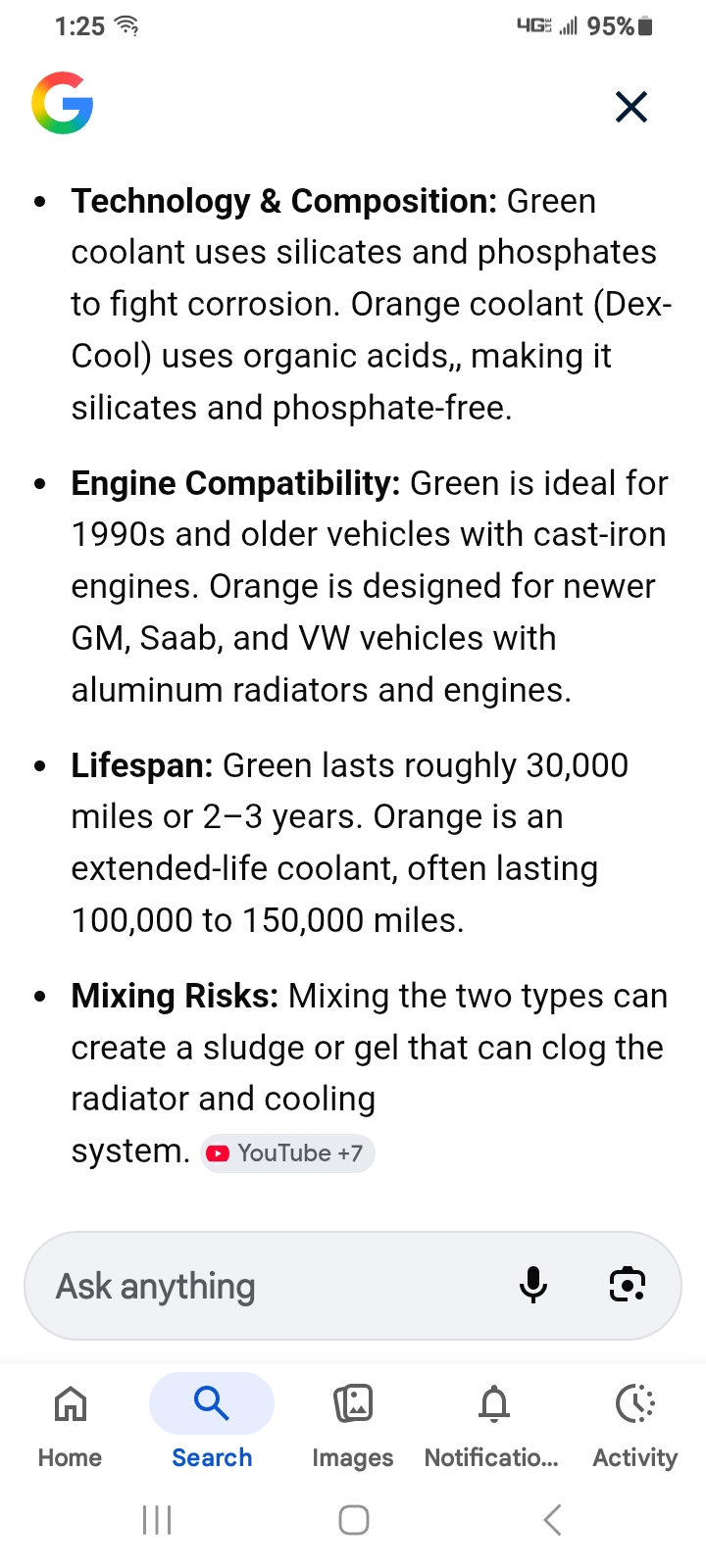

As far as coolant color goes newer engines use specific colors/coolants because of the additives requirements of specific engines. Long gone are the days of green coolant. Generally speaking gm is orange,ford is yellow, and asian is pink. I don't care what anyone's opinion is on this. Theres guys that say use 30w non detergent oil in your blower too. Do it at your own risk and when you have a problem its all on you. When all else fails consult your owners manual. Im pretty sure if it says only use 91 octane gas you wouldn't run it on 87 or would you??

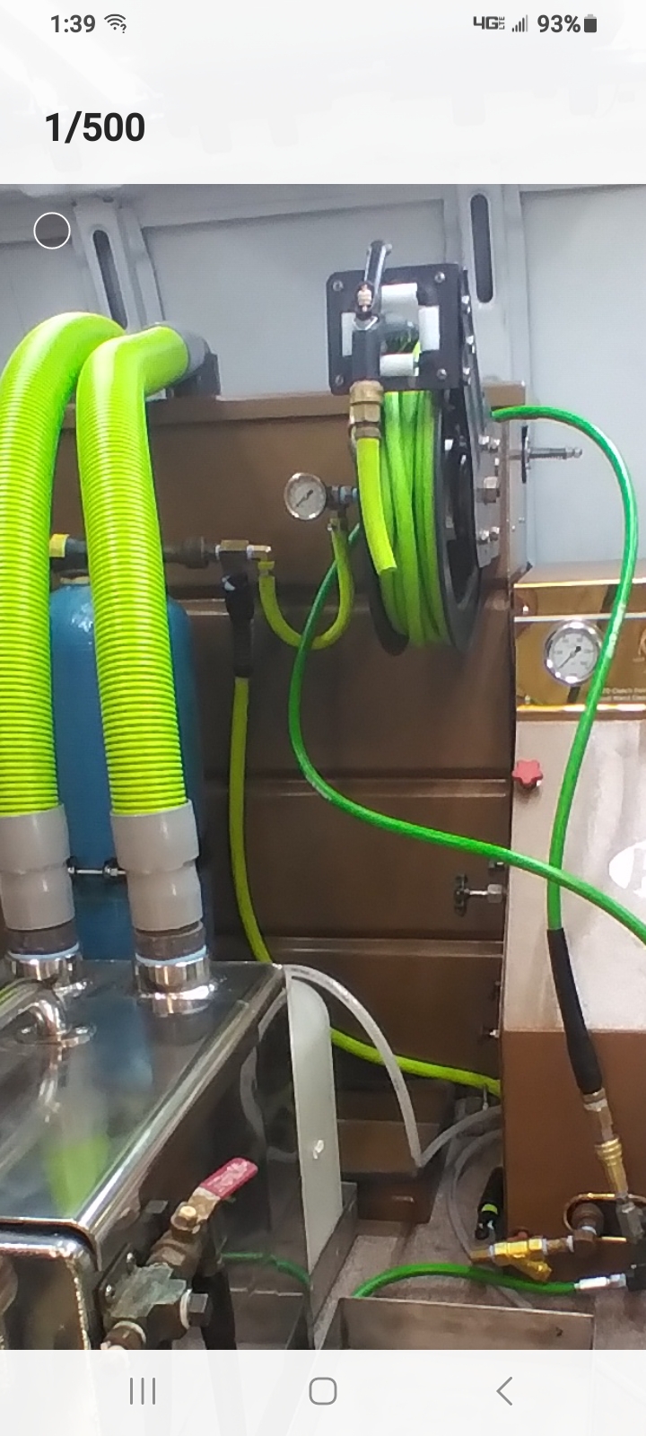

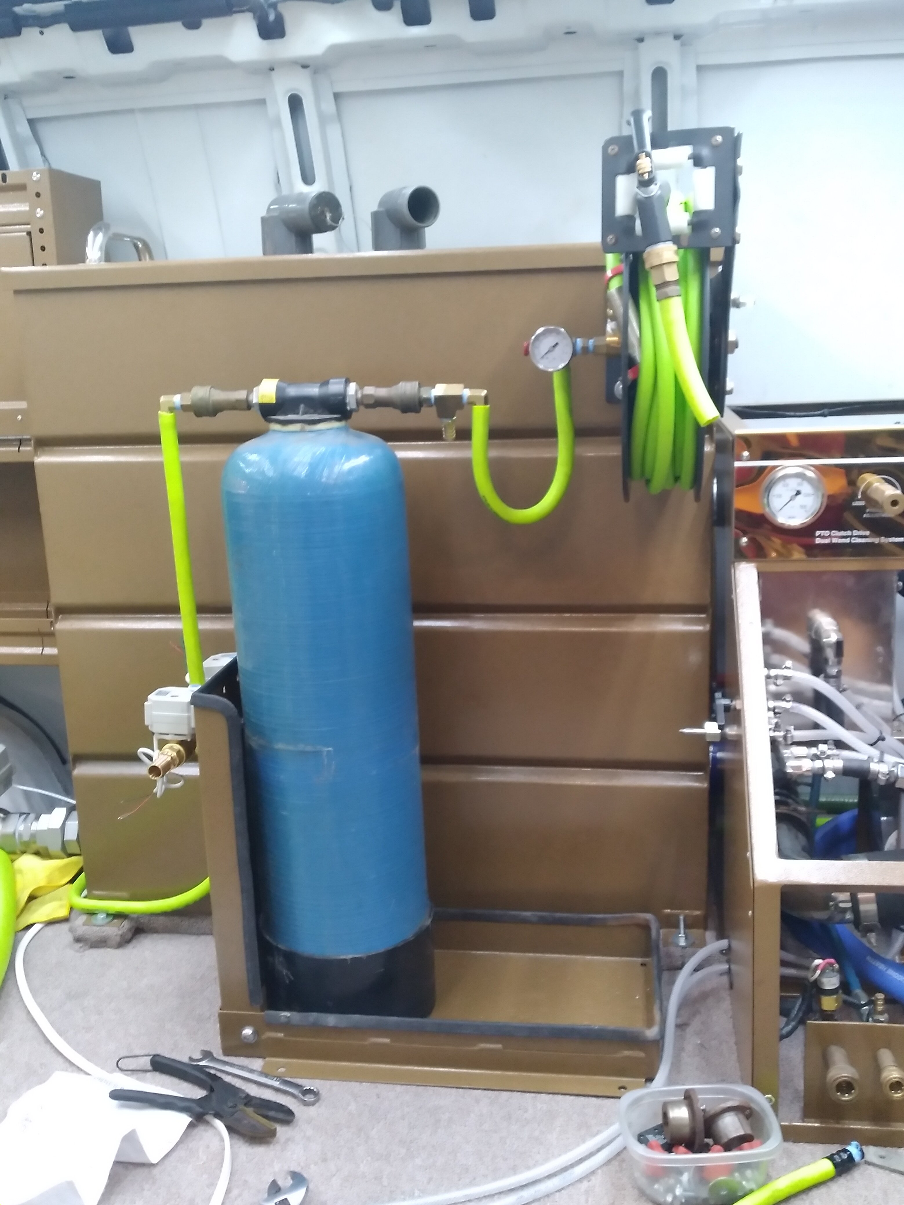

Now might be a good time for me use this situation to defend and explain why the installation of a 25' retractable hose reel hooked up to my fresh water system is an important and handy if for nothing else.... when seconds matter..... no un hooking, fumbling to remove disconnect and_or removing quick connects. Just grab and spray
Bryce C
DFW
Feb 9, 2024
1,358
Bryce
View attachment 134280 View attachment 134281
Good tips Dwain-o. In what situations would you need to rapidly spray fresh water?
I have a drain hose with a ball valve coming off my water box I use for everything. And if I need to spray something off I can use my solution line with a nozzle attached to a male quick connect..

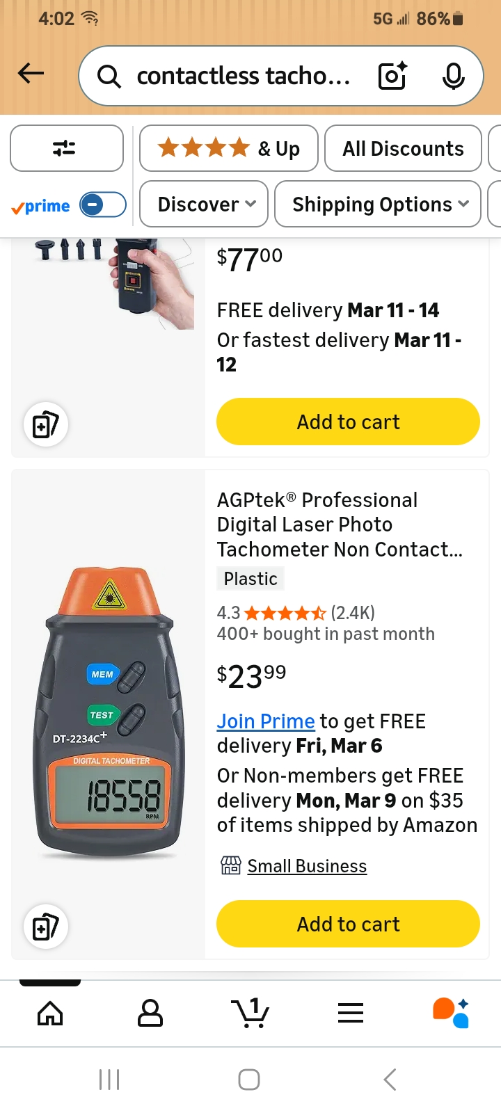

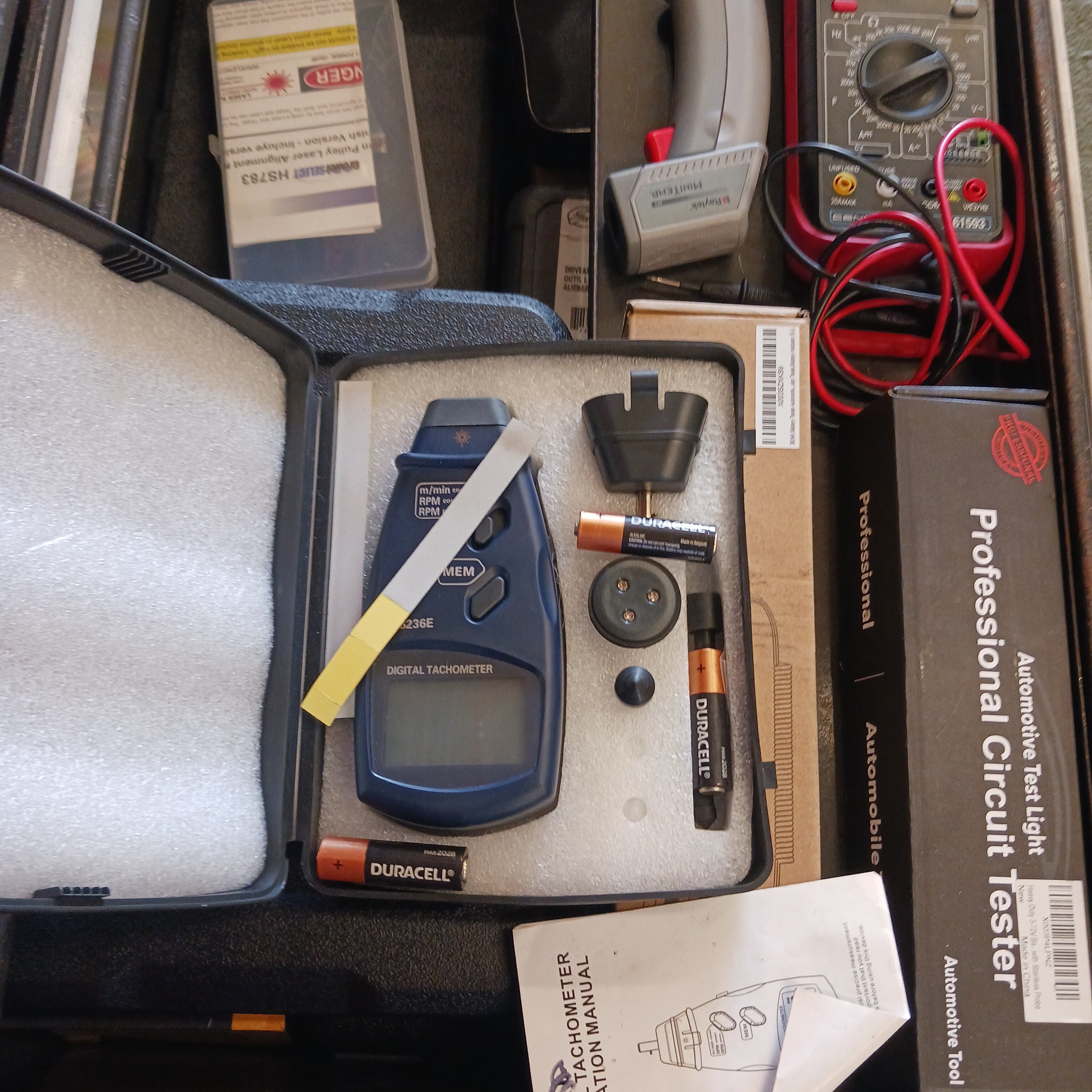

Another way to test a fan clutch i can share with you is with a contactless tachometer. They work by reading laser light off a reflecting tape target. You would put a pice of reflecting tape on a fan blade and another on the shaft connected to the waterpump and see the difference in rpms from cold to hot. But that requires you to have or have access to the tool

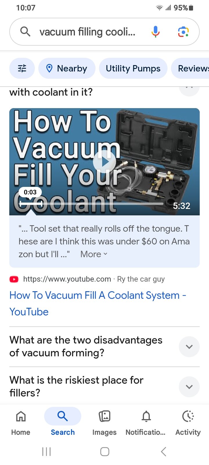

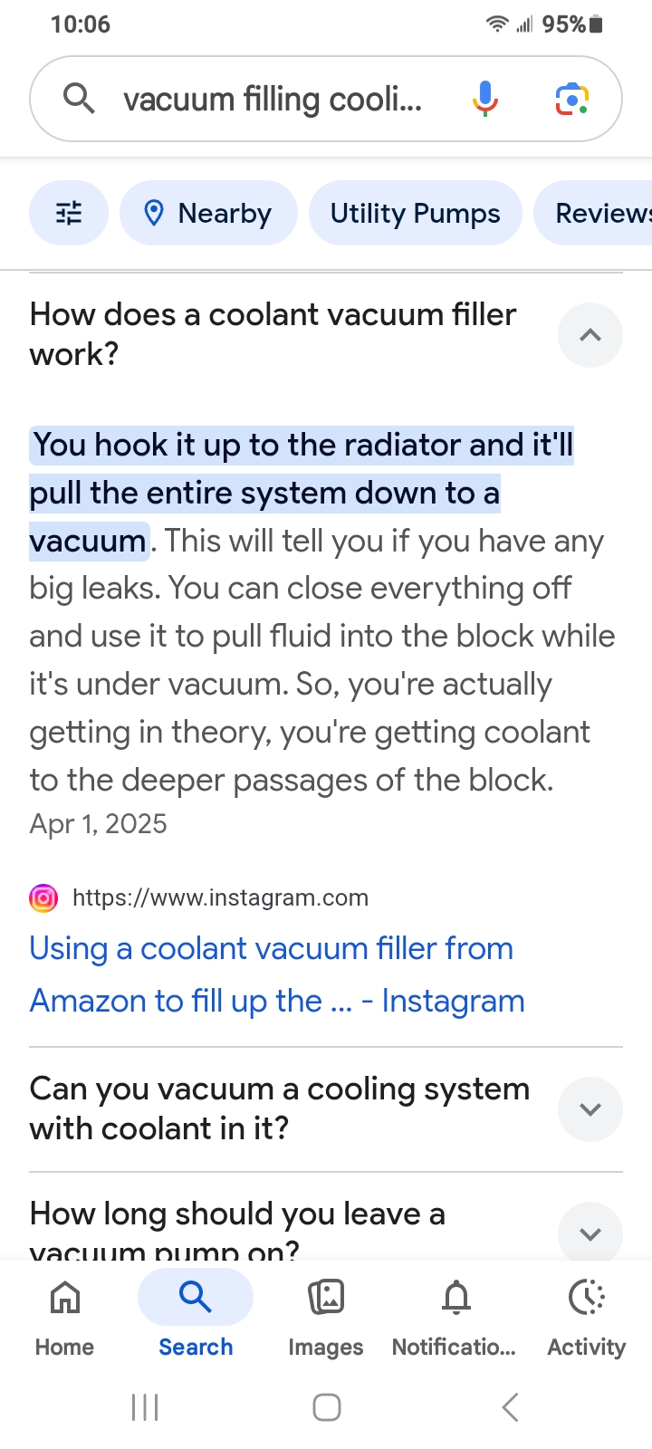

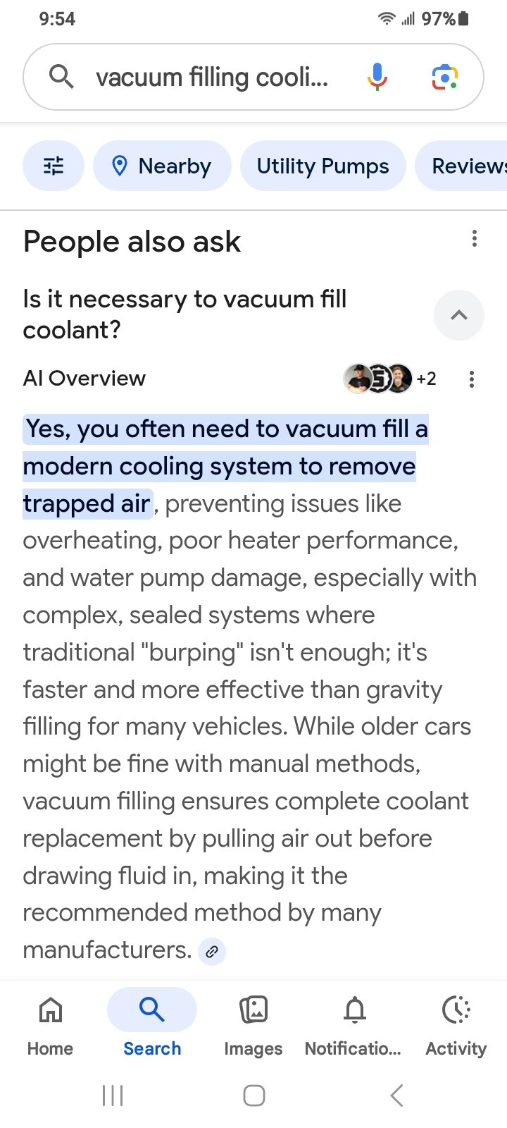

I don't know the specifics of your vehicle, but when i was building frankinstien the gm service manual and cleanco whos installation guide i referenced alot during the installation both strongly recommended vacuum filling the cooling system. And that was the way i did it and didn't have the air pocket problem. Here is some information i pulled on vacuum filling radiators. Mind you, im pretty mechanically inclined and till i got frankinstien id never heard of this. And when told about it was skeptical and formed opinions like ,it'll collapse the tubes in the radiator and heater core (you pulling basically the same vacuum as a tm 15") i thought it was snake oil voodoo. But after talking to a few mechanics i respected and watching several videos i bought and used the system and found no problems. In fact it detected a small leak in the hoses to my heat exchangers before filling. So i was abale to correct the problem before going any further.
Screenshot_20260305_095456_Google.jpg Screenshot_20260305_100609_Google.jpg Screenshot_20260305_100711_Google.jpg

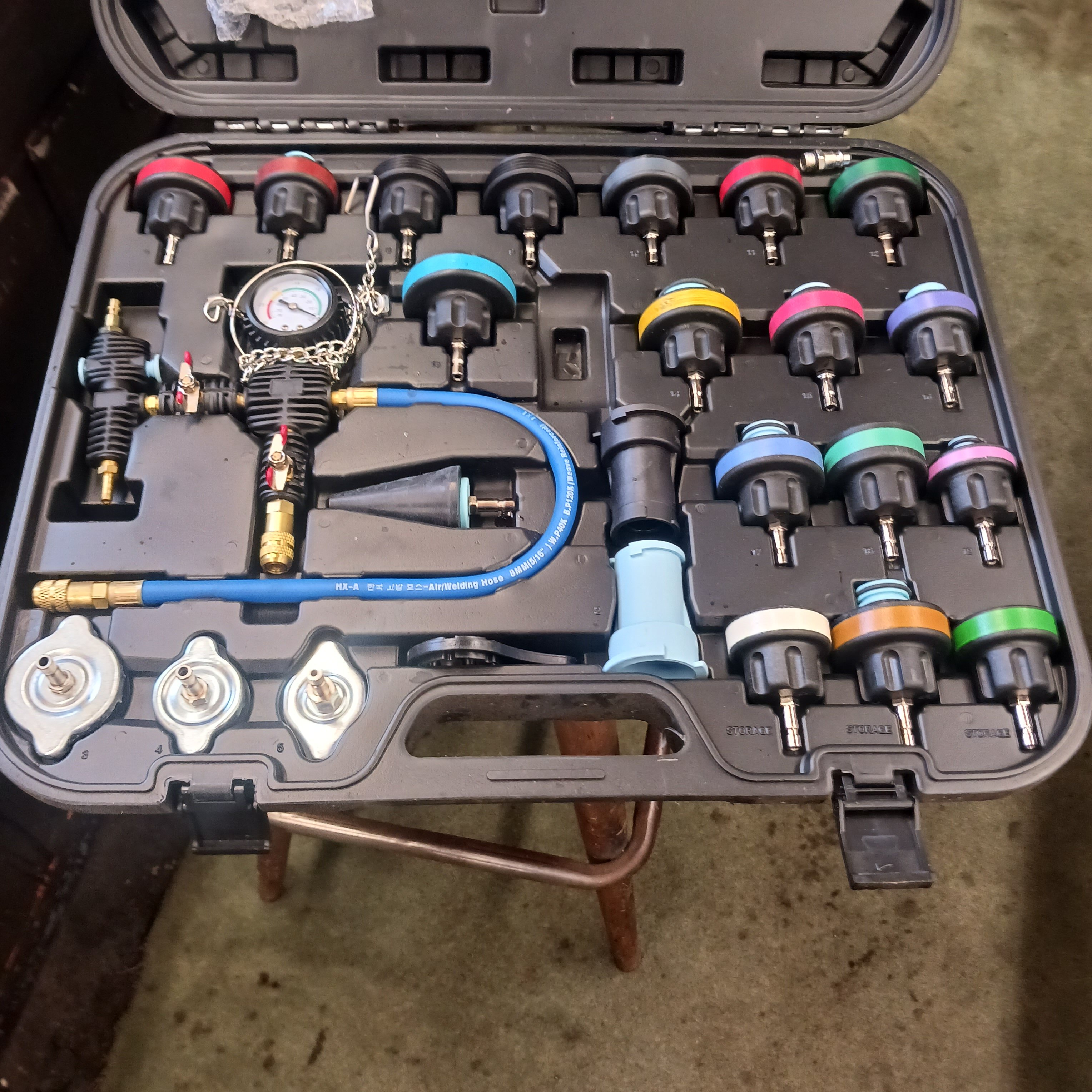

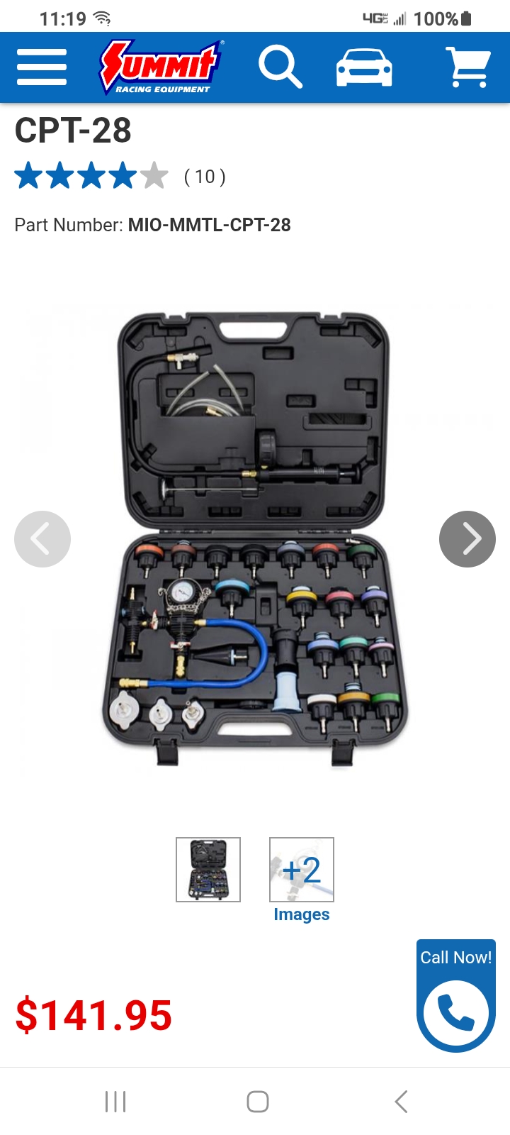

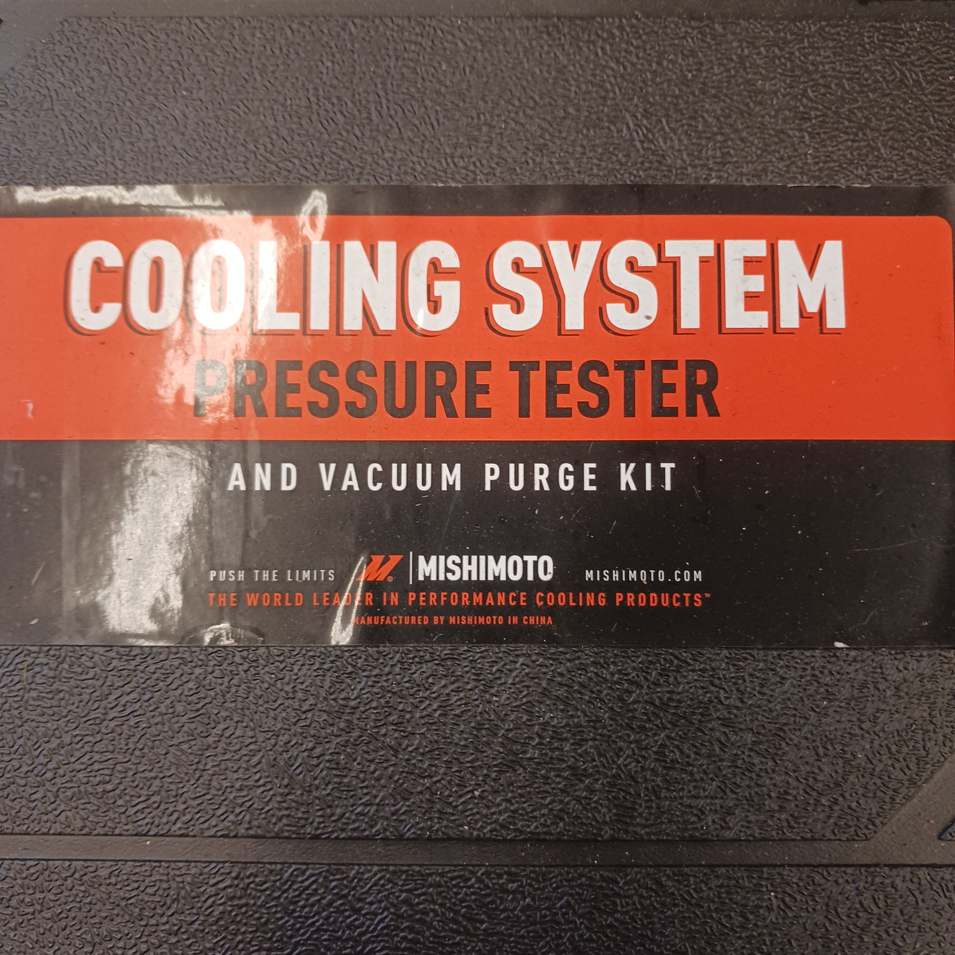

If your interested, this is the vacuum purge kit i bought. I bought this particular one because mishimoto is a respected name in performance cooling system components and it was a complete pressure testing and vacuum purge system all in one. But if you find yourself wanting a vacuum purge system there are plenty that will do the job for a fraction of what I paid. Happy successful burping. Dwain
View attachment 134285 View attachment 134286 View attachment 134287
Vacuum filling sounds like a good idea.
