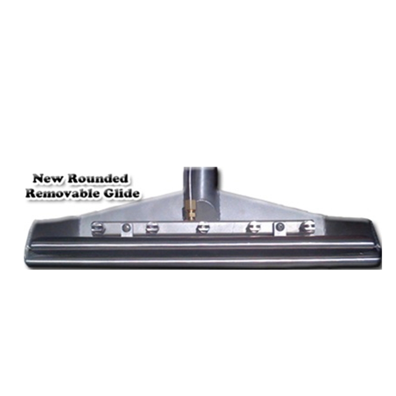

Big Boy Original! With New Rounded Stainless Steel lips!
This Big Boy wand started a following like we had never seen before. Now the same wand is even better with rounded stainless steel lips!
All decked out with 14” heads, 5 stainless jets, 1200 psi, low profile head for an incredible reach and ALL shiny stainless construction Big Boy is back to please.
The weight of this wand is all directed to the head to reduce chatter and make it easier to glide!
Should be easy to use but no base board and transition area protection that Glides provide

I love how he says all the weight is in the head so it will have less chatter.
That just tells me it's heavy as hell.
Would love to try one just for the hell of it.

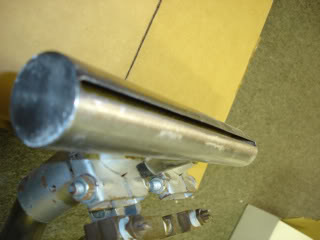

and when the rounded glide wears a thin flat spot at the vacuum slot and forms two razors, and the gap between those razors grows each month making pushing the wand real interesting.
Let me dig up a pic of this exact thing:
and let me tell you this, that slot is razor sharp.
