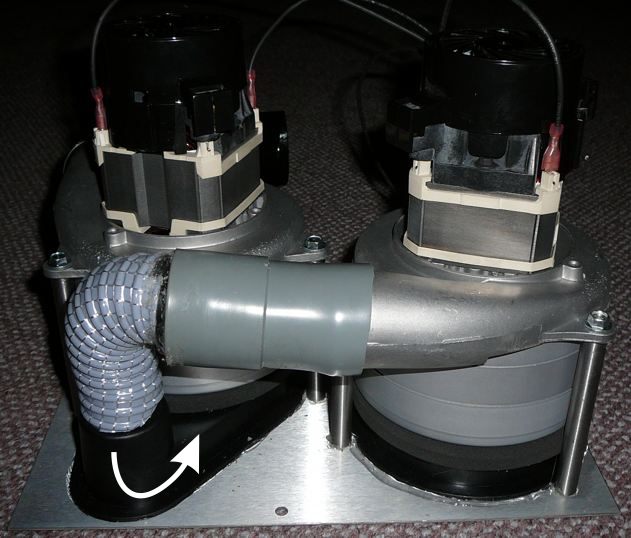

Larry Cobb said:
Here is a photo of the vac system:
The arrow denotes one area of porting we performed on this module.
Larry
Larry,
Why are using the 148" instead of the 154"?

John LaBarbera said:
Larry,
John;
So that the vacs can operate in series, on a 15 amp circuit,
with the 2.8amp pump motor.
We are also testing another vac motor.
The 17" hg does test your recovery tank strength.
Larry
P.S. The 154" is what we use in the AirHog 8)

Larry Cobb said:
[quote="John LaBarbera":da9n4quj]
Larry,
John;
Because it can operate in series, on a 15 amp circuit,
Larry
P.S. The 154" is what we use in the AirHog 8)[/quote:da9n4quj]
DOES THE VACUUM TANK PASS THE TEST? PRETTY STRONG, HUH?
Larry
Larry, the hose and cuff look a little cobbled up.
How about a nice 90 with some rubber connector boots or something?
Kevin;
The important flow parameter is the hose and connector going over the vac motor outlet and manifold inlet.
Steve;
The only tank under vacuum, is the grey round recovery tank.
Larry
