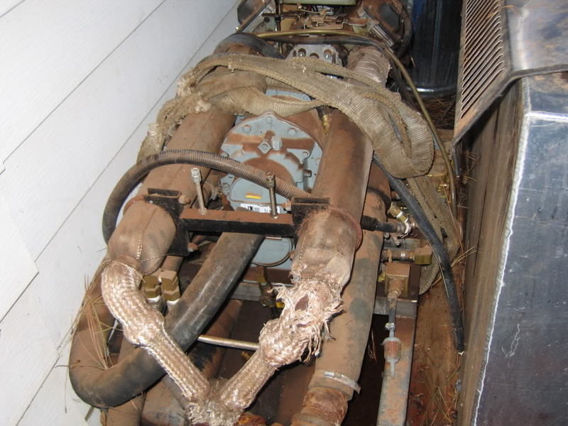

Its up and running no major damage at all what you see there is was the only damage the bolt came from the heat exchanger cover which is not in the pictures and I had never found it when I bought it was already off and I just figured that it was lost some time ago must have rattle down under the carb and fell in between the flywheel and motor housing.

Okay I cleaned my house today with my new machine. I got pretty good suction and I used my glide. I got decent heat especially by the end and when I was done went out to the machine and it said on the temp gauge 240 degrees not to bad. I still have to do some fine tuning and the pressure gauge isnt working right. The other thing I noticed was the vac relief was hissing open a bit with just the hoses hooked up and the wand attached just sucking air. vacumn gauge is not working either.

did I mention it only has 1534 hours on it even if the motor was shot the pump and blower were worth it, you should see the stainless steel frame it is built with all I can say is wow good crafstmenship.

Good Job Chad you needed a break. The thing will get blazin' hot but as you probably are noticing there is no way to regulate it so be careful putting the wand down.
G
gasaxe
murphys switchgauge and a stainless internal dema valve and it can be regulated cheap and easy. a little bit more money and im sure a diverter could be thrown on that thing pretty easy
