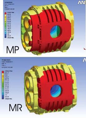

Looked at a blower in the new Sutorbilt 5LR series (#59) today.
The gearbox is separated from the impeller airspace.
The engineer had some thermal Infrared photos that showed the substantial reduction in heat at the gearbox.

These photos show two Infrared thermal images:
Top image is MP Blower showing heat transfer into "Gear Area"
Bottom image is MR Blower showing no heat transfer into "Gear Area"
Caption from MR thermal image:
With FEA thermal analysis, a good design was made great.
• Innovative bearing housing design with air gaps
reduce gear end sump temperatures by 15°F,
extending lubricant, bearing, and blower life
