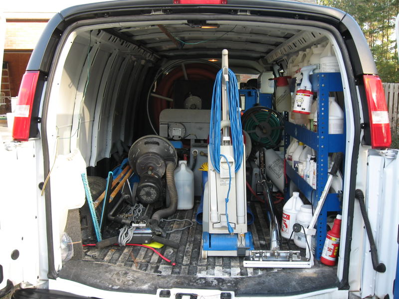

Do you have a fresh water tank ? Didn't see one in the photos. Who installed it for you? I'm gettin' one next week. High flow and all.

Air cooled 20 hp kohler, all the heat comes from the 3ht, may have too do like greenie said and put in some bigger jets, got the 11.5" prochem wand, just looked at the jets 303 stainless steel, they came stock with the wand, what size should replace them with?
