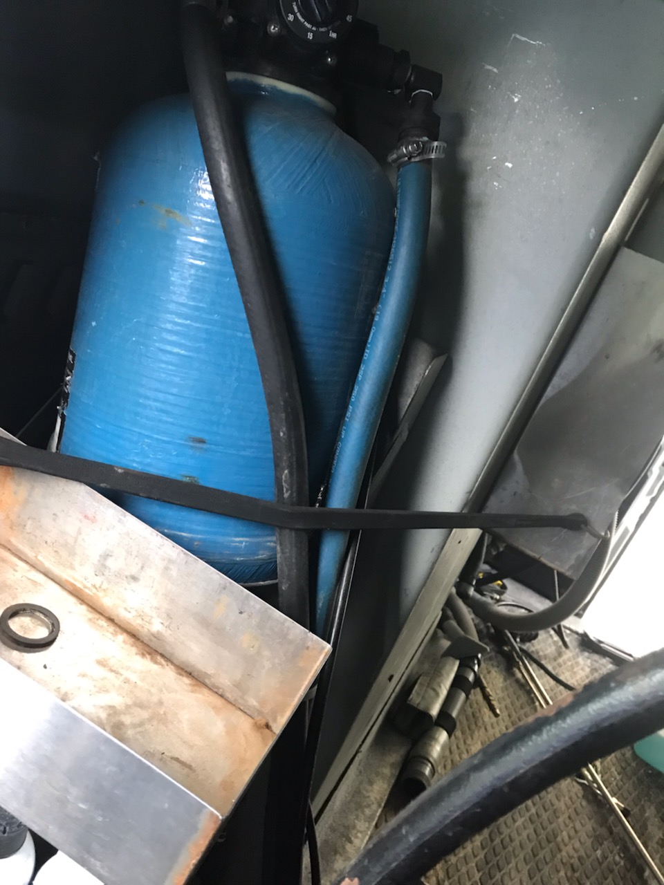

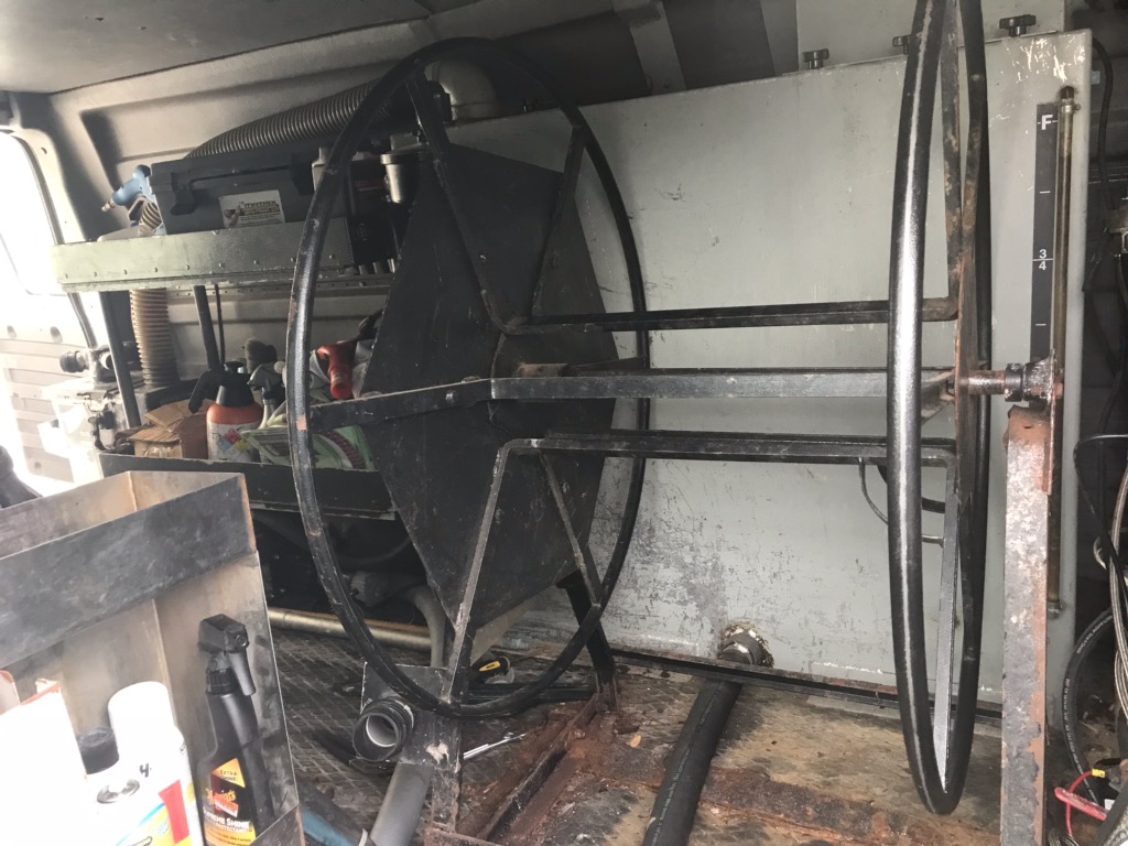

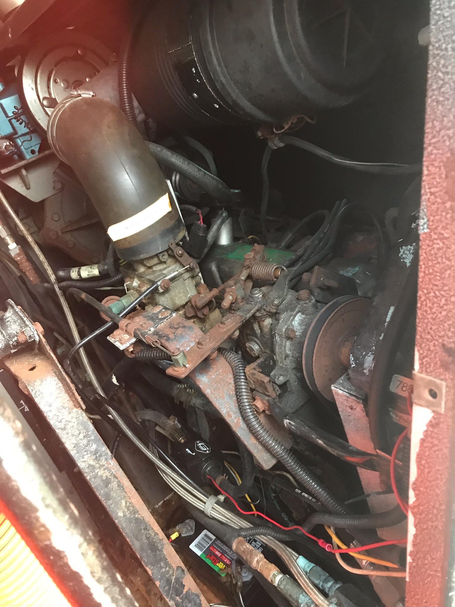

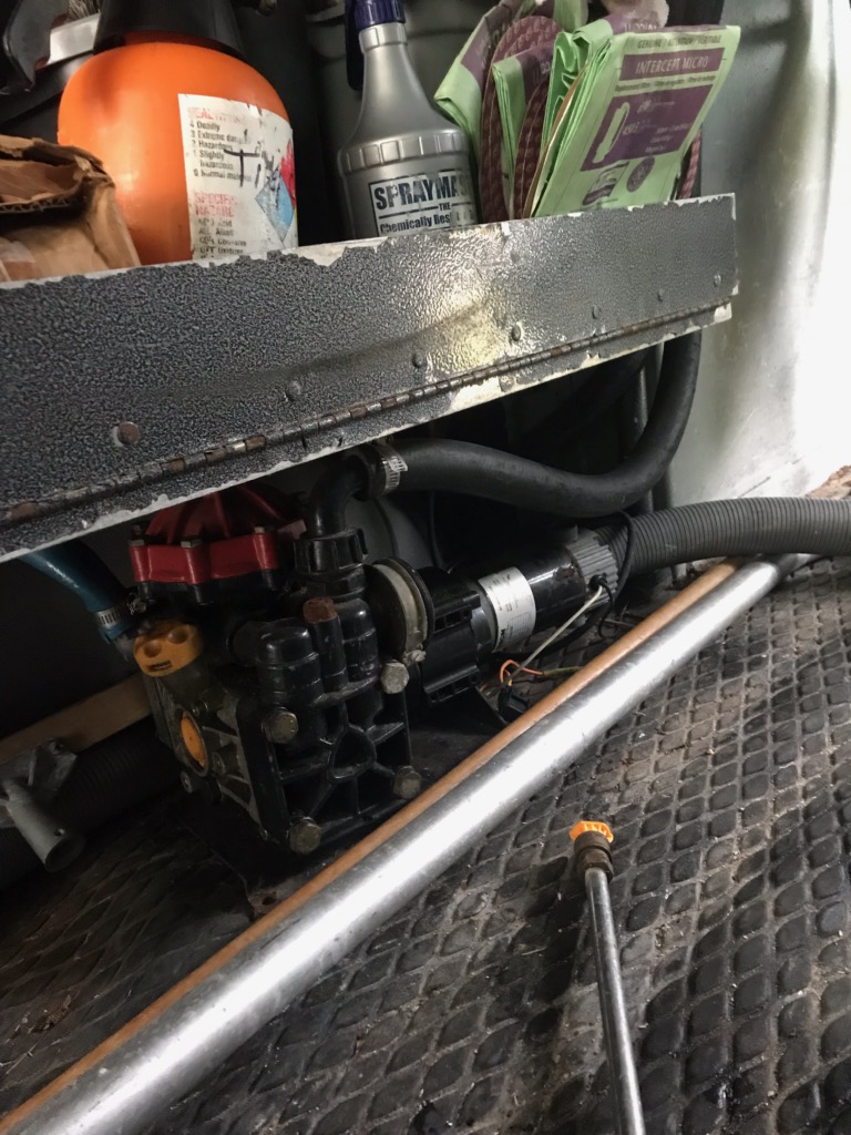

So here is an update... will need to replace some wiring, the battery will need to be changed, the clean water tank and softener were bypassed... this will be changed... the power hose reel has s separate motorcycle battery (why) will return to spec. Alternator will be tested. Prob needs new one... lots of cleaning up and paint needed... this should be a fun project!!

The separate battery close to the electric reel allows for the 40-50 amp load during the short time the reel is winding up without overheating wires that feed it. The battery can be recharged with a lower amp flow between uses.
Can this battery also be charged by the alternator? If I used heavier guage wire from the main battery, would that not negate the overheating wires?
18,851
Benton KY USA
Lee Stockwell
Yes it can be charged by the alternator.
I use the truck battery and run 6ga. cables to the hose reel motor and solenoid from the 50 amp fused auxiliary terminal on the driver side fusebox under the hood. (Chevy Express).
In your case the battery next to the load would negate the need for such thick power cables.
In either case, the reel motor will pull a LOT of amperage when you hit the button. Either above fix will work just fine.

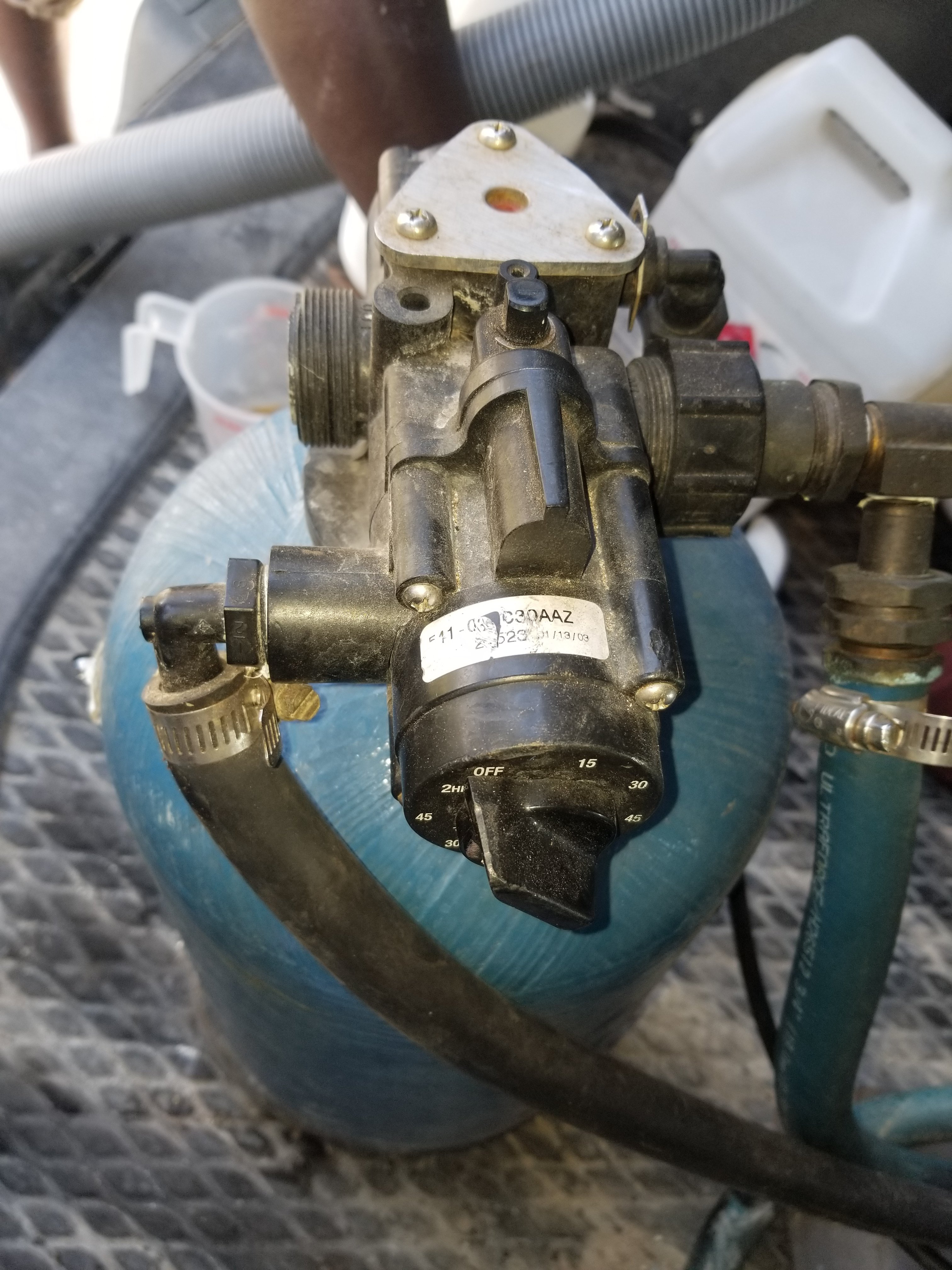

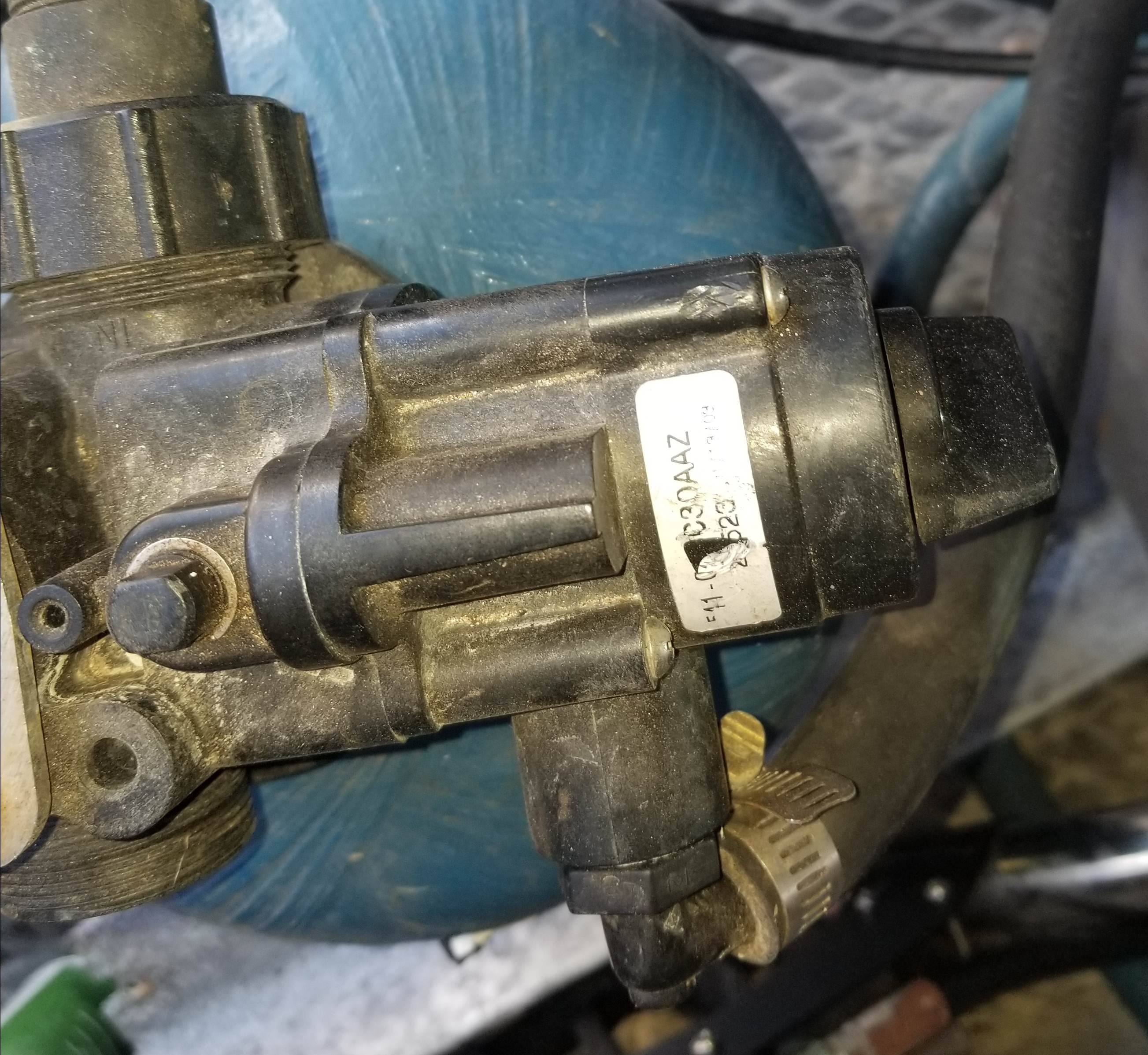

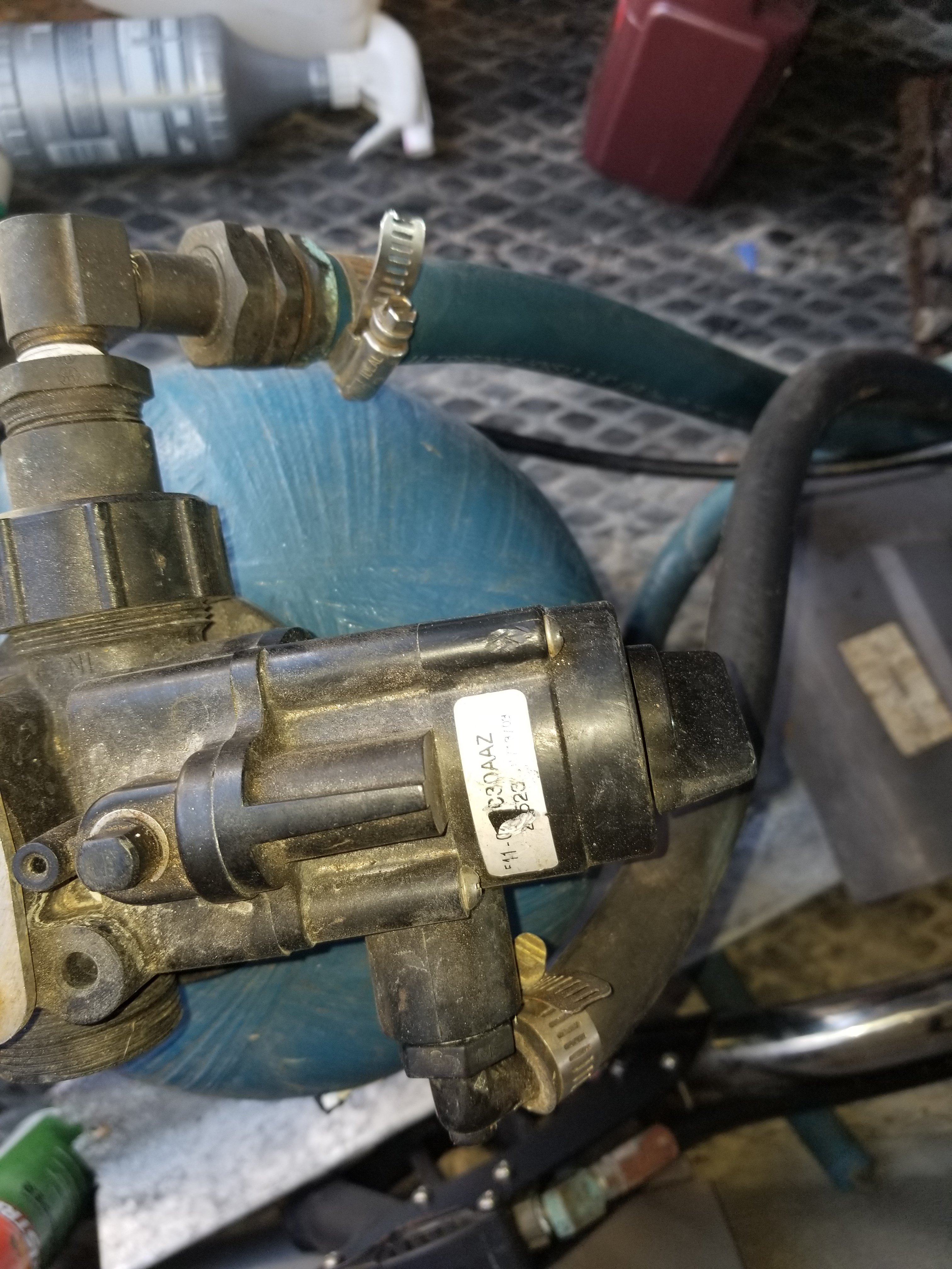

Some basic questions... Please understand that this is a learningexperience for me. I know some of these questions are very basic. The truck is not local to me but we will be working on it this weekend. Any input would be appreciated.
1. The "Clean Water Tank": I would like to know the progression from intake hose to Truck mount. Does the hose water go to the tank first, then the "pre-heater", then the super heater, then the machine? At what point is the chemicals injected? (I know this may vary from one manufacturer to another)... I also want to know what kind of pressure the lines before the heater should be expected. I am thinking of repiping some of this using PEX tubing and sharkbite fittings. I want to make sure pressures will be within ratings. I believe there is a softener for the incoming water as well. I assume that the softener should be before the clean water tank
think this is it
Valve – Erie 541-030 Egg Timer Softener Non-electric
****may not be exact model
