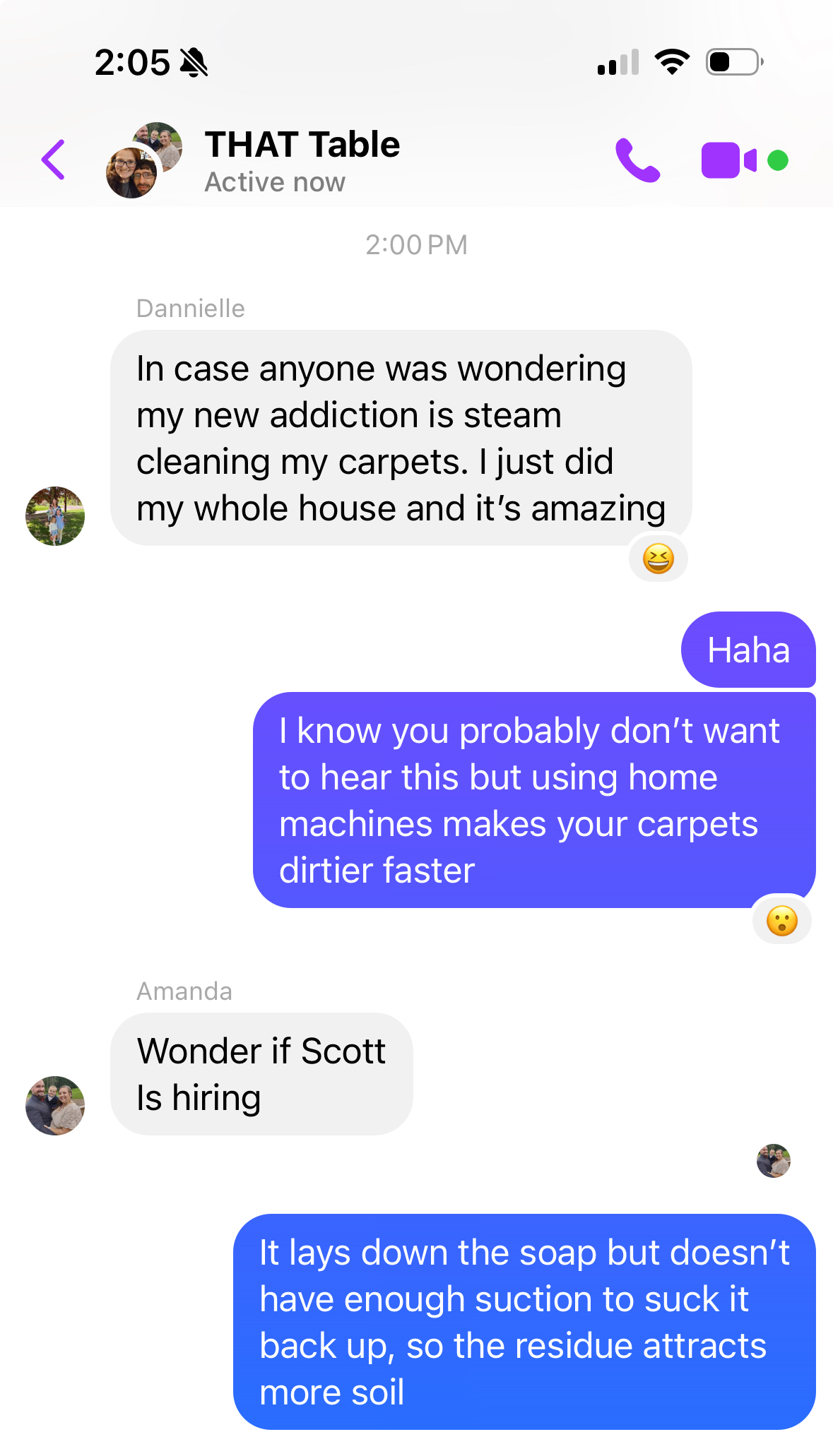

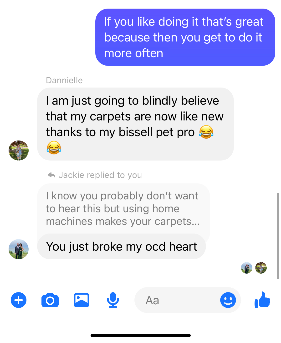

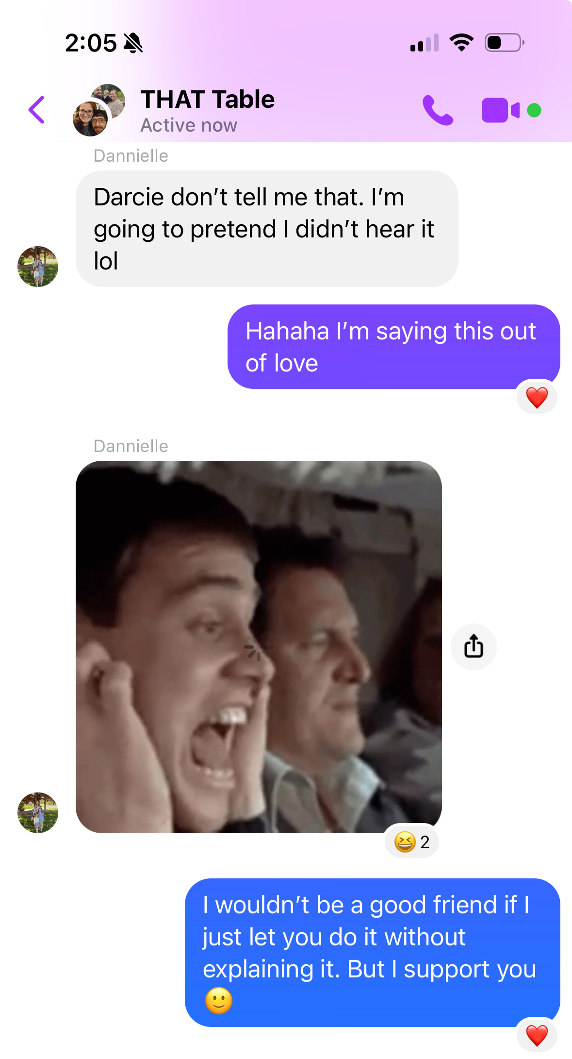

…just telling the hard truth to some of my local mom friends. This came up in the chat I have with four of my friends and I thought it might amuse you. I’m introducing them to the idea of truck-mounted cleaning slowly, three of them are stay at home moms who likely don’t have the disposable income. IMG_0918.jpegIMG_0919.jpeg

Well I would argue depends on what they're using.
The stuff they sell with those machines is garbage and attracts soil big time.
It will clean, and attract soil fast.
If she were to get a pump up sprayer lay down any decent carpet pre spray, rinse with white vinegar rinse.
Her results would last longer.
12,833
^^this^^
It's not the weak squirt 'n vac that causes the resoil.
it's the soap they load up in the machine.
The same results would/and do happen with a TM or pro-porty
if they can't afford a quality pro, and you want to help them..
Turn 'em on to encap juice to use as pre-spray.
Rinse with water in the machine.
