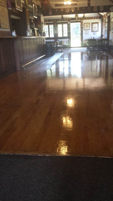

My Aptos house wood is done...
All that work just to let dust, grit and pooling fook up the finish.
Only a floor geeek like me would notice but good lord.
Dont skimp on the most important part for cripes sakes..

Did you coat it yourself?

I did my house in Michigan and was out talking to a neighbor and looked back at the house and the dog was looking out of the window of the room (36'x20') of the room that
just received a second coat of finish. Needed to screen and coat 3 more times to get paw prints out.

Will it stay adhered to the old finish? That is not a real aggressive pad to prep with is it? I use Woodstar by Pioneer on some commercial accounts that is a floor finish that can be burnished and they recommend using a black pad. If I were doing a floor with conventional finish I would screen or use a 3M prep pad.
Keep us updated on how it works out, looks good thoough.

Always holds, No prep to speak of other than cleaning it really well.

Willie, I am really struggling with a way to economically spiff up a wood floor for move-out customers and those who need the floors shiney. I could wax. But the refinishing products like Interlink Hydroforce shun anything ever waxed, and I don't want to ruin their chances for that later.
Can you advise me? For example, is it ok to use a non-wax polymer floor finish (for VCT) on wood if applied over a clean surface?

Economically is the key word. I'm getting really low on the product I have used and the costs and extra work involved scare me.This is spendy, but they have other great products, don;t see this as any different, I always 175 with a red or blue pad and ultras cleaner and conditioner. A clear water mop and dry and I'm good to go. I dunno about vct products on wood though as I don't know if they would adhere and how to go about stripping them.

You really don't want to use vct floor finish on a wood floor. It would look good when you are finished coating the floor but will not hold up for long.
The wood floor guys will hate you when they go in to do it properly. They have to strip the entire floor and make certain that they get it all off. The wet stripping can cause real problems.

Ray, I hear what you are saying there about the vct finish not lasting a long time. Since we can assume the maid has been swabbing with Glop-n-Blow, is there an alternative short of applying urethane?

Basic Coatings has a product that you squirt down from the bottle and spread with a flat mop.
You would still need to strip the mop and glow off the floor.

Okay, thank you! There is a distributer in Birmingham that I will visit tomorrow. Maybe herself will let me do our livingroom floor for practice.
If it flubs and you never hear from me again, just remember my heart was good even if my skills weren't, hahaha!
