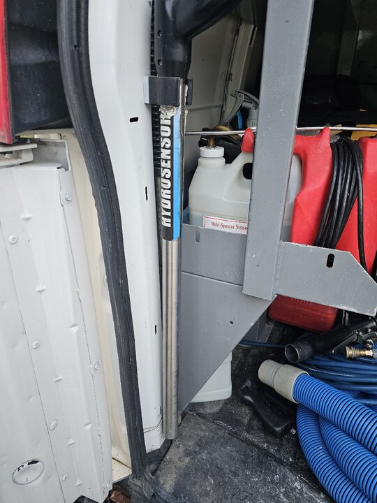

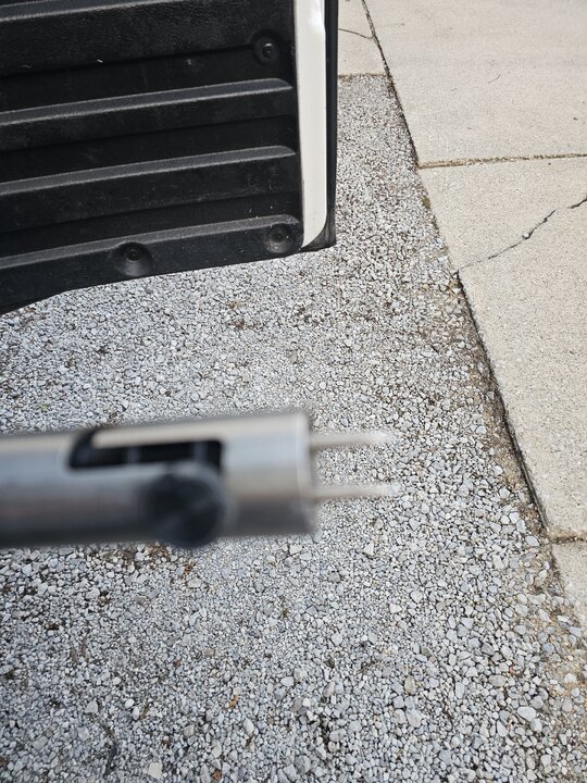

View attachment 132351View attachment 132352
I use a moisture detector. It goes off when I rest it on the top of my shoes from the sweat and salts. Its very sensitive.
I use odorcide in my hydroforce. Depending on the severity depends on how strong I mix it if I mix it at all.
I will add dry slurry to the mix for cleaning strength.
I start out searching for the spots before I do anything else so I know what im in for then I soak all the spots heavily and treat all the carpet. It gets tracked around.
Then I bring in the vacuum hoses and wand so there is some dwell time and gravity can do its thing.
I also run odorcide through the solution line on every job.

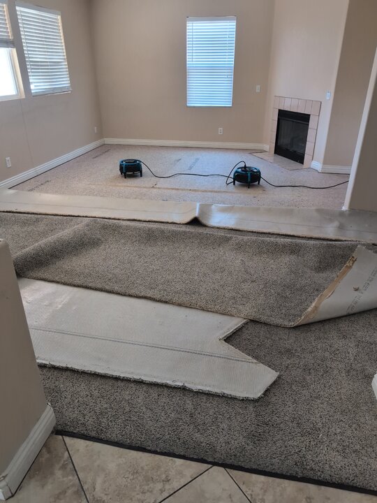

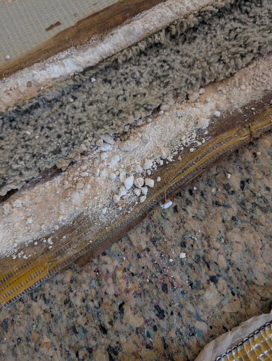

This is actually nylon, no smell, they needed stretching.
All long the seam was lumped up and hard.
I believe they used carpet fresh and a Bissell so much rock hard crystal powder stuck to the carpet and clumped under the seam tape.
Like a chia pet growing.
PXL_20250825_210245728.jpg 9b43cd9d-7c8e-4698-86d6-4f17fb8443fb.jpg PXL_20250826_015129447.jpg
11,524
Ps the pad was damp no smell to undried with fans before I put it back together
