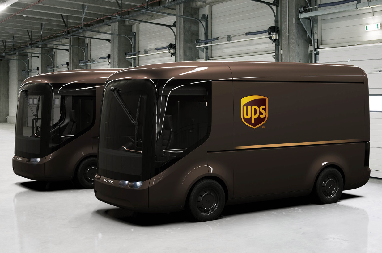

Of all the gossip about the new vans out there
14,126
Could you see a multi million $ franchise rug sucking company slapping their logo on one of these with a Hydramaster electro CDS?
27,878
