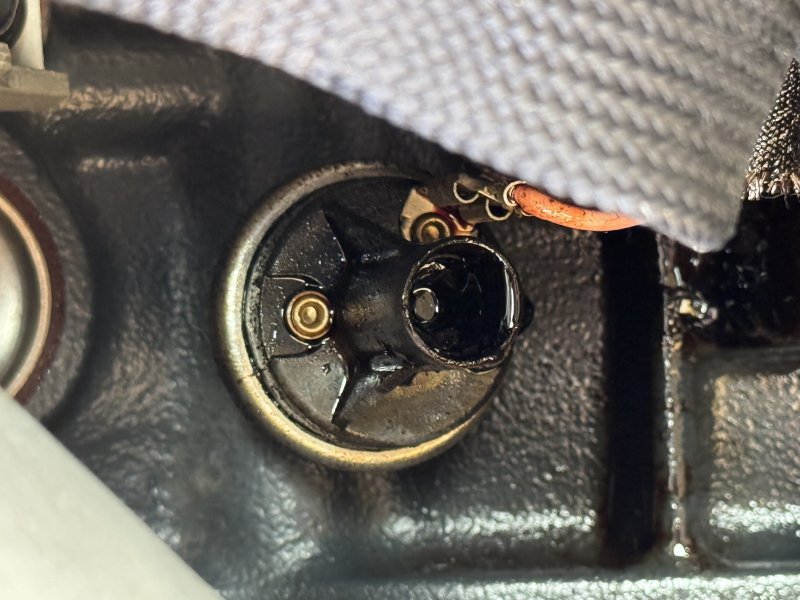

Hi guys I have a problem this thing is leaking pretty heavy and I just noticed it
It looks like it’s missing the cap in the center
I need to complete my day tomorrow but not sure how I’m gonna
The part number shows it’s a prochem part but is there anything I can grab at autozone to fix this and not wait

You can temporarily bypass the switch by removing it and plunging the hole with a 1/8 pipe plug if the machine won't start/stay running that means the switch is normally open and youll have to connect to two wires together. Keep in mind that you are bypassing a safty switch and it should be replaced asap but that should get ya back to work

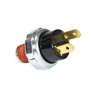

14,611
Yes, you can pick one up at the auto parts store. I bought a couple of them to keep on hand for a spare. Give me about an hour and I'll have a part number available for you to pick up
14,611
This is the updated version I have on my everest
Amazon product
View: https://www.amazon.com/Standard-Motor-Products-PS-135-Pressure/dp/B0011TY9VK/ref=asc_df_B0011TY9VK?mcid=184eb40bc4f53ffba68befef81a89e72&hvocijid=16017042778012889439-B0011TY9VK-&hvexpln=73&tag=hyprod-20&linkCode=df0&hvadid=730434204848&hvpos=&hvnetw=g&hvrand=16017042778012889439&hvpone=&hvptwo=&hvqmt=&hvdev=c&hvdvcmdl=&hvlocint=&hvlocphy=9057435&hvtargid=pla-2281435178338&psc=1
And the version you have pictured is the old version. the part number on it is 78826 7psi 2030 mex1
14,611
The plastic headed one you have crapped the same way on mine as well because the plastic weakened due to the heat over time

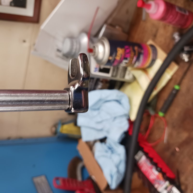

If you can't get a wrench in a 1/2" crowsfoot or a plumber's wrench should work
