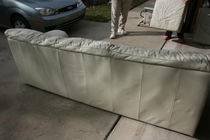

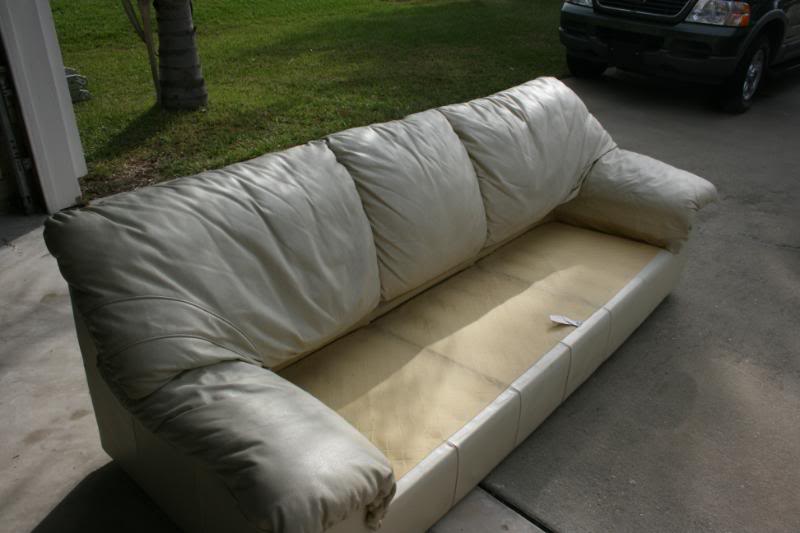

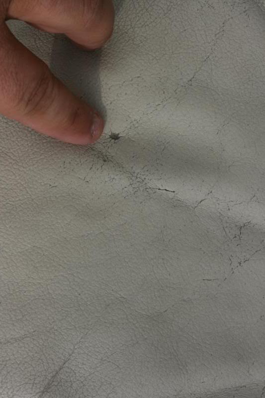

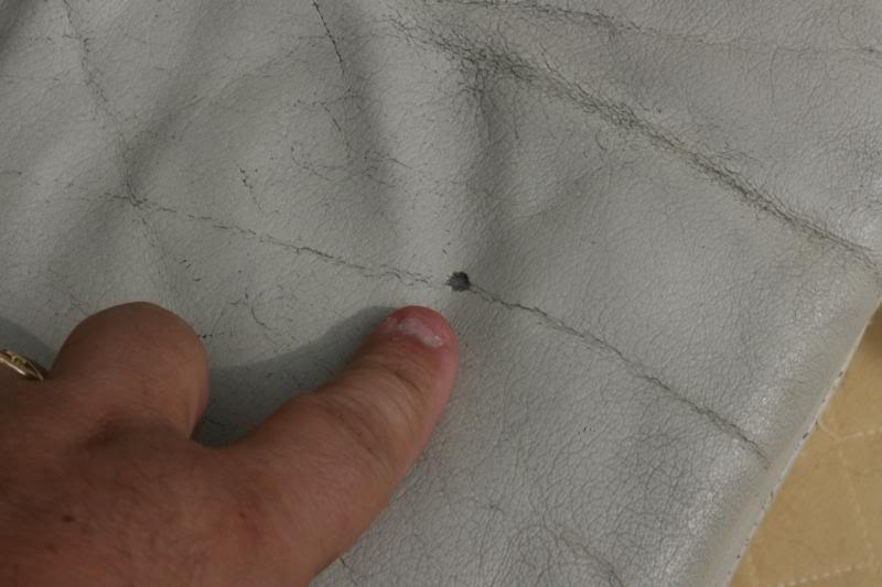

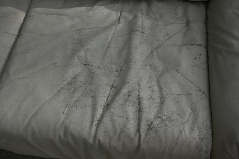

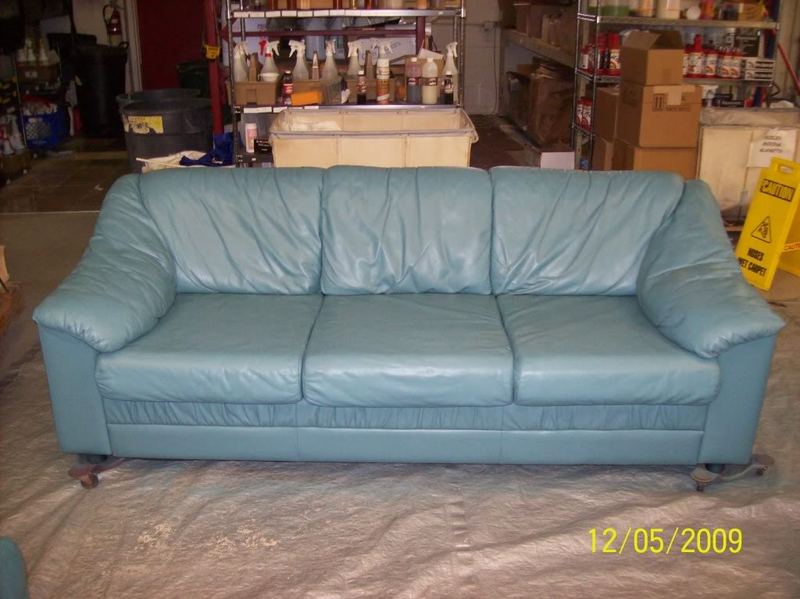

after a bunch of pics and questions i finally have a piece that i can do..
this is a sofa that a customer gave me because she was going to toss it..
so this is a piece that is in my garage and ready to be played with, i cant wait to
get this done so i can start pushing this service to my customers..i just needed to do one
before i really pushed it..
here are the pics
if you can tell me what i need and how much of it i need a little direction and i will get started..
thanks
by the way...we want to paint it light brown

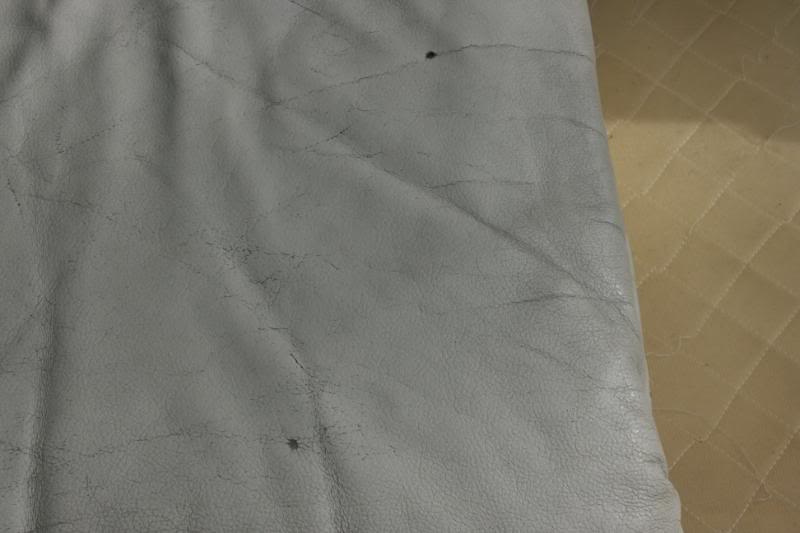

Damn Gill those are disgusting. What the hell are you so stressed about that you would chew on yourself that much?
I can tell you this, you'll have to sand down that cracked leather, bondo it and air brush the color back.

Dave will need to first of all clean with some scotchbrite pads and rinse the whole piece.
Then apply some Hydrator and cover with saran-wrap overnight for several days.
Then repeat the same process with fatliquor.
This will close up a lot of the cracks that were caused by the leather having dried out.
Once that process has been completed the remaining cracks and nicks can be be filled with leather filler and sanded,
Then you can start to airbrush or pad on the color coat.
I would not advise a color change because on the outside back and sides you will be coloring over the old top coat and so it may not bond well enough.
Roger does have a great product called "Adhesion" that may overcome this problem but since I have stopped offering color change services I do not know if this would work.

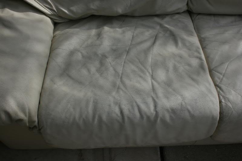

Dave, what I'd like you to do is to take a few pictures, both "with" and "without" flash.
Mark the floor with a piece of masking tape right where the front of your feet are when taking the pics - this is so that the "after" pics will be, as close as possible, to identical.
It would be great if you could have a ruler or two in the picture also.
Also take a few close ups of the same area.
After you have taken the pics, I'd like you to go ahead and clean those cushions or the whole piece, then let them dry for a day and then take a set of "after" pics.
Please take note of the time this the cleaning took you to complete.
I'm guessing that the result will be much the same or worse than before you started. Then we can talk about how much that service would be worth to a customer and how it could affect your reputation as a Professional.

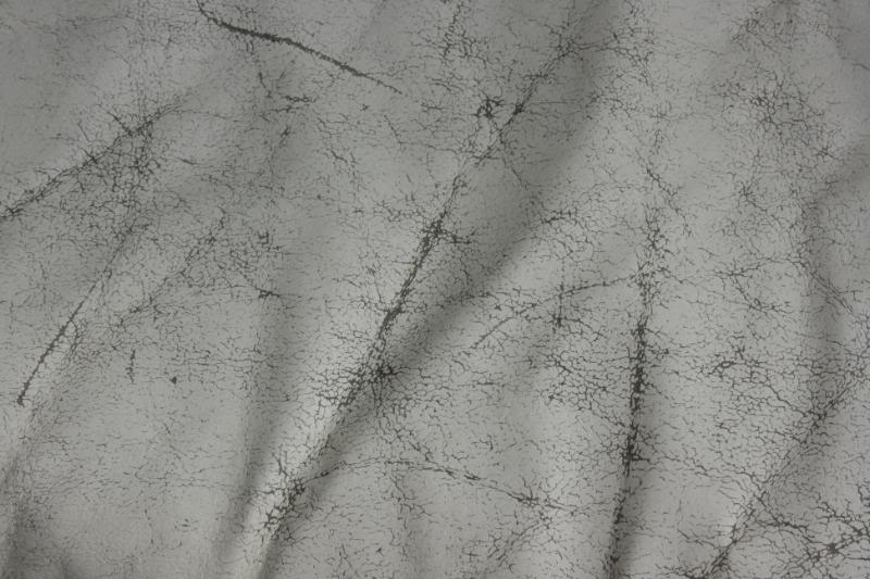

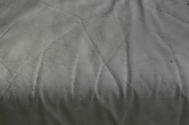

So you wish to transform your sofa like this 15 year old piece into a 15 hour old piece as shown in these pictures.
#1: Before
#2: After

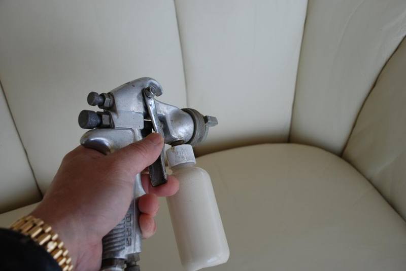

See if you can get a gun like this:
It’s a Devilbiss with three controls for 1] pattern, 2] flow and 3] air.
Then match up to a compressor that you need – needless to say the bigger the tank the better.
Practice it and you will be ready how to manipulate the three controls to give the best performance.
And I used one each for the color and topcoat until the job is done.
This modified model is obsolete.
However it’s the same gun ever since I started doing refinishing in the mid ‘80’s.
I have also tried many other guns (cheap) but became expensive since it has their problems.
If you don’t like the functionality of spray gun on your hand, you are already defeated.
And if you want to save on this workhorse, refinishing will be a drag.
It will kill your motivation to look out for more jobs.
So let’s see how your enthusiasm goes!

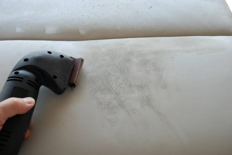

Don’t worry about side entertainment – get the right tools first and practice if you like it especially the spray guns.

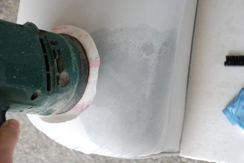

Next is sanding tools – one for detailing and one for general surface as shown.
It’s preferably used one that has speed control.
And sanding disc for the oscillating sander – get the 1000, 1200 and 1500 sanding grade.

got the sanding tools already..i will pick up the sandpaper tomorrow...
so do i just start like it is a car till all the finish is off, stop when it is down to bare leather
or do i want to scuff the leather as well?

Dave, if you are going to use a sander may I suggest that start off by wrapping the sandpaper around a sponge ( remove any rings from you hands ) and begin by sanding by hand just to get a feel for it. Whenever you are sanding start with a medium grit and go light. You can always move to a coarser grit and a heavier hand. We do a lot of sanding by hand. If the leather is really brittle, thin or dried out, be very careful as you don't want to rip s new hole in a cushion. Roger has products that will re-hydrate the leather and strengthen it's structure.
Good luck and take lots of pictures for your future brochures and web-site - you can always delete them if you screw up.

Here is the General Structure of Leather Refinishing:
1. Prep Cleaning
2. Leather Structure Rejuvenating
3. Impregnation
4. Repairs
5. Adhesion Coat
6. Color Coat
7. Top Coat
8. Feel Coat
9. Quality Control
And here are some reasons why the need for such details.
Leather upholstery refinishing must return the leather to practical use for the next 3 – 5 years at least without major failure to its leather structure and its finishing.
Failure to the leather structure result in cracking and failure to the finishes result in peeling, poor wet and dry rubs that result in premature wear.
The leather structure is where the strength and suppleness lies and especially non-absorbent leathers that become absorbent especially on wear areas and micro-cracks need special attention to “rejuvenate” them.

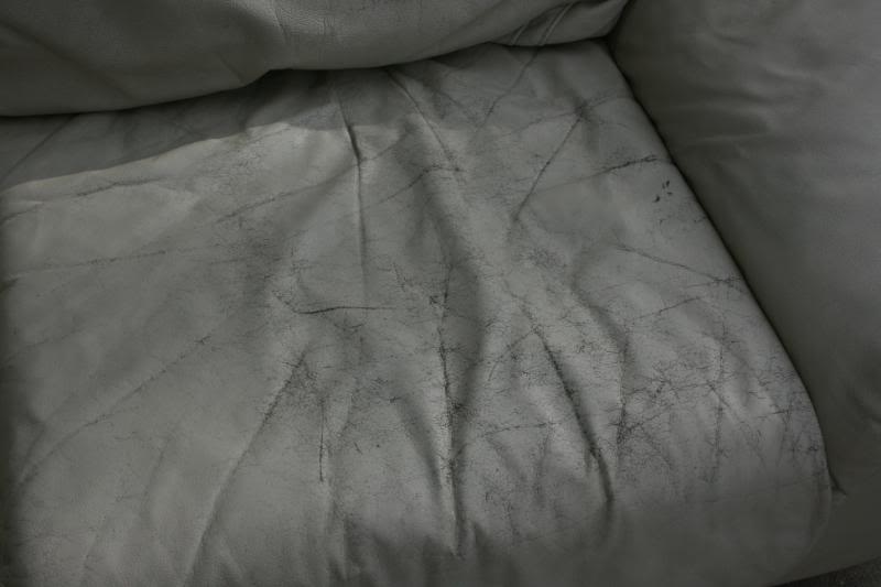

These areas can be easily be identified by the darkening effect once the leather is prep clean during the rinse process.
Needless to say by the look of these cushions, they qualify to be rejuvenated, impregnated and repair unlike the remaining parts of the sofa.
The final test to the cushion need an “Adhesion Test or commonly known as the Scotch Tape Test” and for me I prefer to use the 2” industrial strength tape to press it down tight and pull to see the strength of adhesion. And if it fails on the worst piece of cushion the whole system has to be re-evaluated before processing the rest of the cushion and frame. So we only go ahead on the worst cushion and test it out even flexing the finish leather if it is supple enough and don’t look too “plastiky”.
So besides the “Adhesion”, I do the “Compressibility”, “Stretchability” and “Flexibility” test.
For leather refinishing it’s better to check thrice and do once to avoid the recall.
The customer is made known of these quality control so that we can provide with a three years warranty.
So he knows service like this call for a Premium price.
It is the saving over buying new furniture that he will consider rejuvenating and refinishing cheap.
Other than that it is not a win-win situation and may cause our reputation.

Do the one cushion as you please for comparison of system approach and do mark to identify it.
Leave one cushion and try out with this recommended approach.
Prep Cleaning:
1. Examine the existing condition of finishes by giving it a 2” Scotch-Tape test.
2. This test will determine whether the entire finish is to be removed to the crust or partially.
3. Prep clean it with a pH 7.7 prep cleaner by application, horsehair brush agitation and spreading it as thin as possible with an even coverage and let dwell overnight.
4. Clean off suspended contamination with a pH 3.8 cleaner and rinse with a pH 3.0 rinse.
5. This is where our decision to remove the existing finishes begins after rinsing.
6. If the Scotch-Tape test reveal that the finish have to go, it may be easier to remove it clean with a leather Razor by hand in combination with spray rinse.
7. Otherwise the existing finish will be partially wet sand without hurting the leather crust.
8. Note: While the leather crust is acidified with a pH 3.0 rinse, it’s cationize and is stronger than dry and have less chance from being hurt than if it is dry. Do not remove any damage leather at this stage; leave it for the repair stage.

1. Color Coating
To control the flow of color coating a thickening agent helps to improve hold-up especially on vertical panels.
This is practice by adding 5 to 10% into the color coat prior to spraying.
Sanding again comes in for the repairs areas
Note:
This is a “green” system, where no solvent or alcohol is used for the entire process.
It’s Non-Hazardous, Non-Toxic and Environmental friendly without the VOC.

ok..i am glad i didn't go after it with the sand paper before i read this post..
i will do the test and report back..
and i want to use all your products so if you could give me part numbers and amounts i will need for
this project i will get it ordered and start my project.
i will report the scotch tape results later today.
thanks
dave
