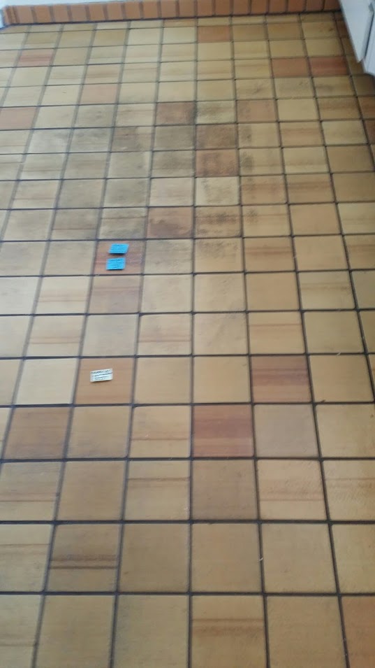

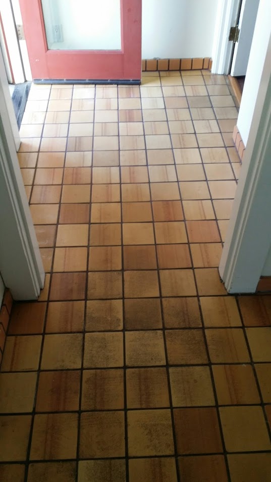

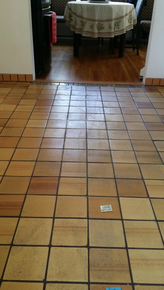

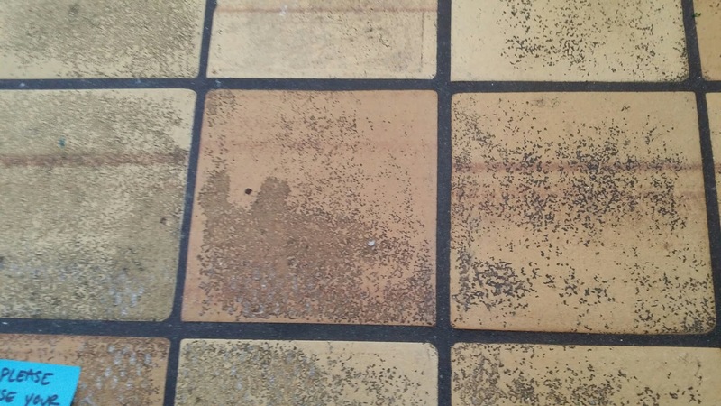

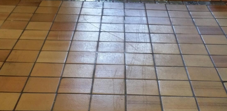

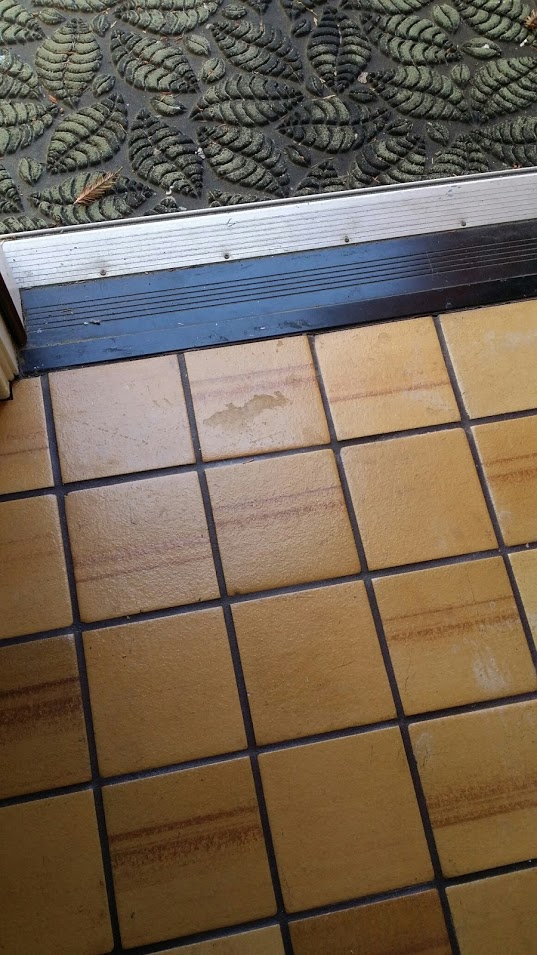

OK Tile experts what is going on here?
116,342
and how would you proceed?

By any chance is that a dye job?
I can't tell if the glaze has broken down or the color is coming off.
So what are you doing with it?

No. He had applied some sort of sealant over soiling, whenever. Well, somebody had. I know because he gave the elves a partially-used gallon!
We used stripper and superheated steam, as well as a CRB. Eventually it all evened out and looked dandy.

If money wasn't a factor, and your customer wanted it done, what would you charge and give us step by step and what it should look like at the end.

Do you see the dimples created from the no-move rug pad?
That there tells us that this project is a two day event.
