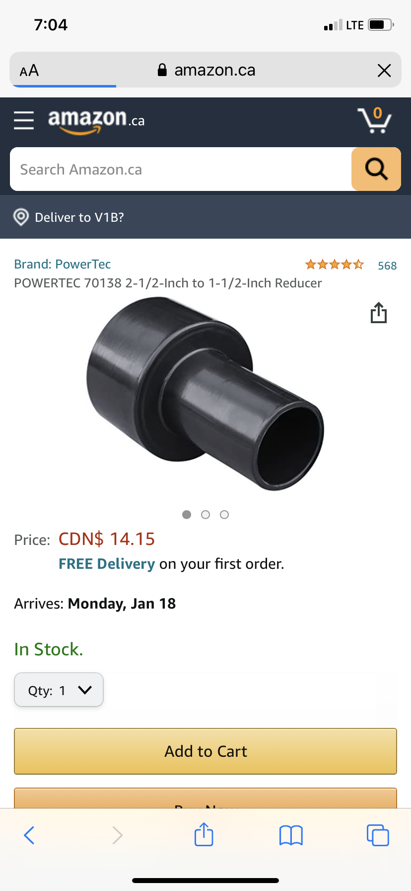

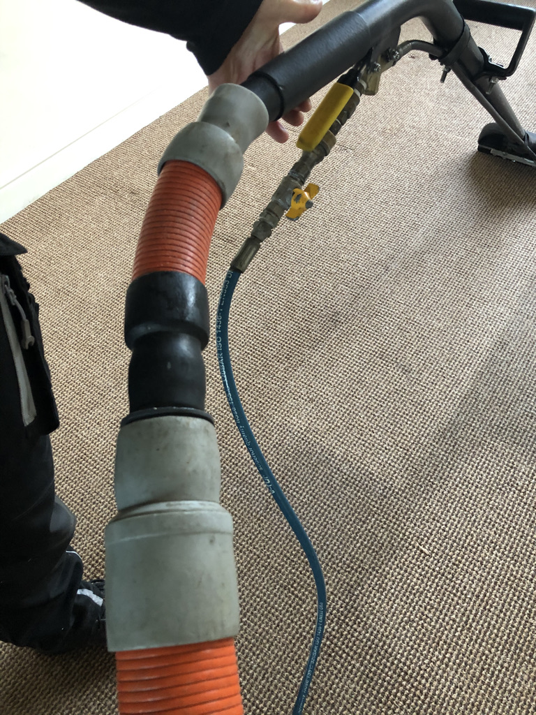

That's not a good idea. I don't know how long you've had it hooked up that way, but over time, that 1 1/2" hose will pinch. I know from experience
About 15 years so far , no problems. Its just a short whip that allows quick easy 1.5 tools to be connected, or pull it out and connect 2'' tools. Less restriction than a 10 ft whip.

2.5" from machine to about fifteen foot 2" to Vac Attack rigid reducer cuff on Mach 12. (Most often.)
