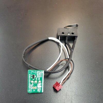

I'm not exactly sure what your part is or looks like, but is this it?

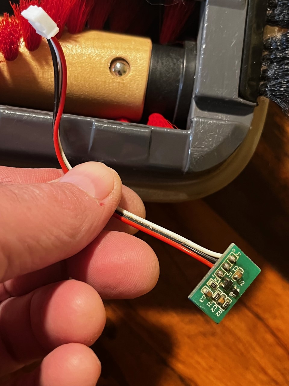

Here is a picture of my sensor along with the embedded magnet on the roller. It looks to be a different hall effect sensor and I cannot seem to locate it anywhere. I tried running the vacuum with the sensor removed, but still no luck. I was hoping I could solder the wires in a way to override the sensor altogether, but I am not tech savvy enough to know how to do that.

With a volt meter you should be able to figure out which wire you would need to short and overide the sensor.
Jan 21, 2008
790
Brad Gouveia
our you could try without I doubt you would fry anything. Use a paper clip and touch 2 of the contacts of the wires.

Just in case anyone else hits this problem cut the wires off the sensor and short out the red and the black wires leave the white disconnected.
No sensor now but works and with regular brushes.
