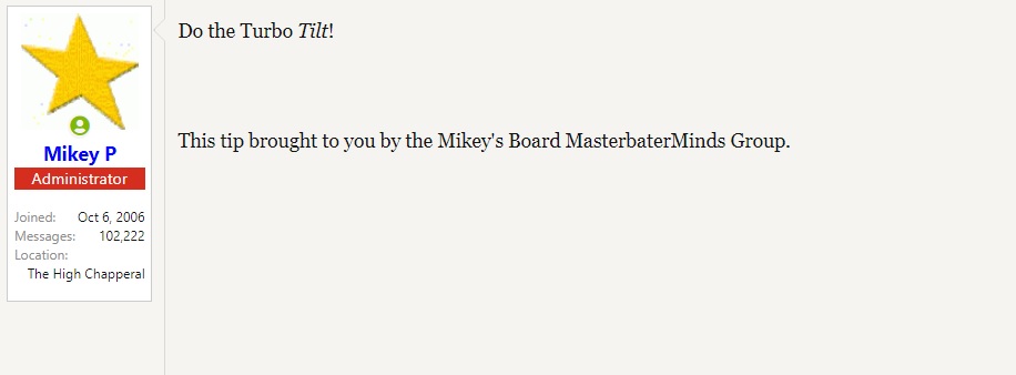

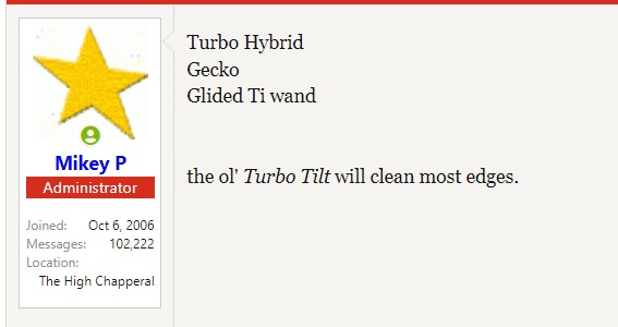

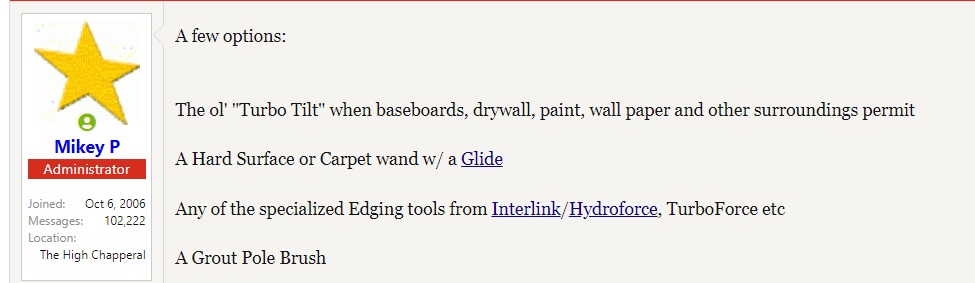

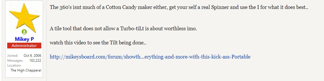

you deserve to be throat punched, ESPECIALLY you assholes that Turbo Tilt.
