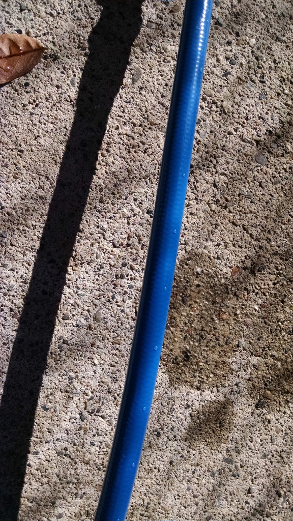

I ordered some from John, and mine did have some leaks, I ordered it with no ends, and I put my own ends on. I believe I didn't get them tight enough because the hose was leaking about 3 feet back from each end. I cut it off and redid the ends and no more problems but it looked like this.
Tiny little beads of water every 1" or 2 very evenly spaced, I didn't bother calling John about it, after the new ends fixed everything, I think it was letting water get between the inner core and the blue outter wrap.

I have a little video of it, and the end that was hooked to my TM was actually misting from the pin holes. So yes I think you just need to cut a bit off to be safe and re crimp with a little more CRIMP good in tight.

Not crazy heat I haven't even used it yet just put it on and flushing out the air and noticed about 15 pin holes.
If it leaks when it is brand new don't mess with it, just send it back.
