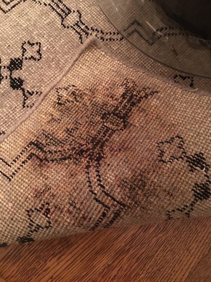

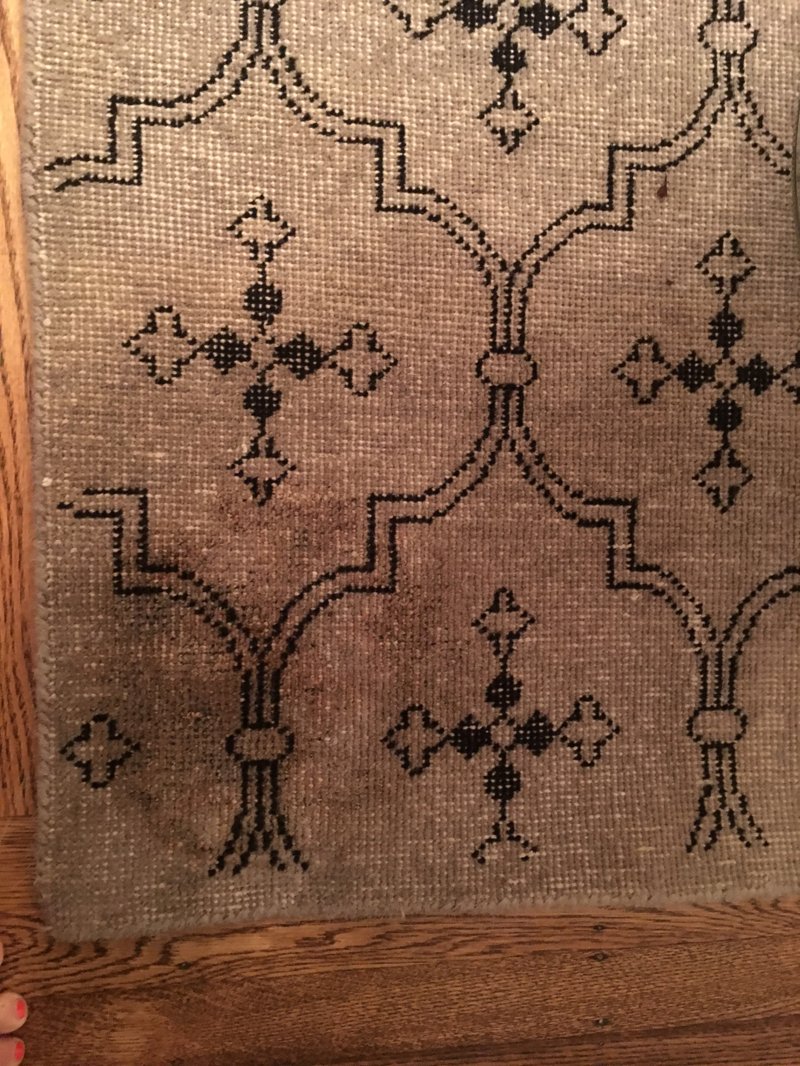

If a rug has planter caused mold/mildew on it. Not rotting but definitely some damage. Planter removed and will not be there again.
Is there an advantage in cleaning (as it may reveal more of the damage and fiber loss.) and also is it really necessary to remove it. Or is it better to spray with a products that stops the mold (which will it be in CA?) and just let it be?

How stable is it still? It looks pretty good from the picture.
If it would hold for a cleaning I'd clean both sides. You can always use the Sapphire tool and break the vacuum some. Spray with whatever disinfectants Cali allows.
If its not stable the you don't have much choice but to spray and run.

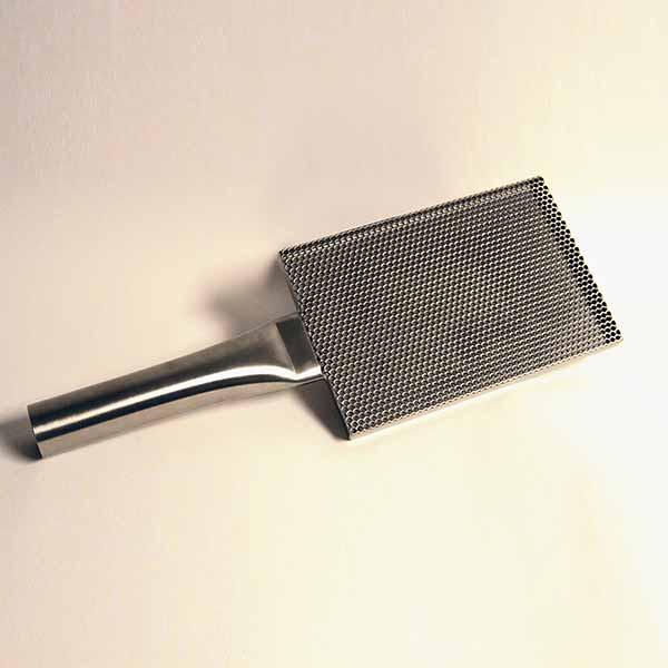

I like that tool Tom, could you send me a link to the thread in which it shows. I know there's a similar tool by PMF I wonder what are the dimensions and will yours work well for upholstery cleaning situation where the handle needs to be fairly short?
https://www.centrumforce.com/products/stainless-steel-rug-spotting-extraction-tool
Paddle is 6" X 9" and designed for rugs in mind as well as for upholstery: cushions and arm covers.
