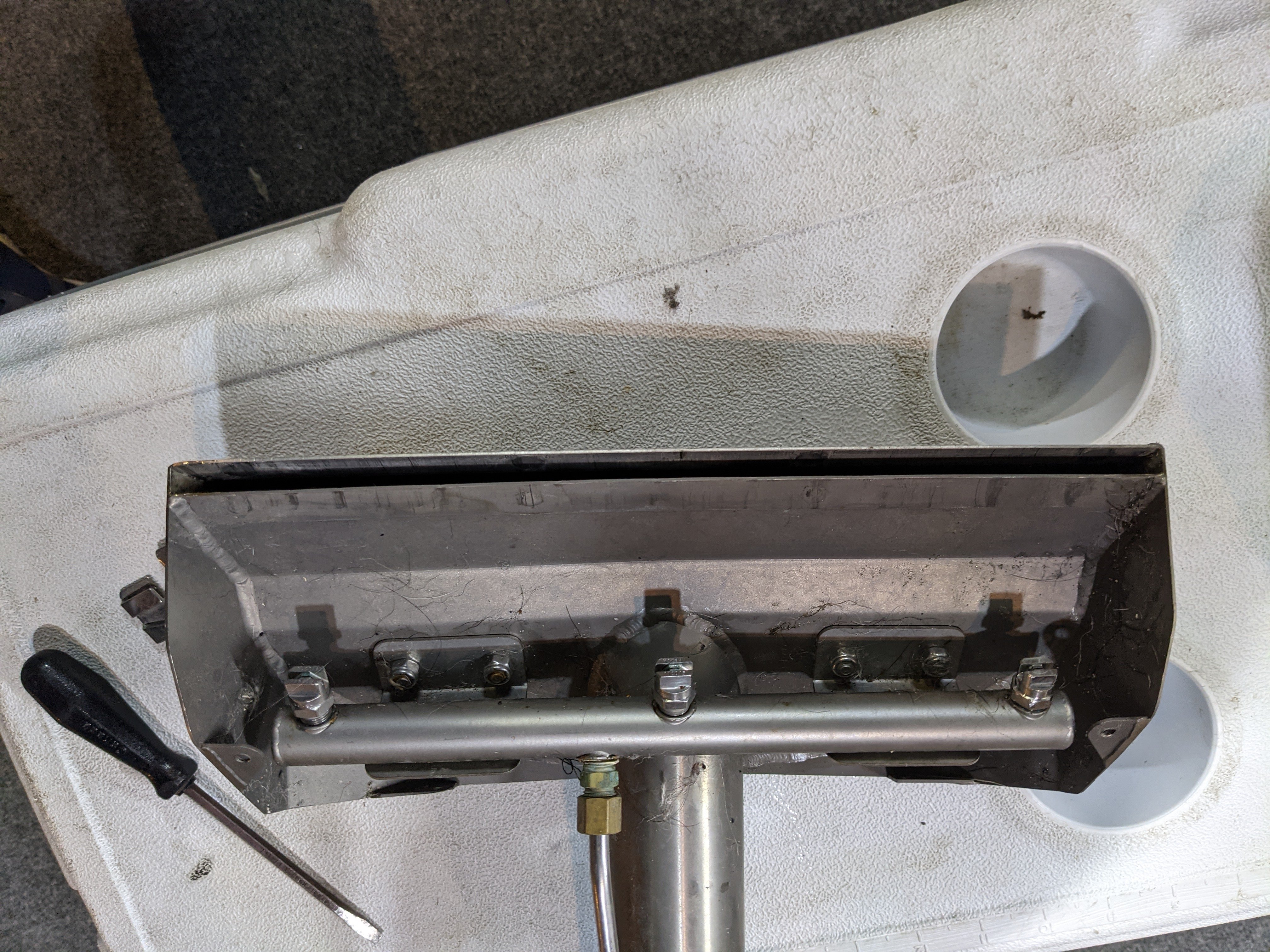

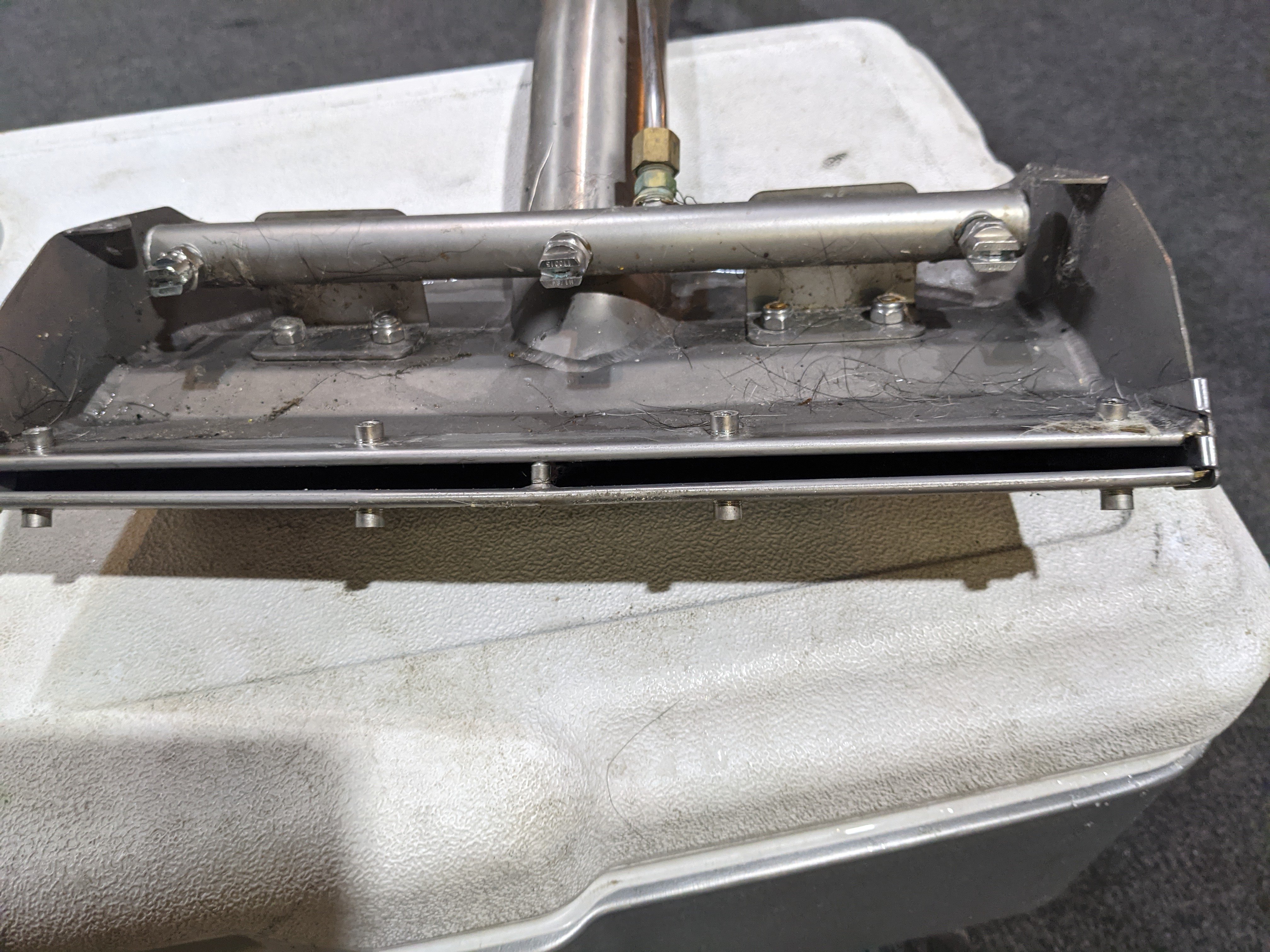

This is the current set up. Do the stainless glides have to come off?

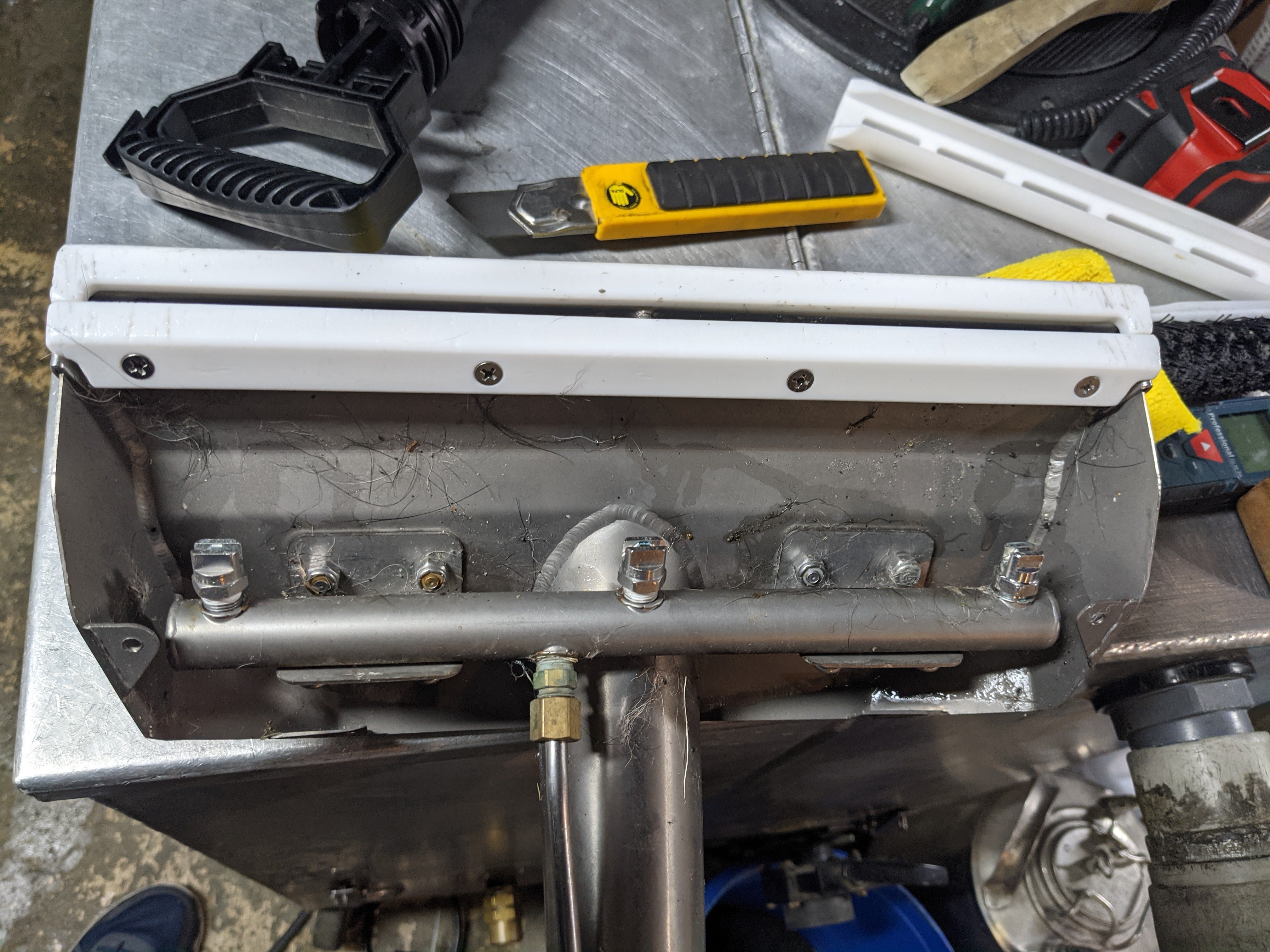

Never mind. I got them off. It will be nice to see the difference on this 2 inch titanium version of the Mach 12. The original glides are too flat causing extreme lock down with the Cleanco.

It's made by pmf for Cleanco. Has a bolt on heat shield. 3 jets only. I normally use a 6 flow with a 11002 in the center and 9502's on the sides. Very lightweight wand with great airflow.

The Green Glide for that wand is a very narrow round internal fit that everybody seems to love, except this one guy who doesn't pre-vacuum and he was obsessing on lint and hair getting caught up on the bridges..on his FIRST job...

I have a greenglide on my 2 inch westpak wand and it is a joy to use compared to this lighter titanium wand. Hoping the rounded greenglide makes the same difference.

is that manifold comes from pmf or do you customized for ur wand? i do really like to have one like that one on my wand!
That's how the wand came. Not sure why they use only 3 jets instead of 4. Probably a Cleanco thing. I also have a 1.5 inch Mach 12 with 4 jets direct from PMF. Both work well but I like the 3 jets better
