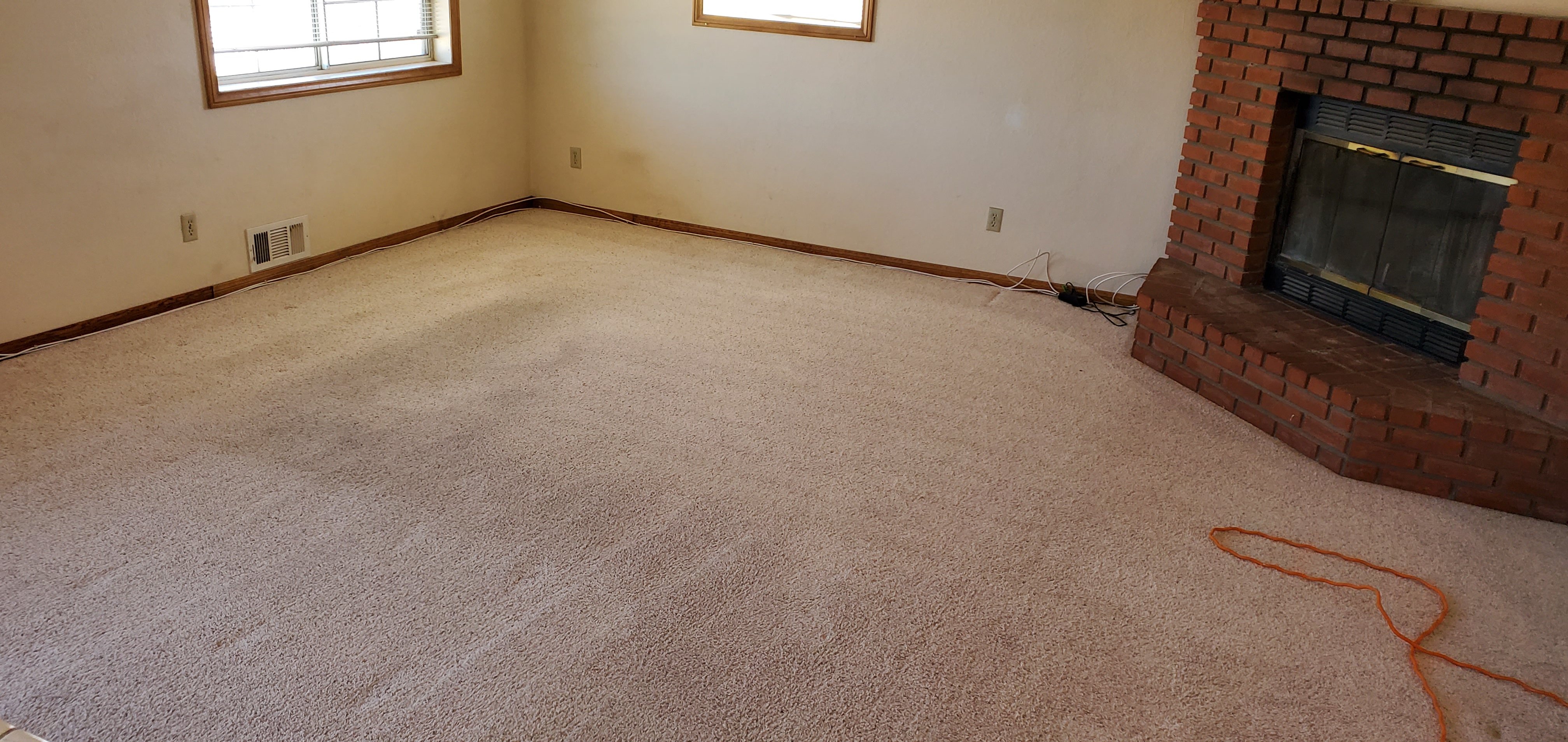

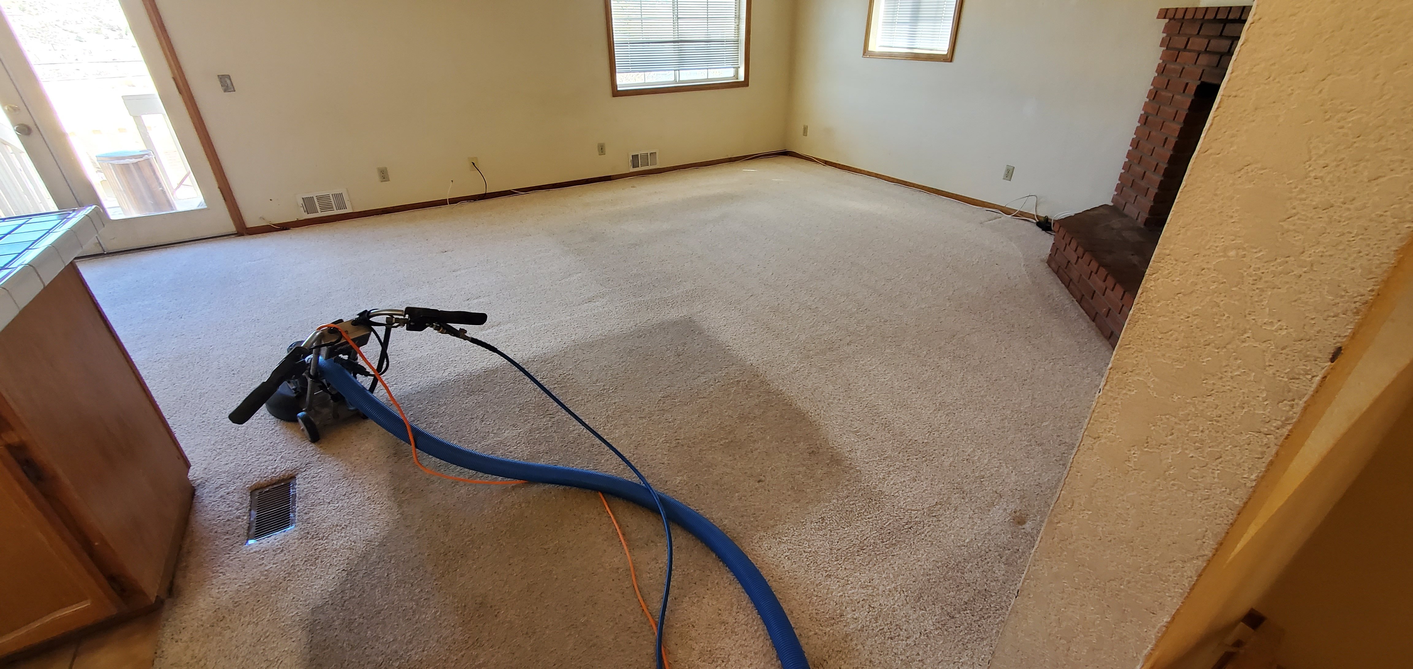

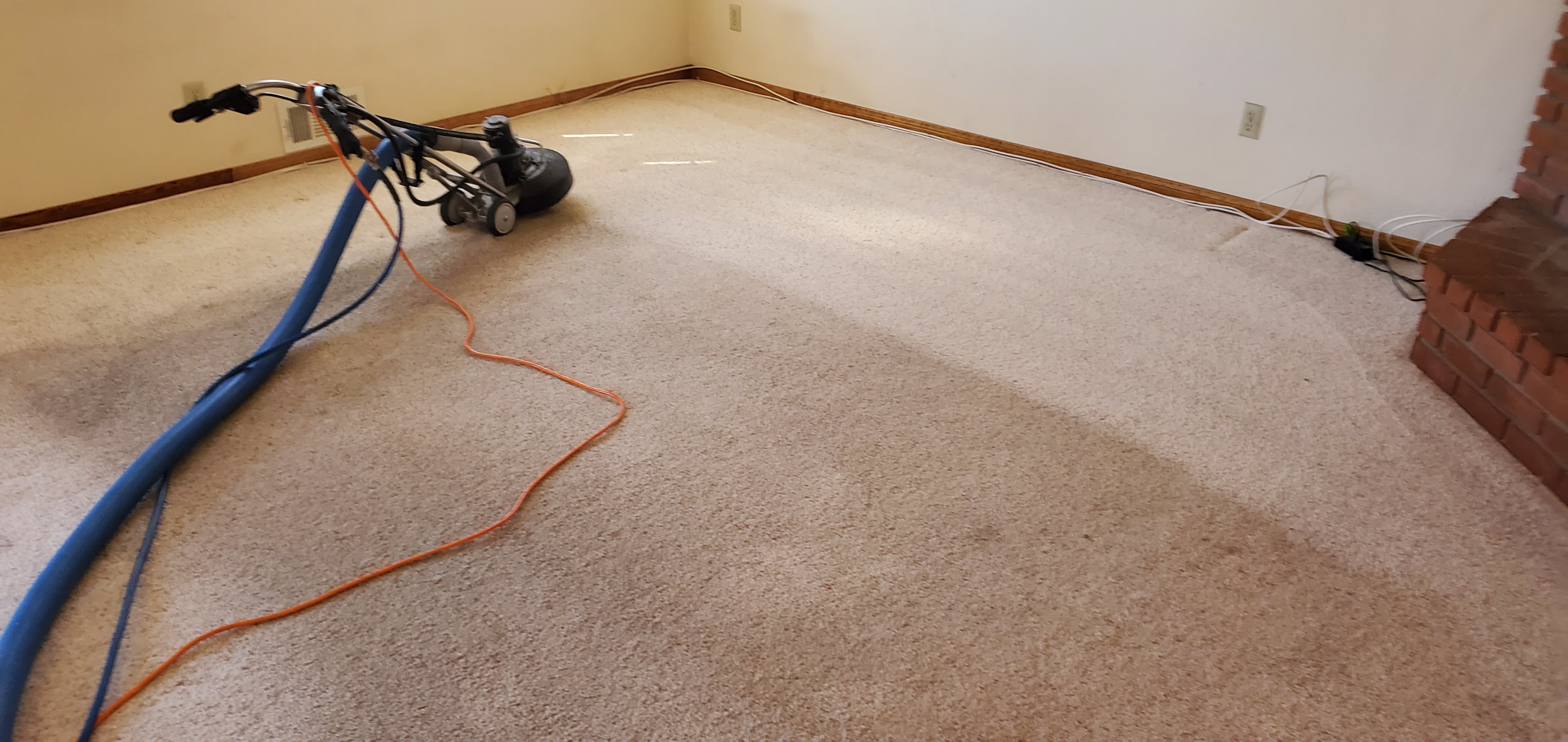

I’ve had polyester carpet give me a hard time in the past, tried to search my thread on here but no go. I cleaned some polyester today, only 3 years old, but had dark path ways in high traffic areas. (I did a acid & burn test and the customer found their paperwork and I was correct that it’s polyester.) I’m using Flex Powder, Rotovac 360i, standard 3 jet head, Apex full throttle and wide open. Sadly it’s better but still dark pathways:icon_rolleyes: Customer is fine with it. I just want better results. Any ideas to get the darkness out? Thanks....

Depends on whether the dark lanes are pile crush or soiling. If soiling you could try to up the ph with a spotter or ammonia based traffic lane cleaner. Poly is susceptible to pile crush, nothing you can do about that.

I believe it’s pile crush, the carpet is 3 years old, this was the first professional cleaning, hardly any soil came out. This home is new and immaculate. My external filter had only a little soil, hardly nothing.

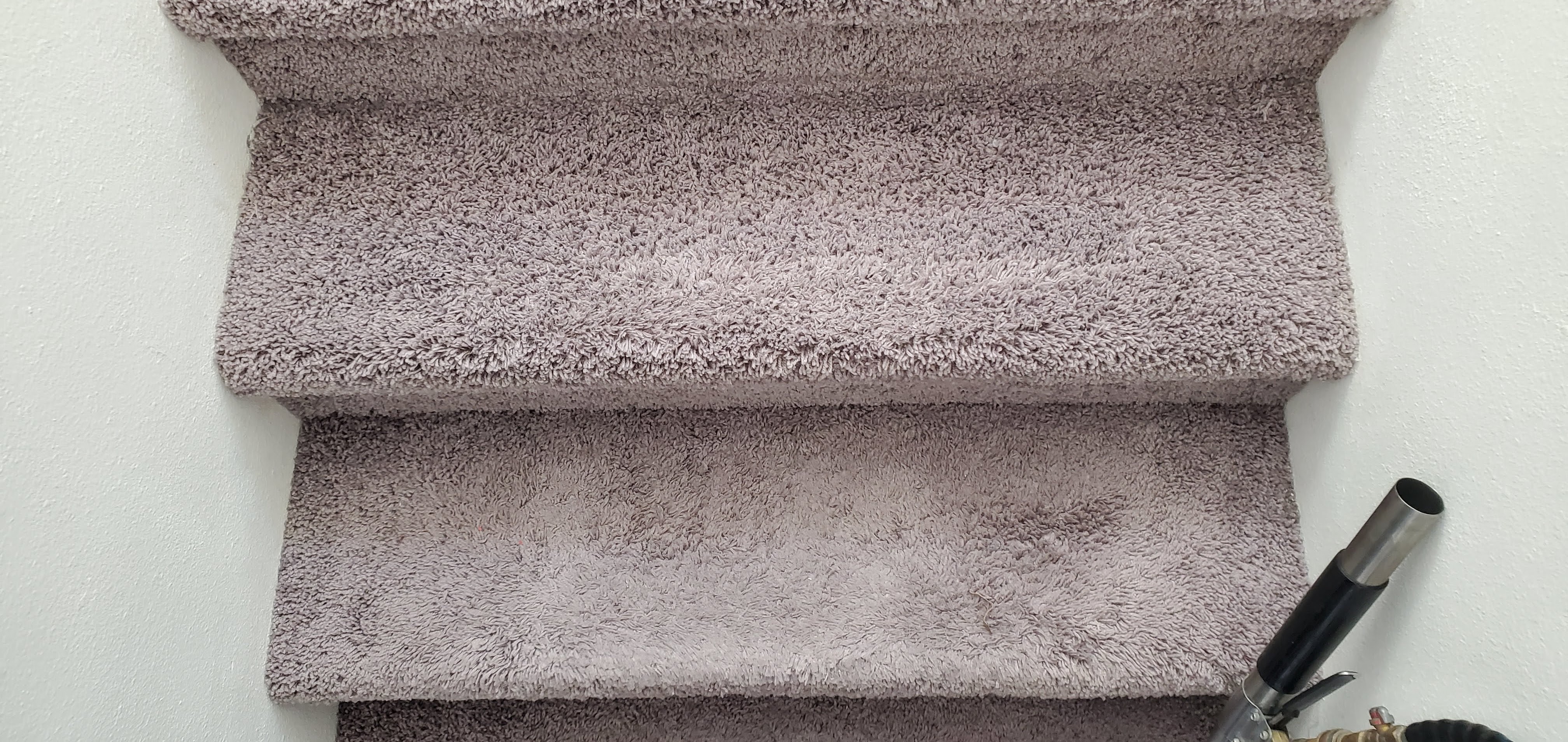

It's never perfect with polys
20220311_104404.jpg 20220311_091522.jpg 20220311_110845.jpg 20220311_105740.jpg
