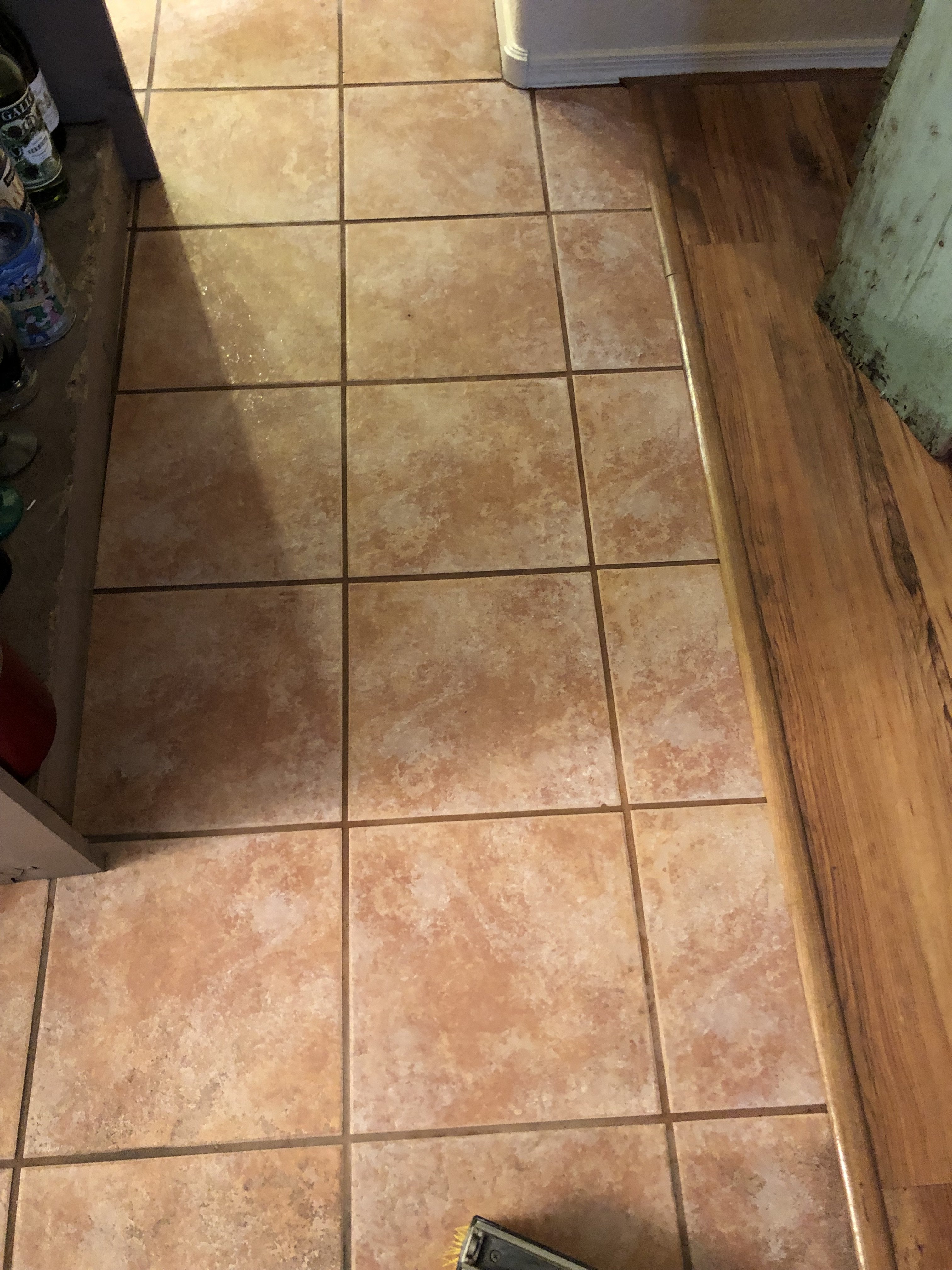

I have a question regarding the rinse phase of porcelain cleaning.
The manual says "Always run an all-fiber rinse through your truckmount when rinsing porcelain."
There are times I use a Trinity and the green tile brush to clean porcelain (or any tile).
Would you recommend putting the all-fiber rinse in the water I use to flush and shop vac the slurry with?

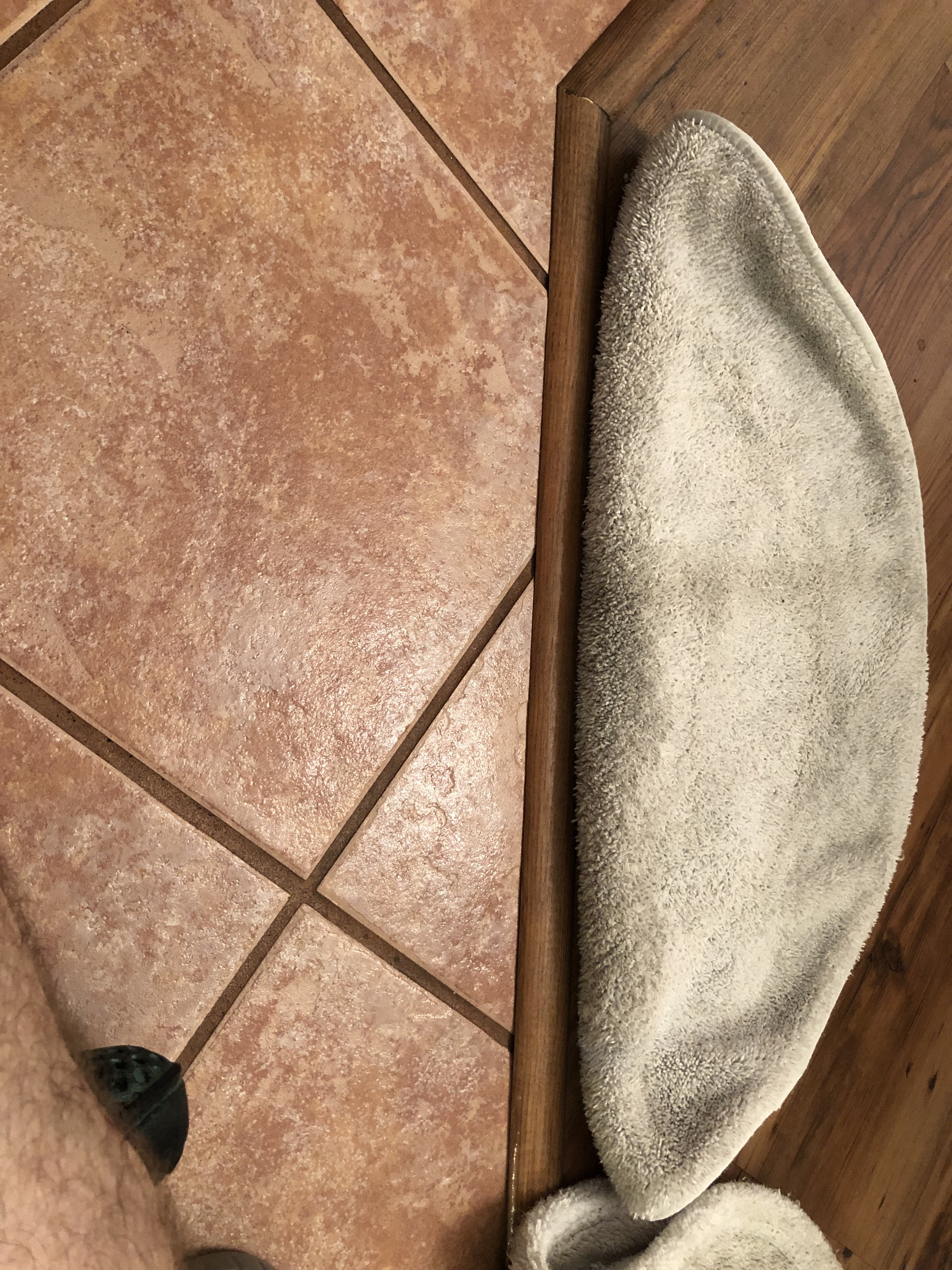

In the attached photo's is a job I did with the Trinity and an Oreck Orbiter because that laminated wood ran alongside the tile in every room.
They thought it looked good that way, go figure. I will not run a lot of water in that situation.
