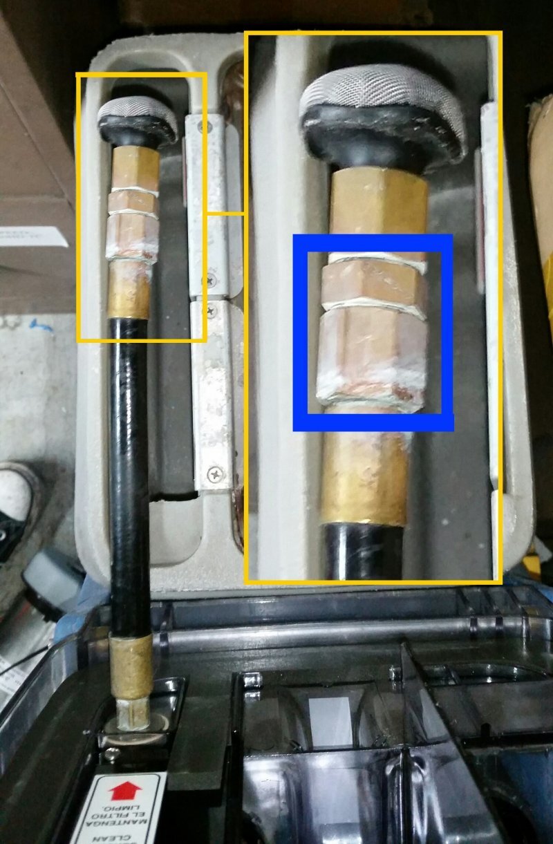

The check valve is new

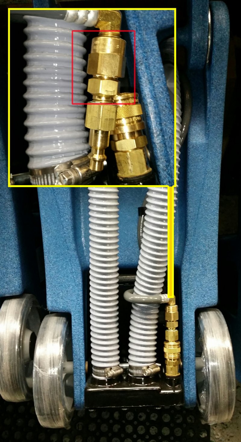

This is not new on mine
I don't have the valve in the blue box, has to be here, everything else seems fine

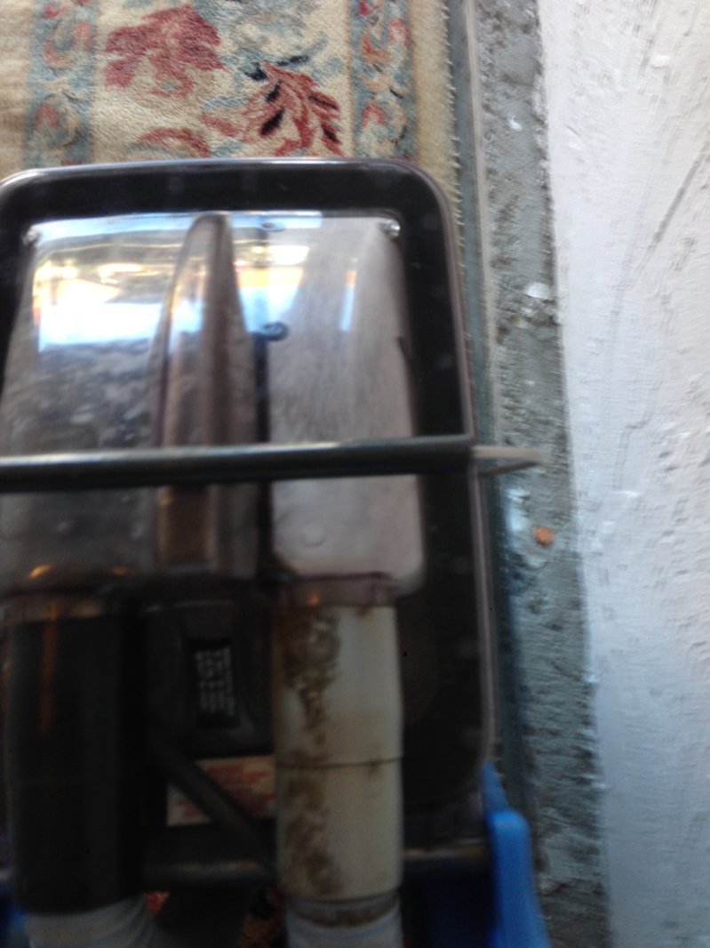

It's great suction, it lifted the carpet off the floor, the dome is not showing the waste water at much volume to another unit I have it's a new pump, I'm sure it's the feed hoses, there crap 1997.

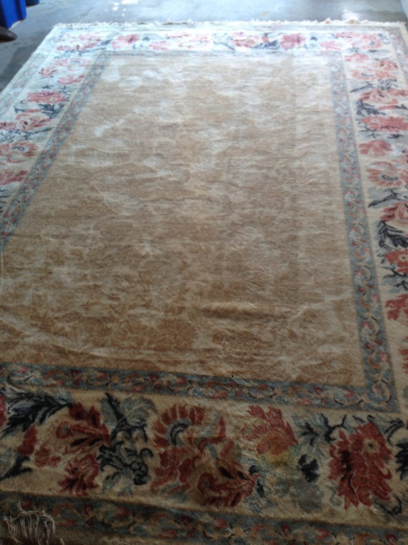

Seems to be working better without doing anything ?
Maby the filter loosened it self up

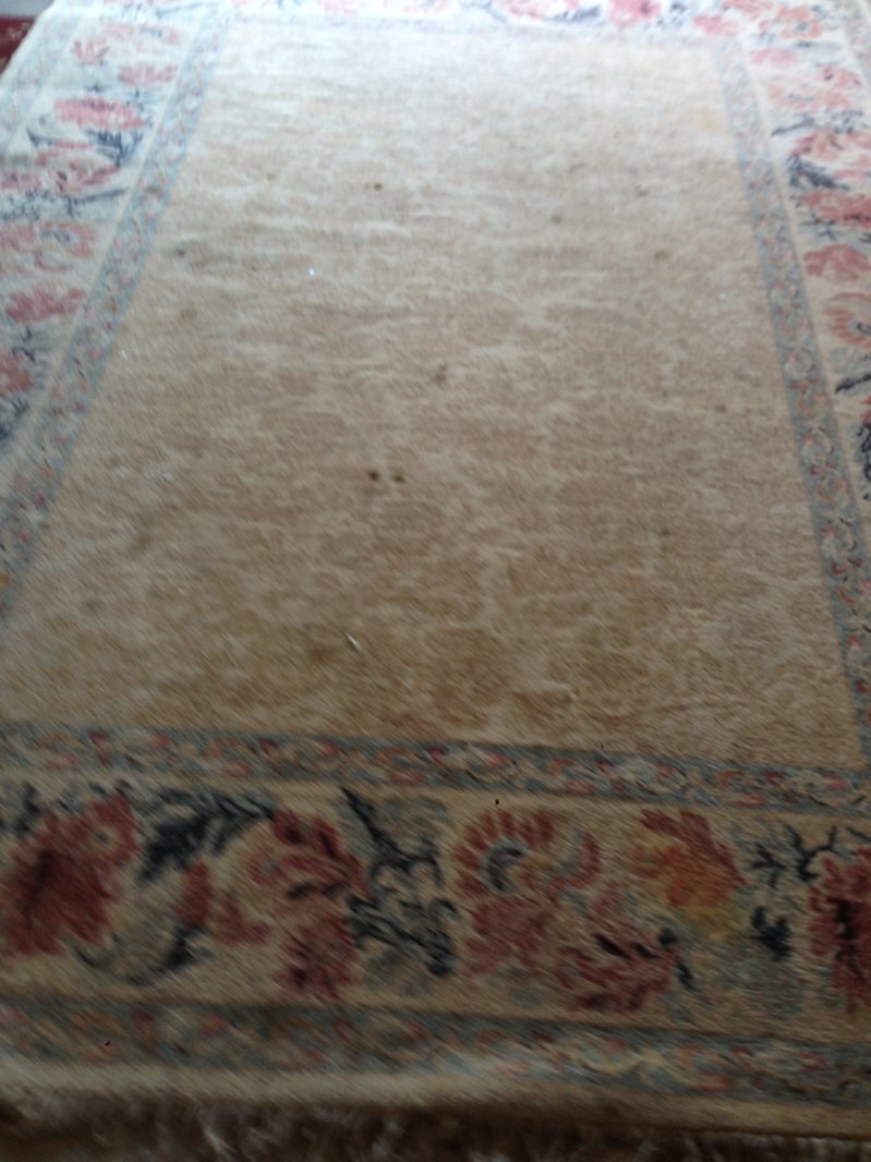

Here is a before and after

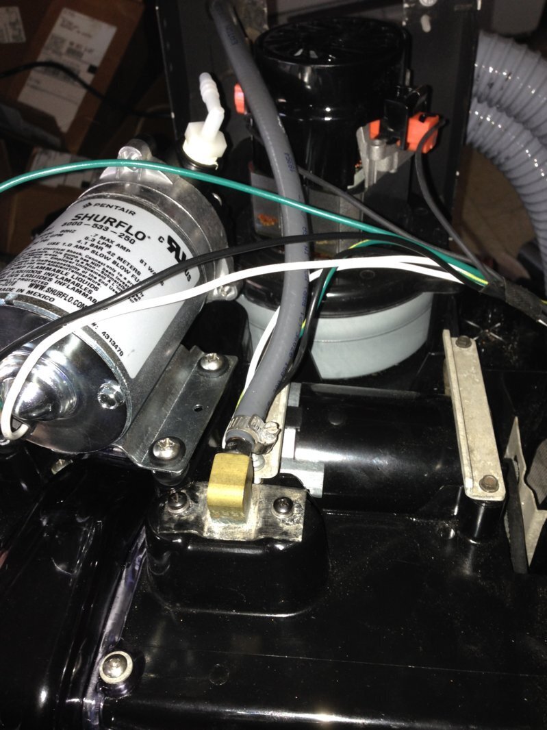

Has a leak, I can hear it drip drip drip but don't see it ???
Can't catch a break
