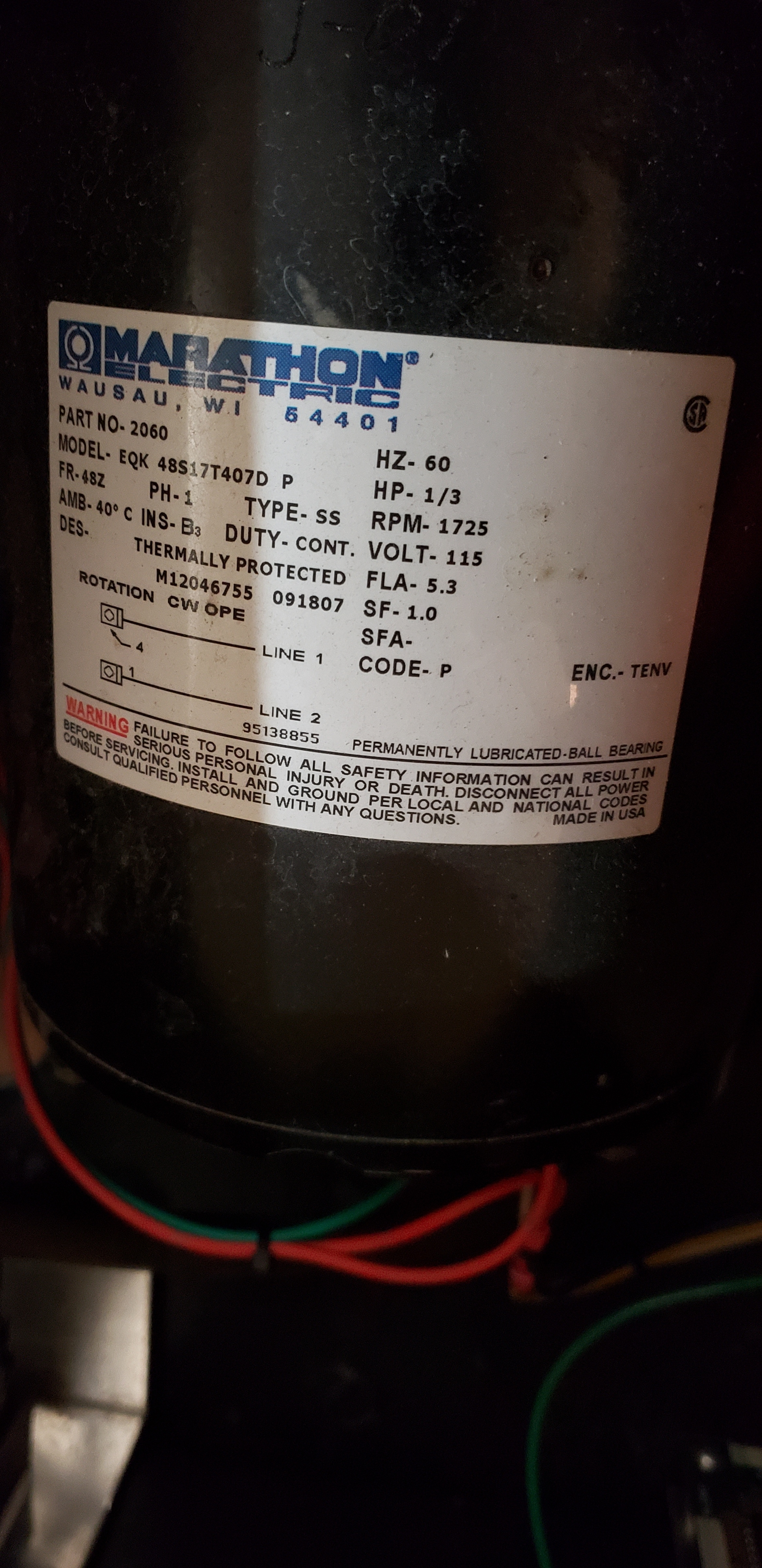

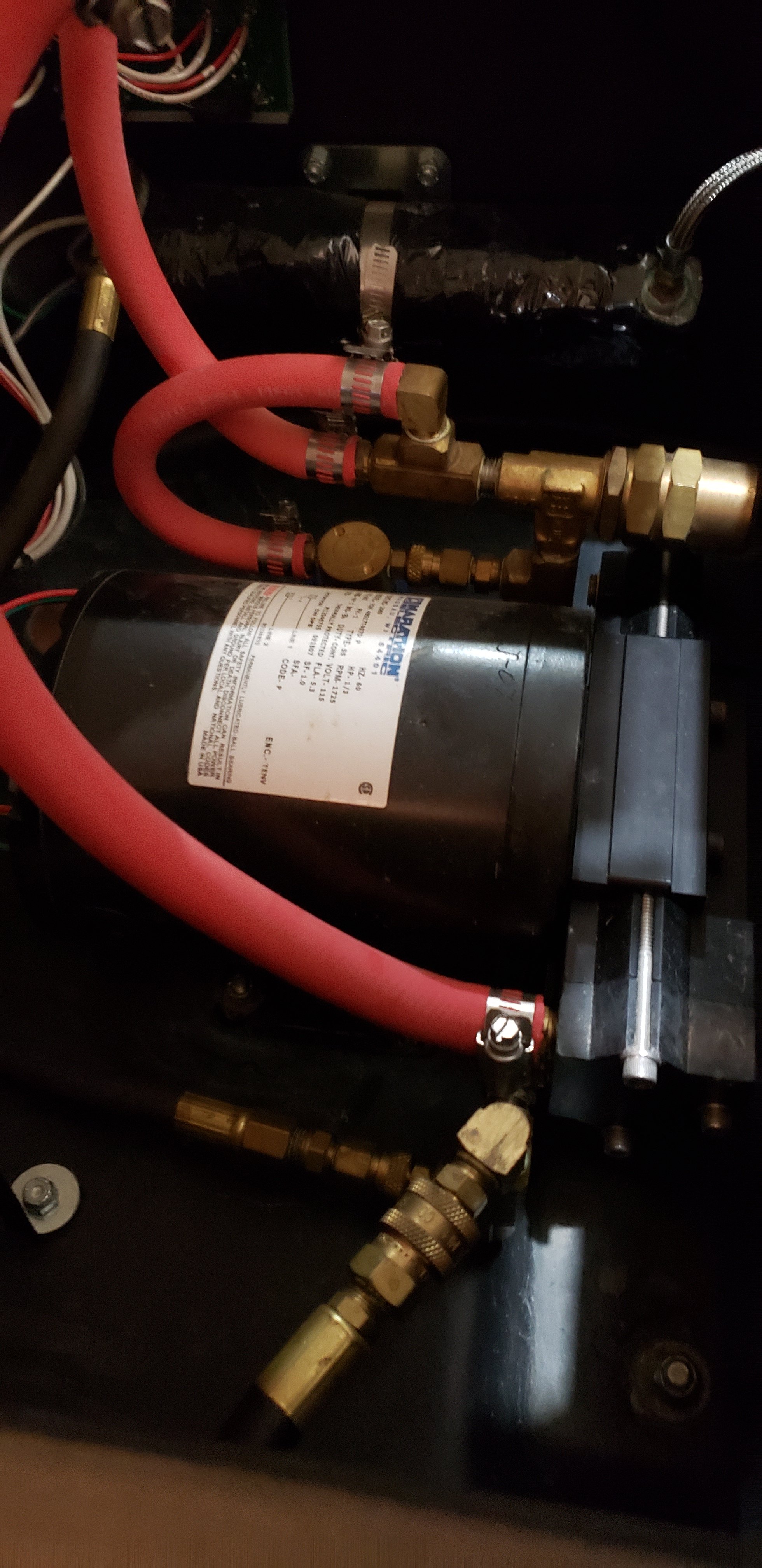

My US Products Solus 310's pump is getting bad and seems to be loosing pressure. Should I rebuild it, replace it with then original or try and find some aftermarket pump? Any links to suggested pumps appreciated.

What kind of pump is it?

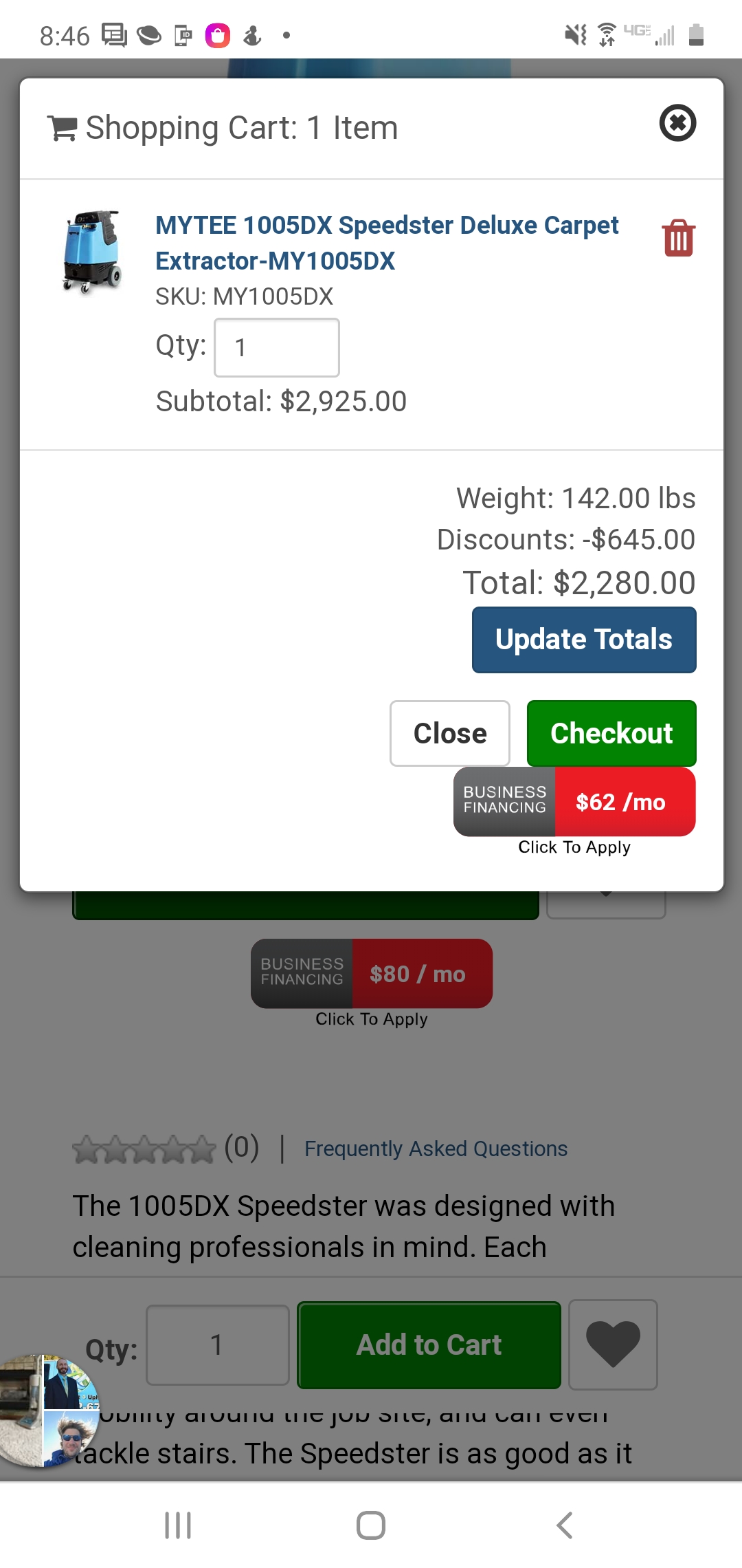

It's hard to find one machine to do everything well. If you're doing a lot of tile, consider the rotovac ranger 1200 psi. You will have 3 power cords and need somewhere for the apo to go. Otherwise I would recommend a tile specific machine with 2-2stage vac motors and something with 2-3stage vac motors in parallel and 500 psi like the Mytee speedster. Don't buy a heated portable. Tile cleaning really needs a large capacity machine or an apo. I am using an old ninja with a 1200 psi pump mounted on top. Works great except for having to dump every 5 minutes.
28,256
It's a good machine but I think that may be an older model. Check out the 1005lx. More vac power, same size. These are heavy machines designed for buildings with elevators. Need 1 20 amp circuit and 1 15 amp circuit. Powerful, easy to use machine.
