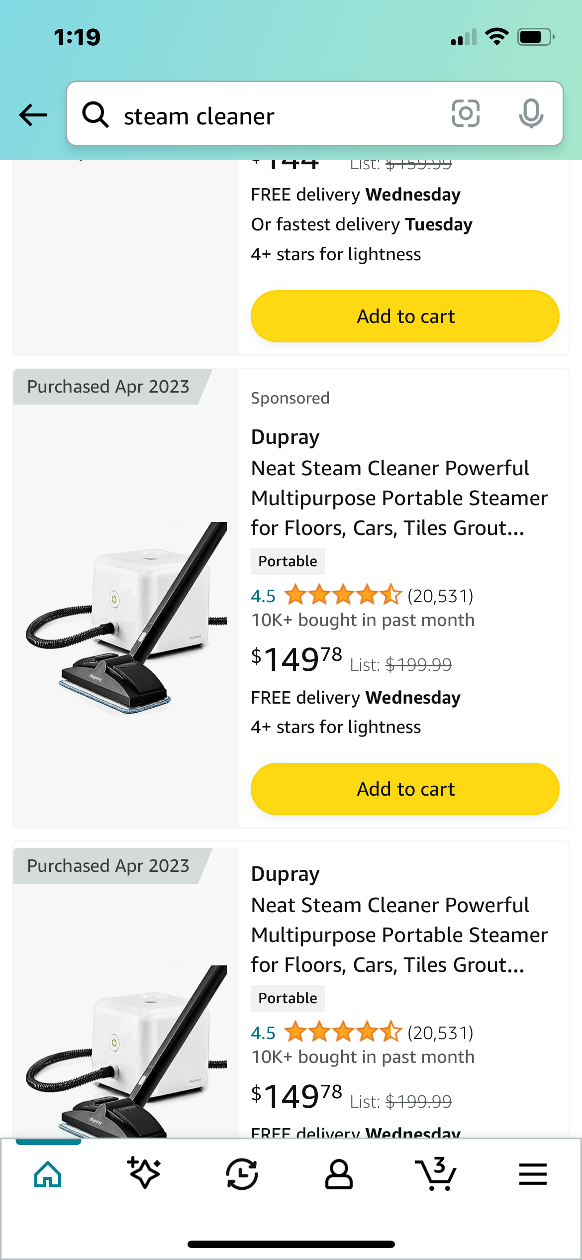

It’s almost always a good investment to start out with a TM if you can swing it, but if you have to start small then go with the standard 500 psi portable and pick up a small steam machine to help with grout.
The flat mop head shown in the picture is worthless but it comes with a good grout tool.
