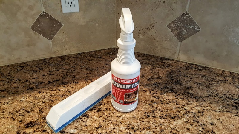

a lot of the high dollar sealers are a real pita to remove the excess once the stone is saturated. lots of buffing and cussing..
Not this stuff.

Top performer and easy to use., what more could you want?

Stone pro makes some great products. I really like their impregnating sealer. Performs very well and easy to apply. Would like to try Cobb's sealer to compare but not sure if I can get it up in Canada .

Don't get a lot of stone jobs but use on ceramic floors or other man made tile. Light mist on entire floor, squeegee into grout lines, microfibre mop and boom. Haven't had a complaint about the odour either.

I've using that stuff for over 10 years now. But I still have to mist with Finishing Touch and dry buff with a microfiber or lambswool on the Makita after applying the sealer.
