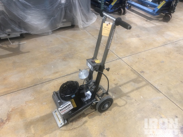

we rented a floor scrapper too.
it was still a b1tch

Taking up sheet floor sucks bananas. It might been easier with a floor scraper, not a scrapper.
