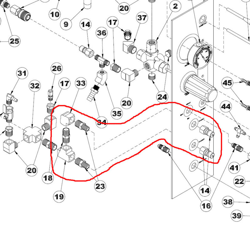

Interesting. According to the manual the two solution outlets are simply teed together:
