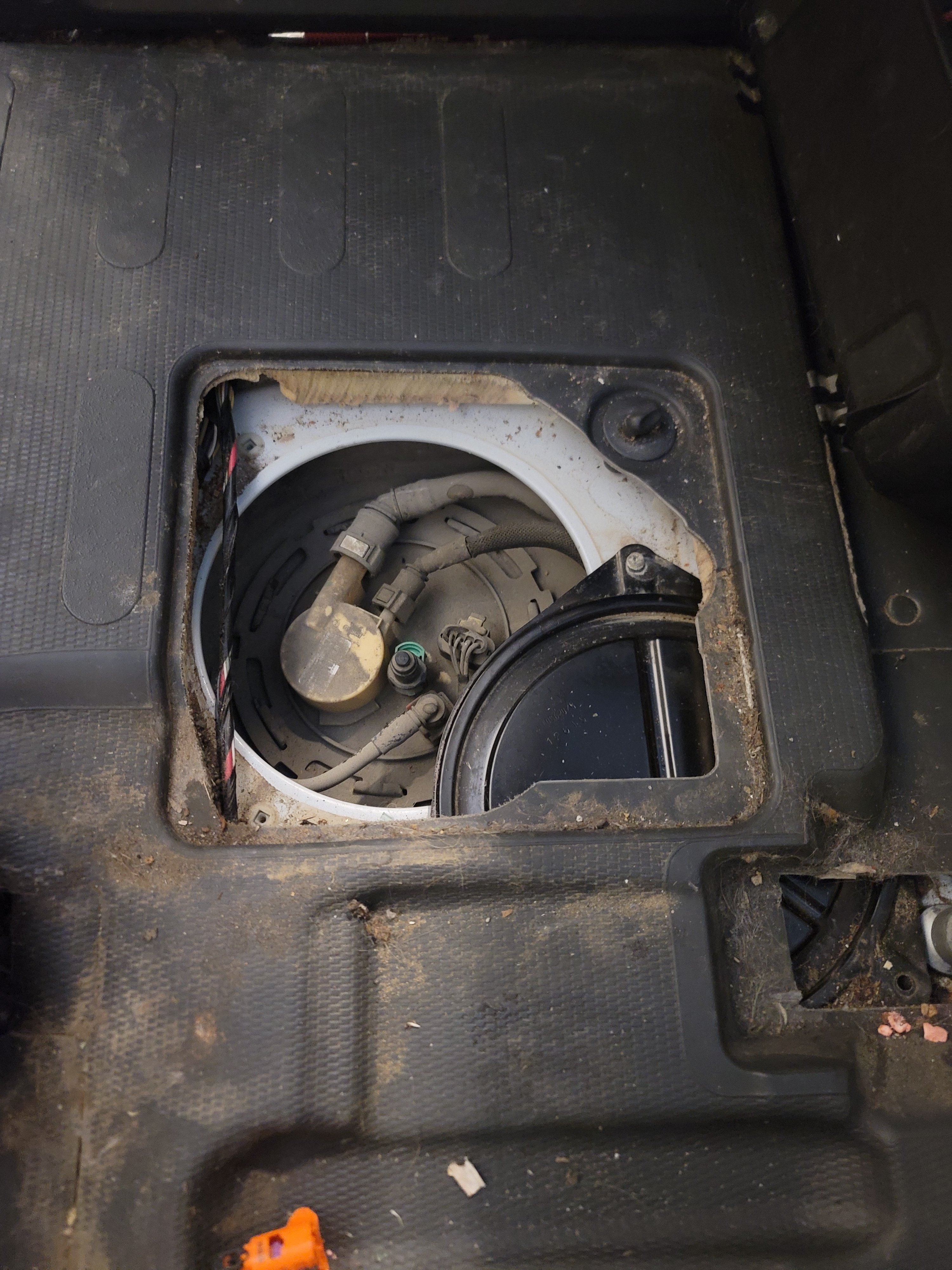

I'm working on installing my Everest in my Promaster. The Promaster has a spare fuel tap under the driver's seat which is pretty sweet. Should I just route my gas line under my van and drill a hole with a rubber grommet through the floor to route it up to my machine?
I'm also trying to keep as much space from the partition as possible, while still allowing room to access my dump valve.
If anyone has any suggestions or wishes they would have done something different I'd be glad to have your input.
I have every intention of putting a bed liner down this Spring, but no one was available in my time frame and schedule to do it this Fall. The nearest shop is 65 miles away.
I wrote this while laying under van taking a break. 20221113_140035.jpg20221113_141127.jpg

Is the Everest carbureted or fuel injected? If fuel injected, you need to run a return line back to the tank.
She's the good old carbureted. It's a real nice machine and I'm really excited to have it. I ended up drilling through the floor. It seemed like the most logical thing to do. I should have it running tomorrow if I can get time to work on it.
