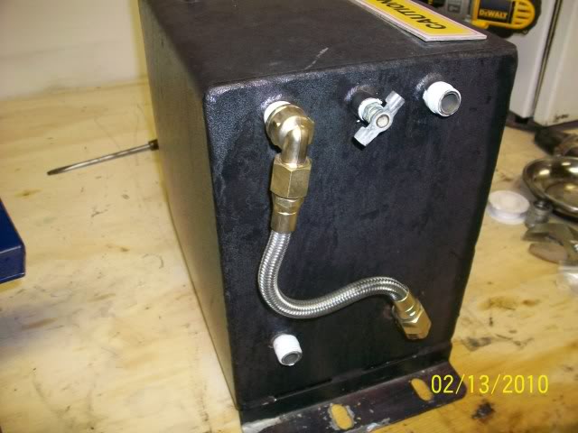

that Butler i had was ALL AN line..
heres the HX
18,851
