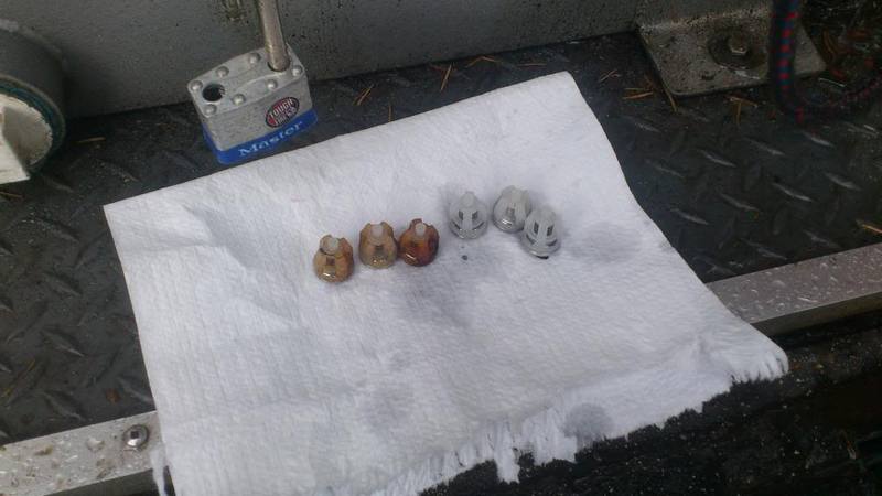

went to open it up this morning and the heads were pretty tight so I took it into a pressure washer mech I know, I didn't want to break anything
Got the heads off, all the check valves were intact, dirty, but intact and functional. The high pressure check valves are dirty but he wasn't concerned about it.
what it turned out to be was a double O-ring on one of the valves, at least that's the theory. We found a broken O-ring stuck in one valve and when we pulled the O-rings, the remainder was stuck to the other O-ring. We figured it was doubled by mistake at the factory and surprised its lasted 2200hrs.
Put everything back together and its all working fine though he's unsure about the unloader, says it may need replacing down the road.
