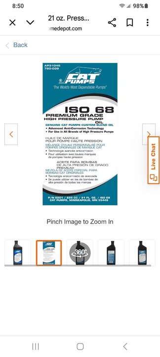

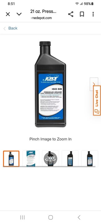

I would use pump oil. Transmission oit takes heat and punishment and lasts 25k+ but would you put that in your engine? I don't know if one brand of pump oil is different than any other but i know there different than motor oil. I run Hypro pumps they say use Hypro pump oil. I use Cat pump oil instead because I can get it at home depot. I also run Cat oil in my Comet wastepump Unless the pump specifically says use automotive oil( i believe Hydracell recommends 30w non detergent) i would steer clear. If your car says use 0-20w and you want to get the most outa it i wouldn't put 15-40w in instead. And if you want the most outa your pump i would put in oil specifically designed for pumps.
View attachment 132728 View attachment 132729

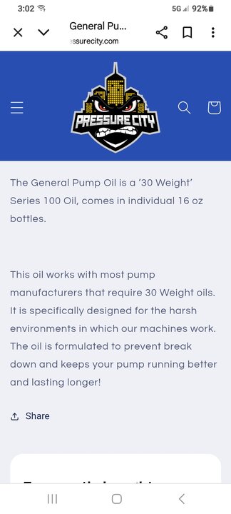

Thats good that the oil still looks new, it should. General pump series 100 oil is 30w ( im almost positive non detergent) so if you were to substitute a automobile or different oil it would be 30w non detergent. Or air compressor oil (also 30w non detergent)
