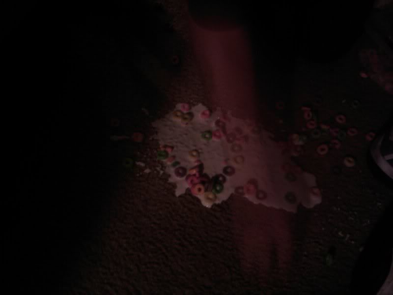

as far as protectant working, a carpet I've cleaned and protected once every year over the past 11, spilled cereal and milk, you can see how the milk is still beaded up. When I took the picture it had been sitting there for at least a couple minutes. Its a very high traffic area and hadnt been cleaned in year.
Protectant seems to be working.
