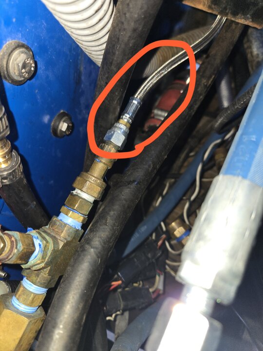

I'm not sure what to make of it. This line in the picture is hot, so it seems there is a lot of water flowing through it back to the water box. I don't think there is a thermal relief valve on that cluster of fittings.
The thermal relief valve by the pressure regulator, that hose going to the waste tank from it is cool. Seems like nothing is flowing through it. So why would too much water be flowing through this relief going back to the water box? It is the cluster of fittings behind my solution line outlet off the machine. It T's and one side goes to the solution line outlet, and the other side goes through that small diameter pressure line to the bottom of the water box...
