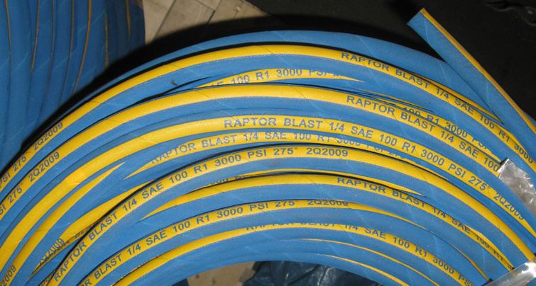

Just a note to our TM hose customers...
that the Raptorblast 275° F hi-temp hose has finally arrived.
Thanks for your patience,
Larry

Greenie;
We sell lots of the Parker 235° rated hose.
But we do have some "high heat" customers who can only use wire-braid,
and prefer the temp rating of 275° or higher.
They use larger pumps than the Vortex, so high flow is a given.
Larry

Greenie;
They are using multiple hoses for more than one tool.
I think that is a good way to run the large TM's.
Also, the point of using wire braid,
is eliminate tube damage on the blue Parker hose.
Larry

Larry Cobb
5,795
Dallas, Texas USA
Larry Cobb
Larry C.;
This RaptorBlast hose was used to prevent the "neptune" hose failures.
The inner tube is much more resistant to carpet cleaning chemicals.
Larry
