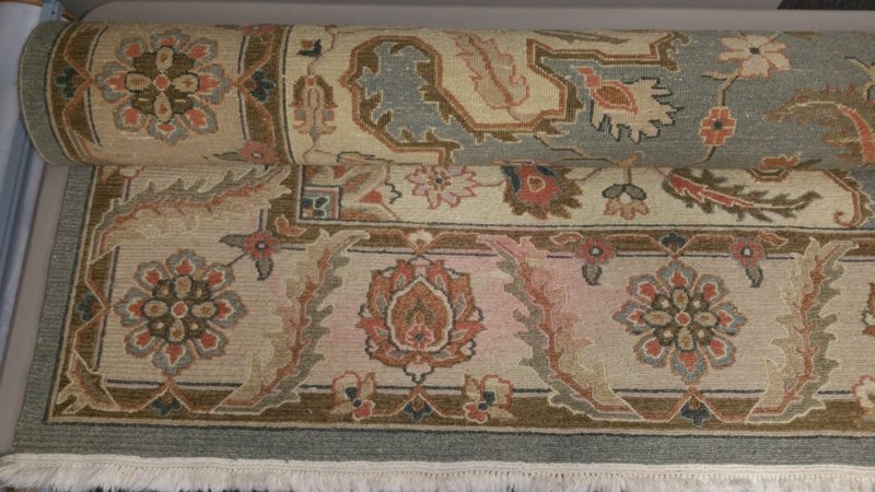

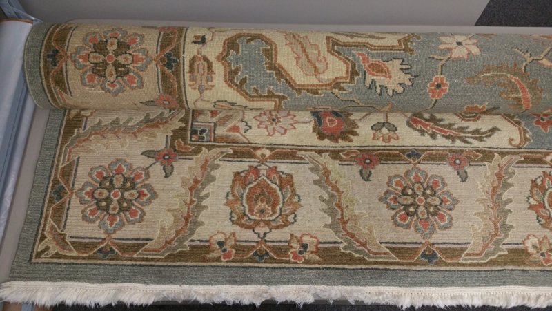

Pretty pleased with how this red stain removal turned out. This was on a newer wool on cotton, Indo Soumak rug. Probably a Nourison, Nouromak.

those products can still remove color weeks later well after being dry. I'm not saying it would happen in this case since this can be pit rinsed. I'm always a little nervous when using them on natural fabrics.
27,881
Some of these products are not intended for natural fibres but sometimes it is a last resort. I recently had a tufted wool rug that had red cotton threads anchoring some of the patterns. When I cleaned it the red bled all over the rug. I couldn't do anything as it would continue bleeding so I mixed up some part a/b eliminate and sprayed the rug twice. All the red disappeared like magic with no visible harm to the carpet. The mix reverts to just water apparently. It's not approved for wool but so far, no harm, no foul
