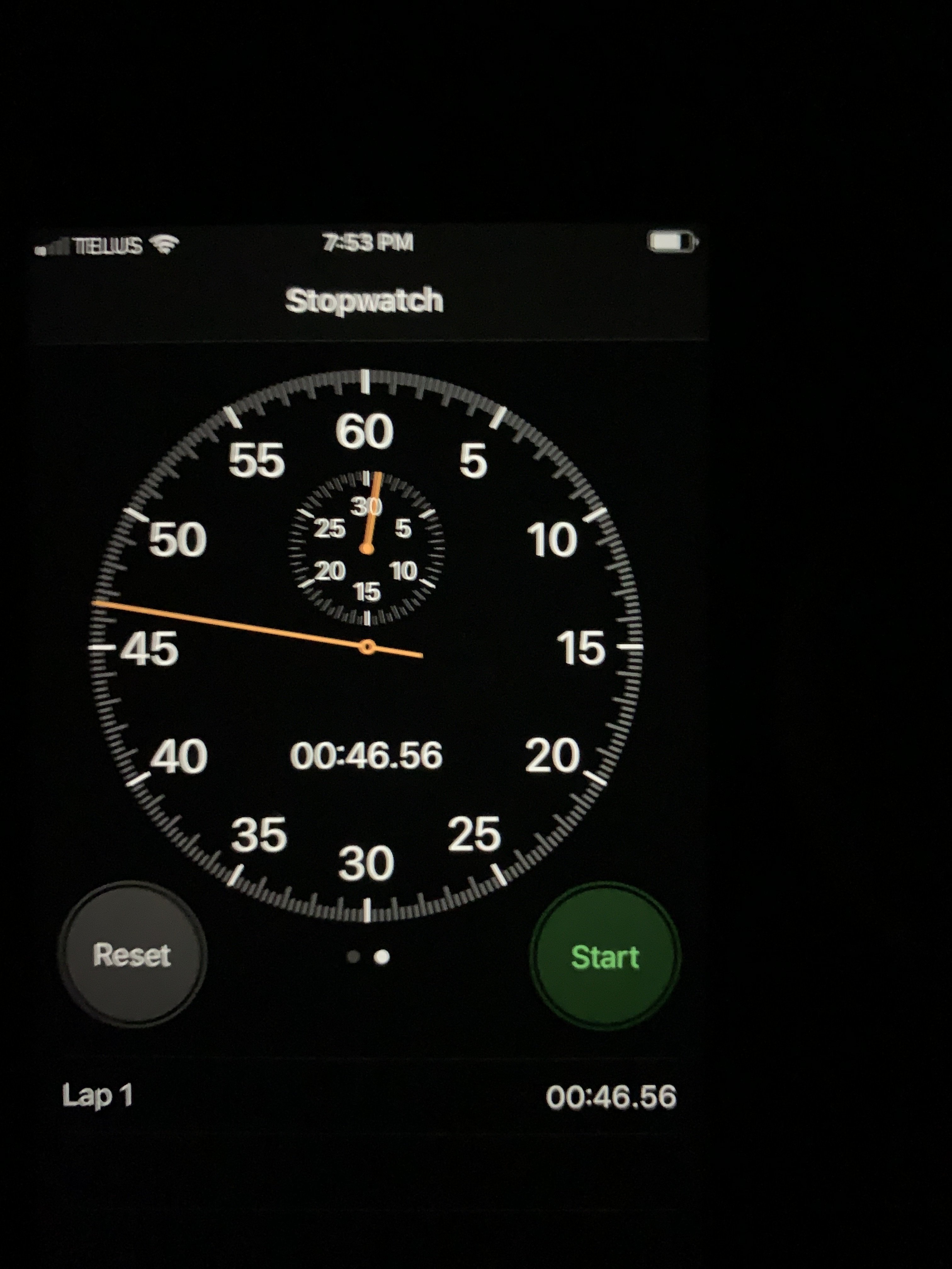

I know you were doing it one handed, but there’s a safer method that I like to do by folding the rag and preheating the rag with the iron before putting it on the stain, and when you put the hot side of the rag on the stain, it acts immediately when applied with the iron on top of that, causing the stain to go away in a shorter, safer period of time.
Like and Subscribe
6,564
Yup, 48 seconds is long enough to melt some types of carpet....

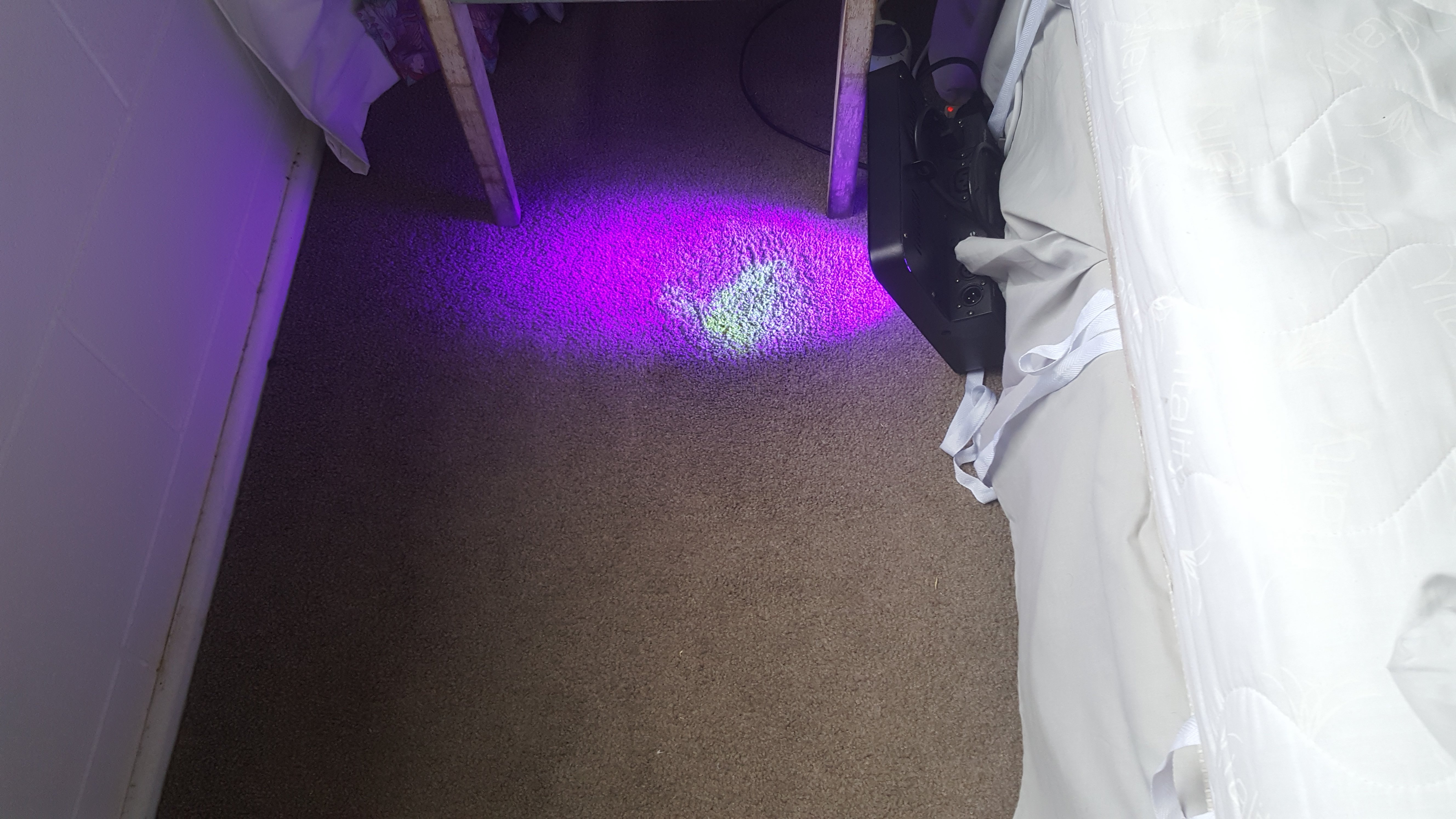

UV spotlight is only way I've pulled turmeric, you better have whole house to clean though cos it takes awhile
