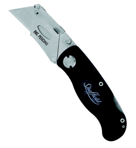

You can either use a pocket knife or the fein multimaster tool there are some grout removing tools around they all come in different sizes thinner the better for marble just take your time do not slip and a wet and dry vac to suck out grout dust, after you have done this you may want to clean out the joints I use a damp rag around my carpet knife and clean as I go than you are ready to re grout. Hope this helps unsanded grout is very easy to remove with a pocket knife and sharp blades. Take as much out as you can all the way is best IMO.
Mickey there are some finer sanded grouts they are using these days as not to scratch the tile during re grouting they hold up better for maint and color sealing, acrylic added does help but not that important really.
Craig
116,338
When you say pocket knife you mean this?
