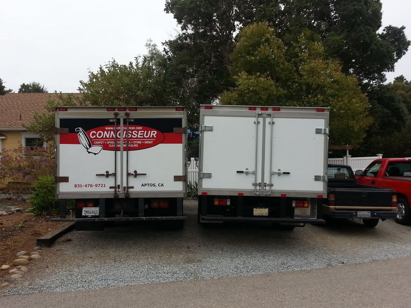

116,344
How are you going to letter it?
can you stay on topic please..
Im thinking of re wrapping both at the same time...
Shall we have a contest here?

I wazzz just wondering what you were going to do, but yes start another thread explaining your plan for the new and the old trucks. Are doing the new to match the old. Both with a new design or one old one new?
Inquiring minds want to know! :p
