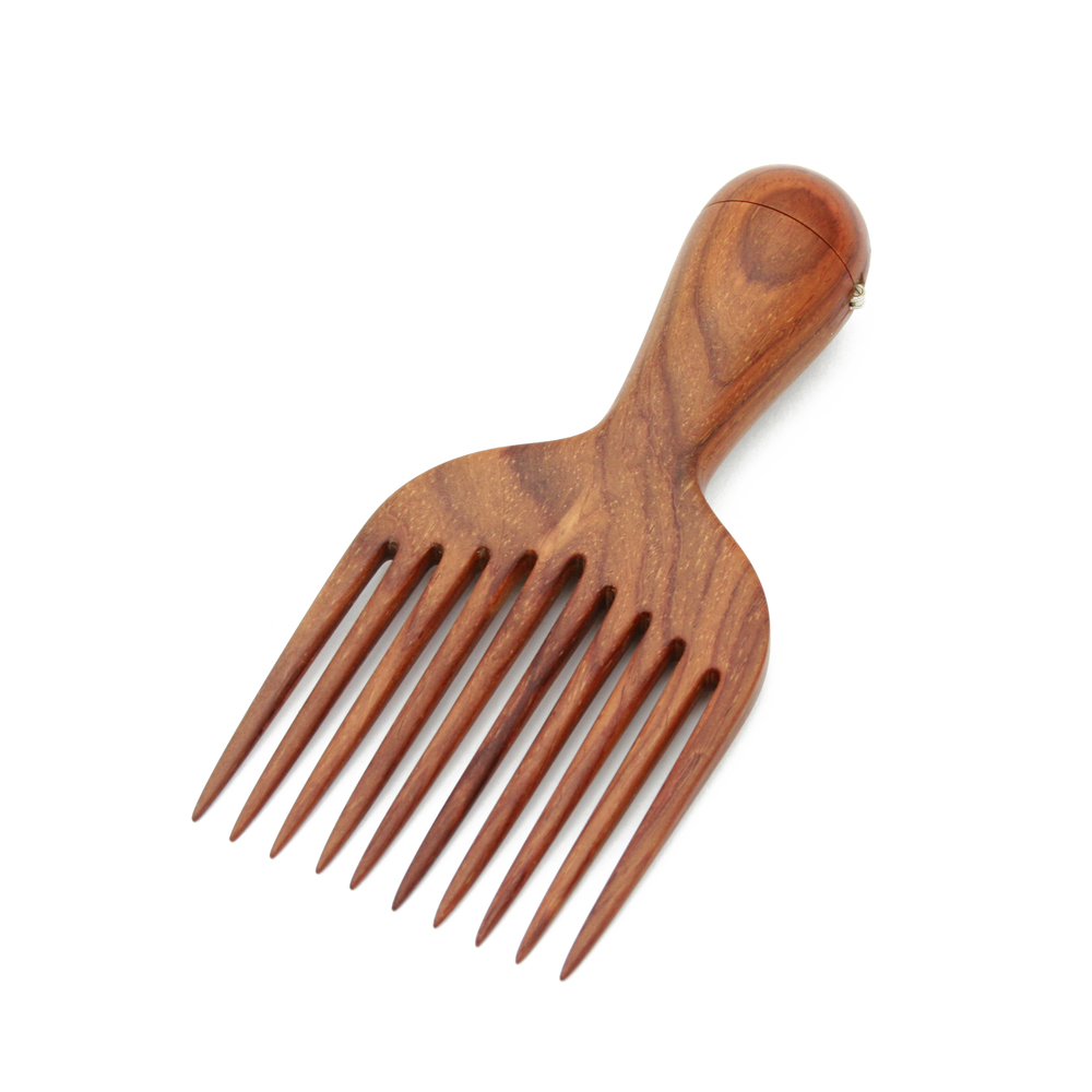

use a comb to lift and to act as a platform to scrub against.
damn good suggestion Swabby!!
Afro combs would be perfect for cut piles
