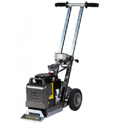

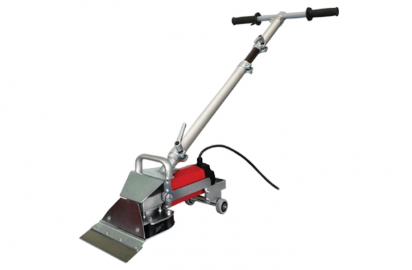

we've done a couple
I'm not into chemical solvent strippers......don't want to wait on time it takes for them to work...and mostly don't want to deal with a gooey mess
I rented these
I reckon rotary scarifiers Jeff mentioned would work too.
(never used one to know though)
No clue if any rental places will have correct size for Cimex or not
Some will have rotary carbide scrapers that fit common 15-17" rotaries though
if concrete is relatively flat/finished smooth (like a Home Depot , Sam's, Costco, etc) the flat scraper machine works well
think they rent for like $40 to $60 a day .
If tight areas, get the little one
If wide open, go big/heavier
They'll make you buy a blade ('bout 15 bukz)
(I presume same for rotary scraper) ...no clue what carbide blades for them cost
Reactions: Old Coastie
