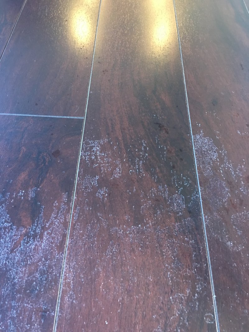

I've got a scheduled project with 5k' of engineered distressed hickory fused hardwood, with UV cured metal linked urethane coating. Exotic, beautiful floor!
However, someone used Mop-n-glo or such on it.

Job was a 2hr drive from me so I found a box with spare planks and asked to take one for research, as well as contacting Armstrong.
