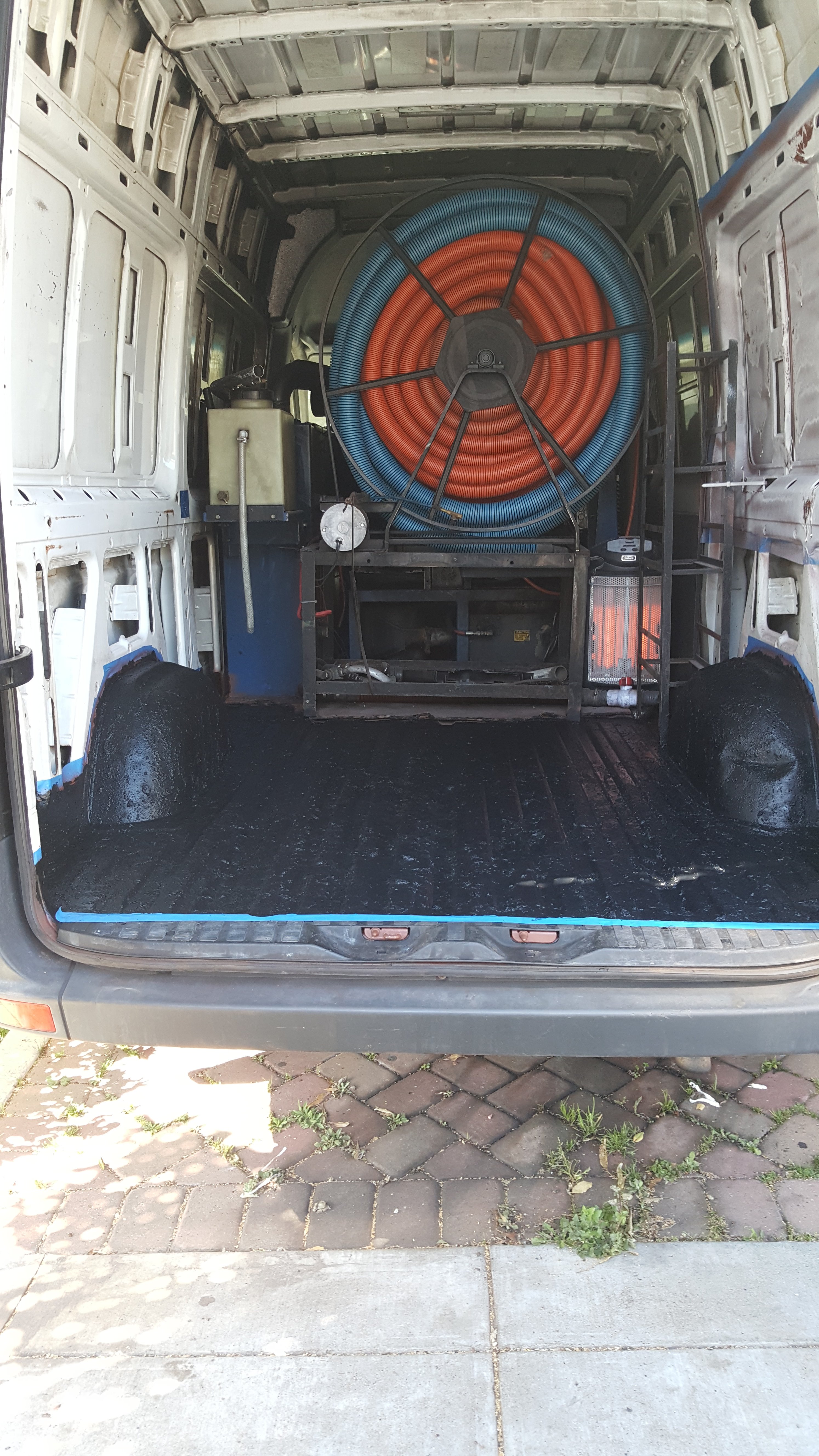

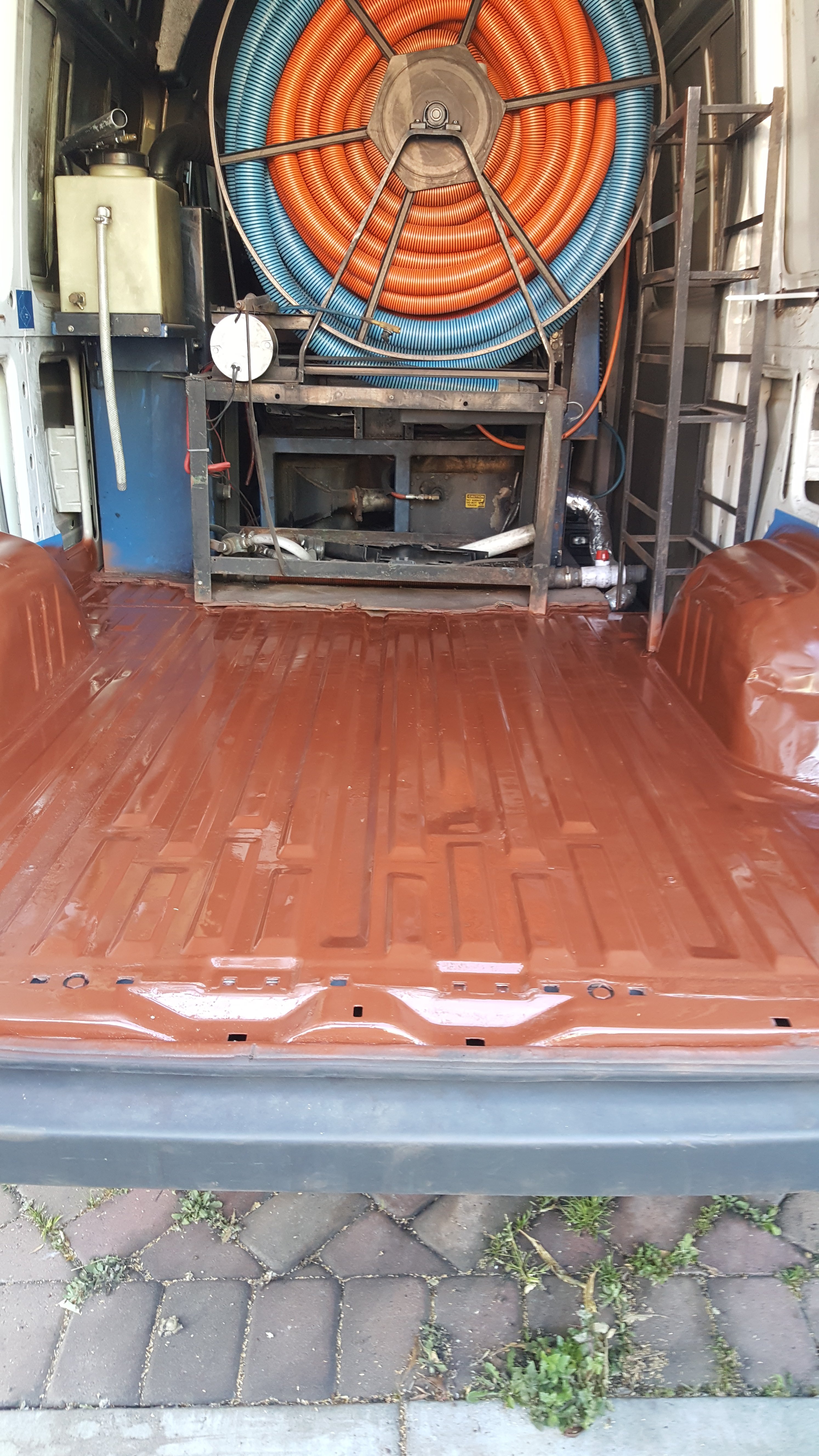

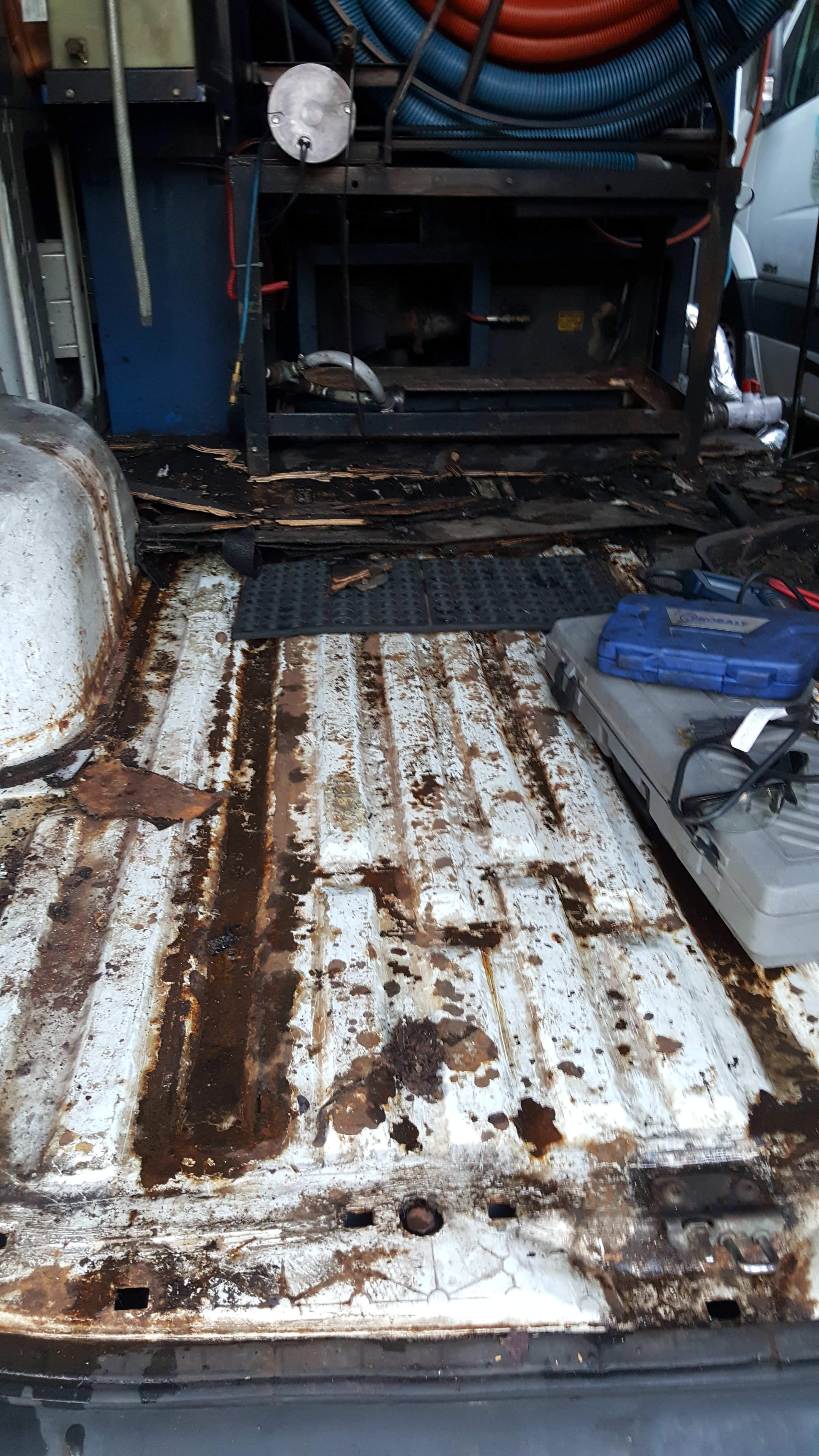

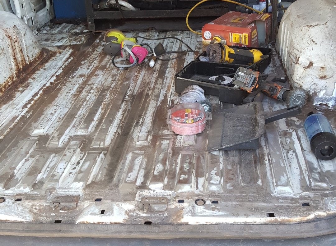

I did it myself with this stuff:
http://www.jegs.com/i/Duplicolor/31...MIvv2QgObJ2QIVFrbACh0kJADiEAYYAiABEgLgZ_D_BwE
It was cold when I did it.. I think hotter weather would have been better. I'm thinking smooth would have been better but I saved about $600.

All of the professionally applied products are tough enough to stand up to use in a cleaning truck. Rhino is slick, and ice-slick when wet, and anything not tied down will slide around. Regular Line-X is like sandpaper comparatively, but that grip keeps it from being slippy. The Line-X guys have come up with Line-X Pro, a product that is about halfway between rough Line-X and RhinoLiner.
Good luck with that. We found the Dupli-products to be less durable than regular paint. We had good luck with Herculiner, until about the five-year mark when it starts to break down and peel.
I agree that it dosent seem that durable, I'm hoping it needs to cure some more.

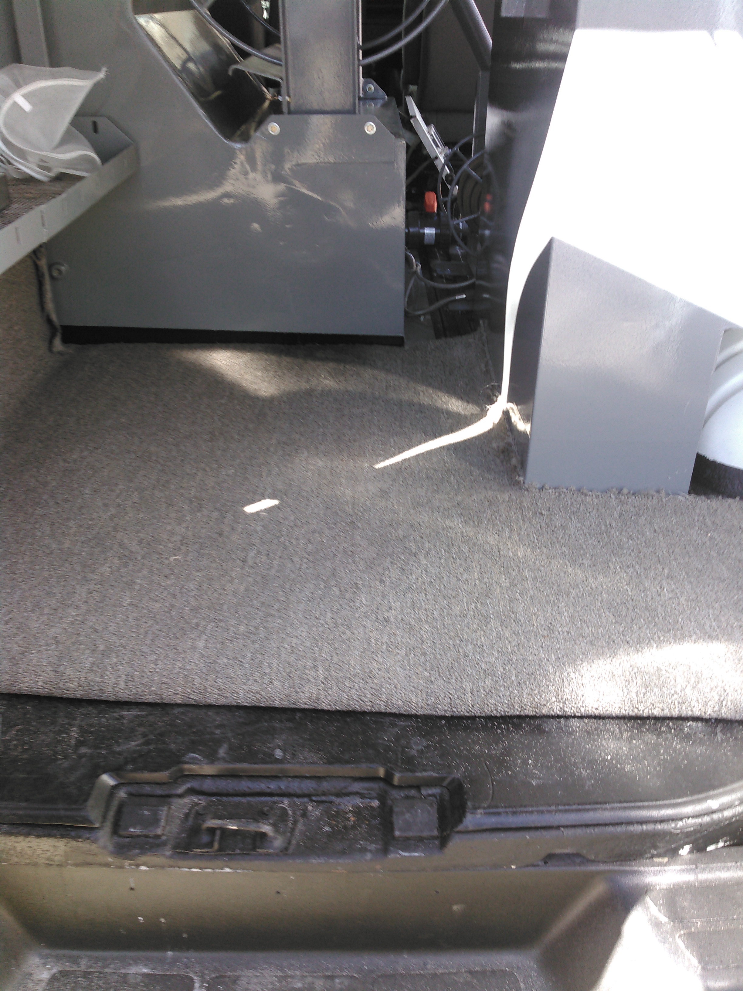

Not sure what's on mine but I got a piece of carpet for $35 to lay on top of it.
I'll pull it out occasionally to clean it and replace it if it gets too fugly.
should help with noise too.
