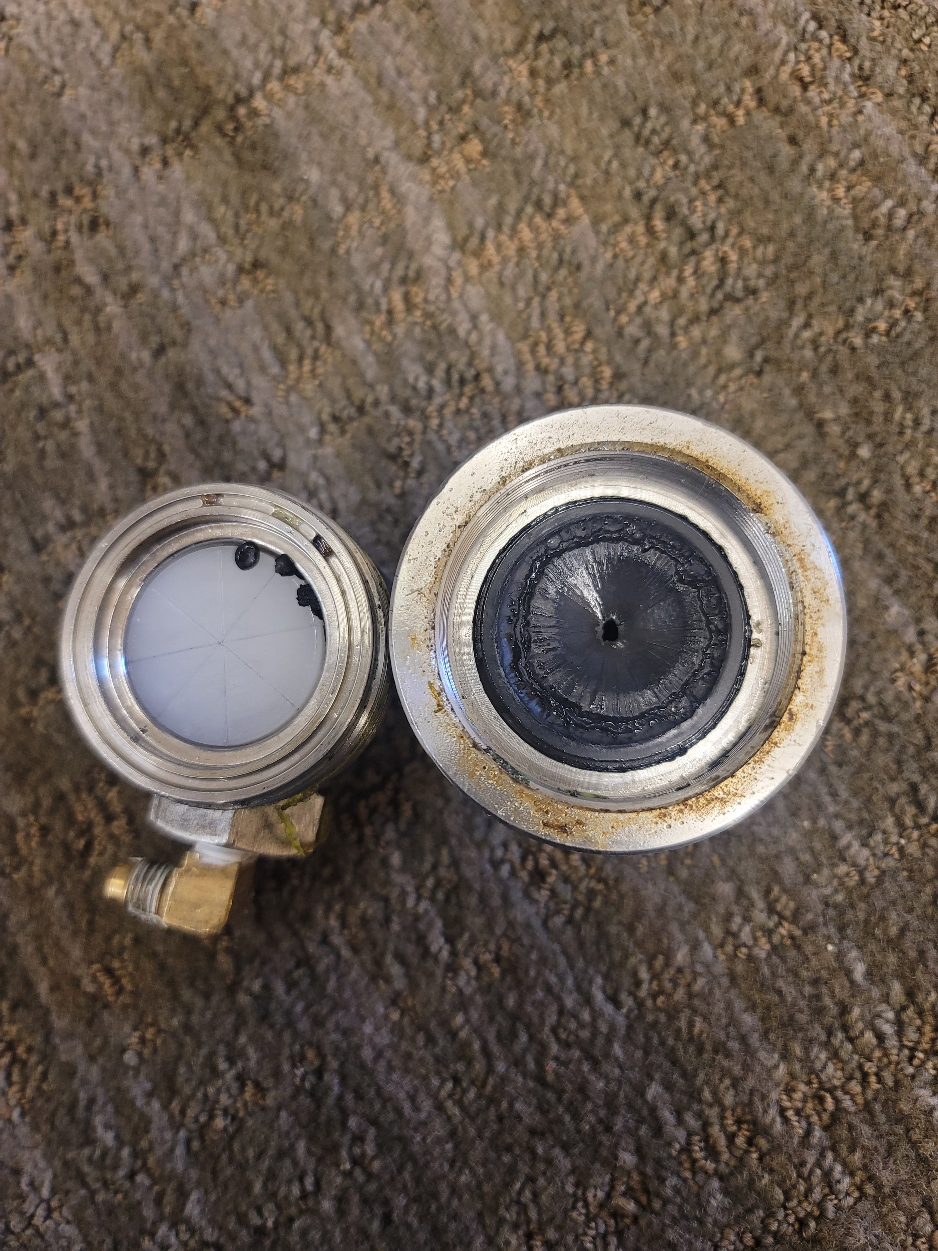

On my Everest 650 when I started working today my rinse jug was half full. When I finished it was full of water and overflowing. I have been having some issues with my chemical injection and plan to rebuild my pump, but this is a firs for me.
12,591
See if you have chemical in your water box.
If so, check your chemical pump diaphragm. You should also check the inlet check valve on your chemical pump.
If the diaphragm is good, look at the check valve at the point where your chemical is introduced in the pressure system.
Is the water filling your jug hot or cold?
Cold: Water is coming from your pump through the ruptured diaphragm.
Hot: Water is coming from the outlet check valve.

Thank you, Jim! I'll run it today and do some testing. I didn't even think to see if the water was warm or cold. Much appreciated

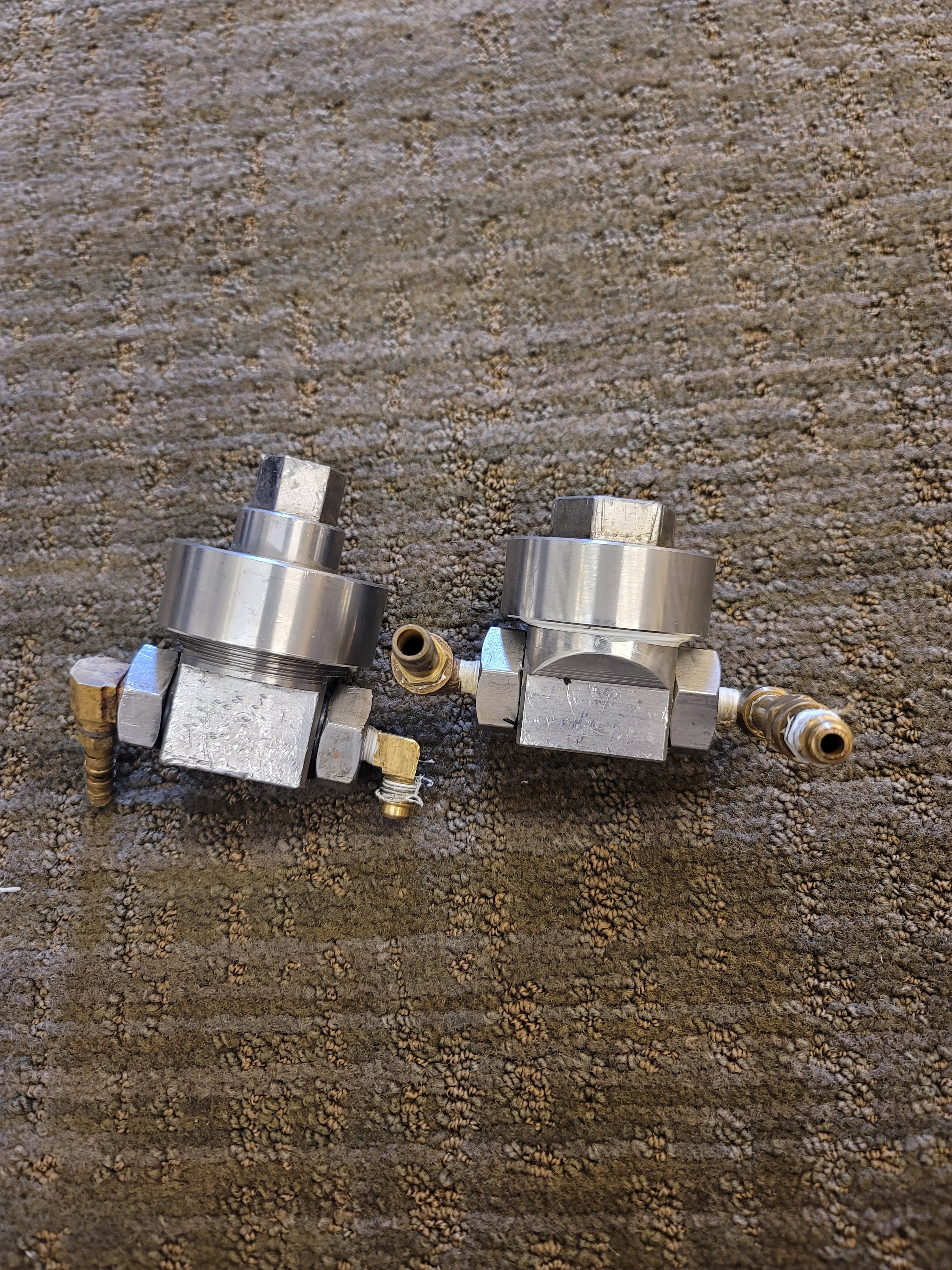

I tried to swap out pumps from my Boxxer to my Everest and it didn't work. I thought the pumps were interchangeable? Odds are that maybe the lines and everything else need to be replaced as well, but for future reference are the pumps interchangeable?
11,309
California
No the make a diaphragm and new check valves for the one that came off the everest

Thank-you, Sam! I'm in the process of ordering parts to rebuild. It takes a little internet work to cross reference the parts. I'd order from Jon Don, but they mark up the pump alone $100 more than everyone else.

Be very careful when putting that back together. It's made out of stainless steel and if you damage the threads you are done.
