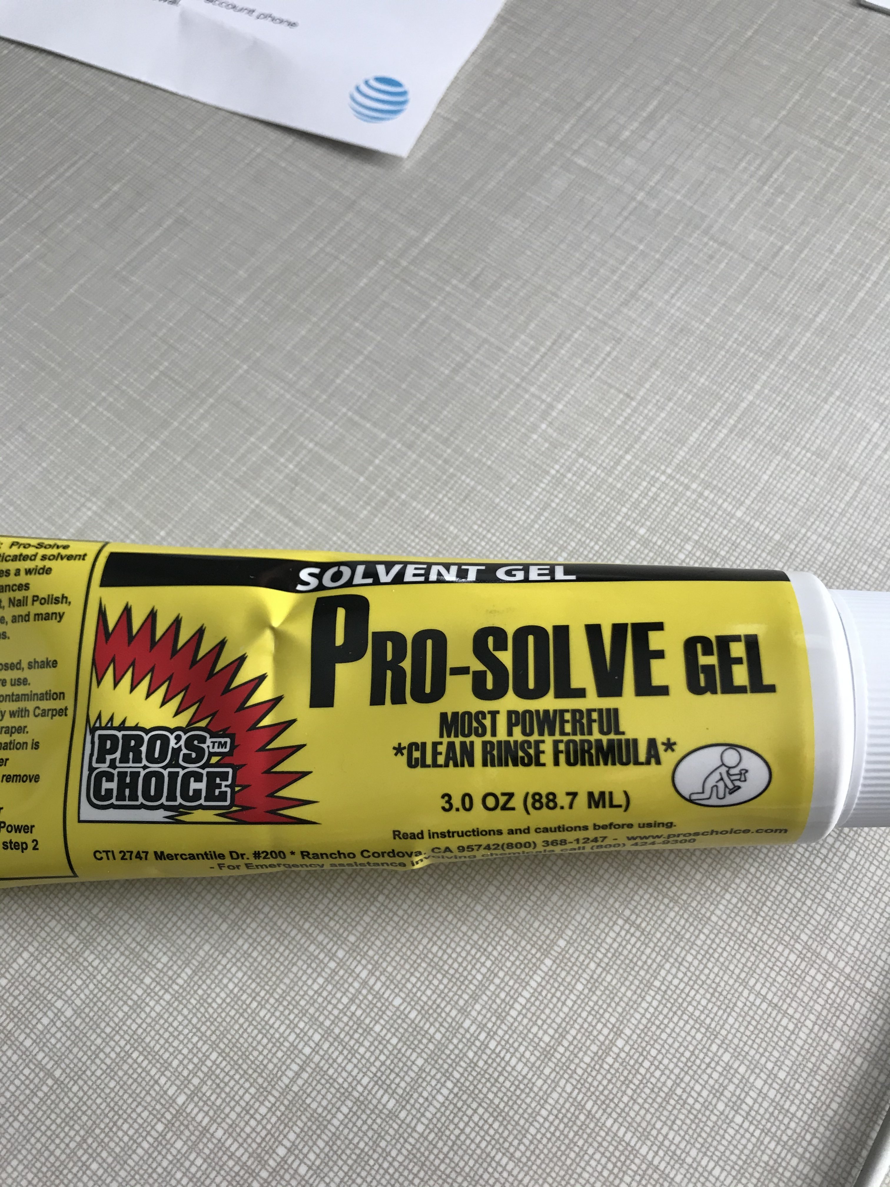

I mix a little of the black prosolve spotter with the yellow. It stays wet longer and seems to work better. Wd-40 works too and keeps the carpet from squeaking.
