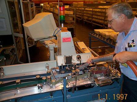

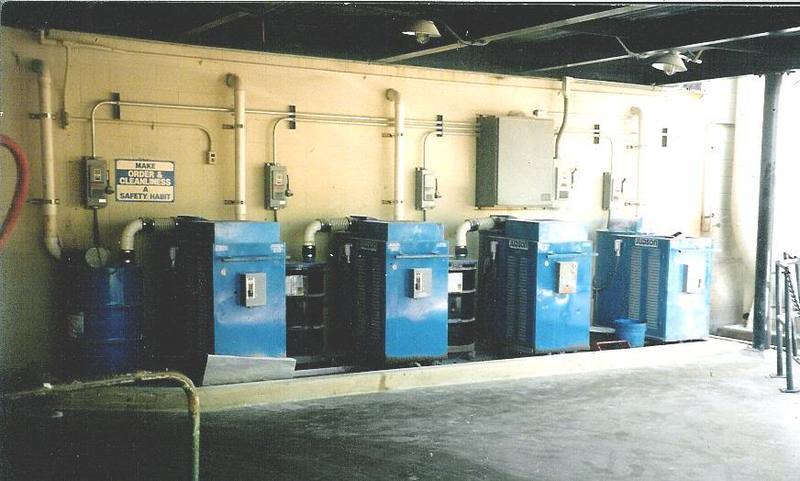

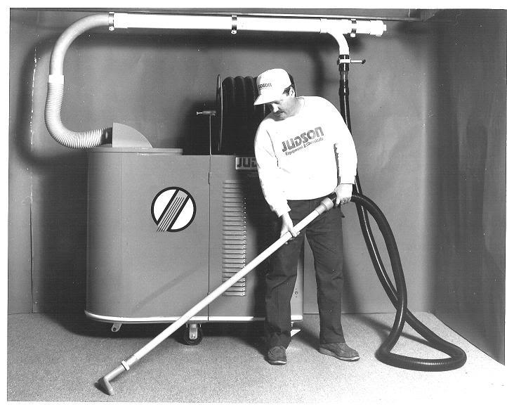

Judson has about 1500 Roots 45 blowers in our industrial vacuum systems. These systems run continuous 24 hours a day, 7 days a week. A lot of these systems still have the original blowers in them. These systems have more than 200,000 hours on them. All these vacuums use 30 wt. non-detergent motor oil in the blowers. The manufacturers of the blowers that are being sold today recommend synthetic oil. I received a memo suggesting that you can now use Mobil 1 synthetic oil in blowers.
