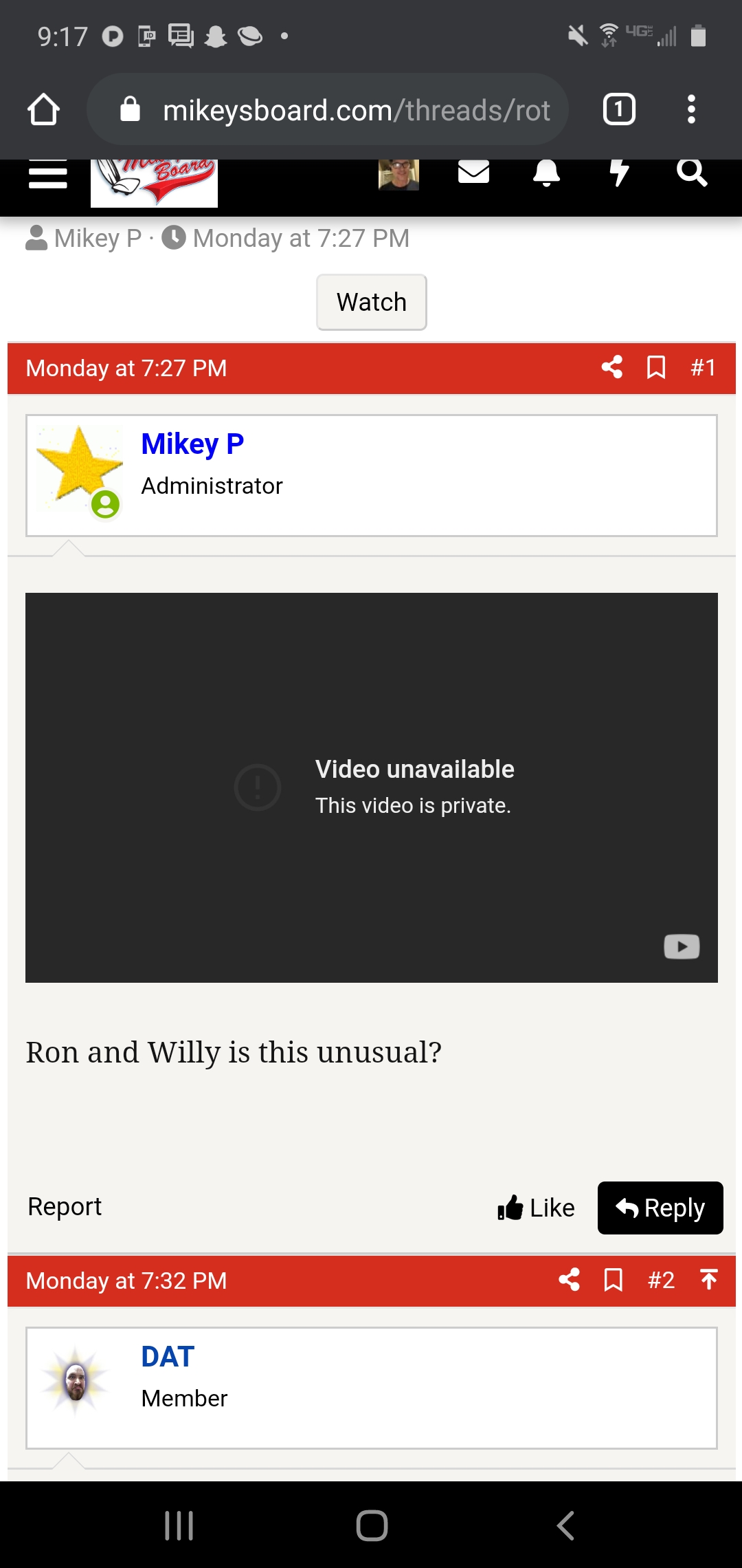

Ron and Willy is this unusual?
The test is wrong. Probably only turned 1 vac motor on the speedster. Not a fair test anyway as the speedsters are in parallel and the monsoon is in series. It's the same test they did with the new cfx. The cfx will pull 20 inches hg. But lacks air flow. My speedster will pull 11-12 inches hg which is around 150 inches water lift. The monsoon will be powerful but no more so than any other machine with 2-13.8 amp vac motors. The 220 psi pump is a little wimpy. On a 3 flow wand, it will struggle to produce 150-160 psi.

And I watched the video again and the 3 card monte truck was 1 vacuum switch hit not the 2. Watch the way he covers what he's doing with his hand. Friggin snake oil salesman.

Whoops. The video disappeared. Too bad as I was going to take a pic with a parallel system and a vacuum gauge just like his. I might do it anyway because i cant stand bullshiters and insults to my intelligence. I wonder if John L.got on someone's case as they don't carry mytee and that was a pretty blatant smear. Stay tuned folks! This could get interesting.

Either I've been blocked or the video disappeared. Tomorrow I'll post the true picture.
