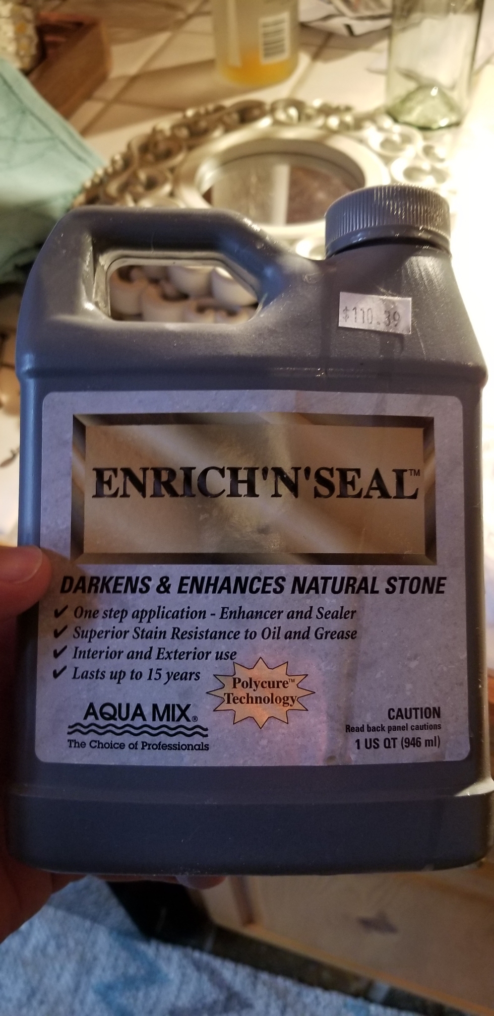

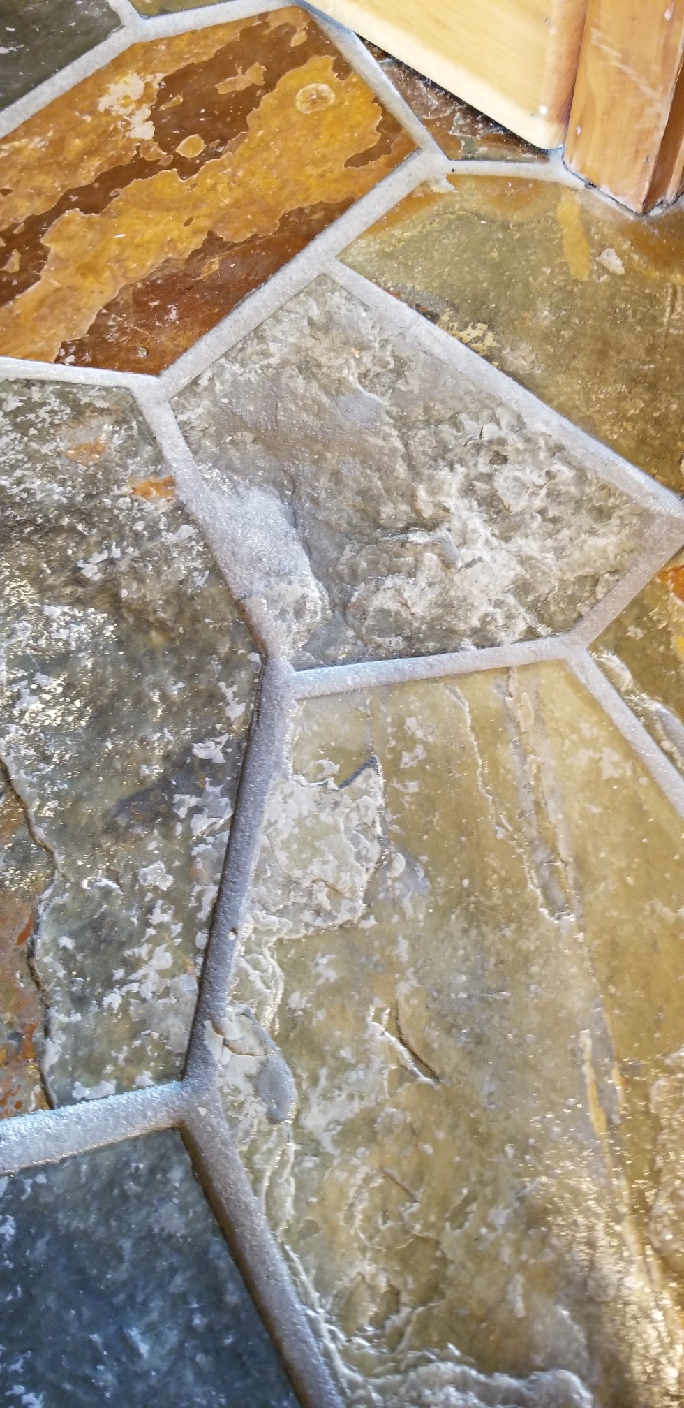

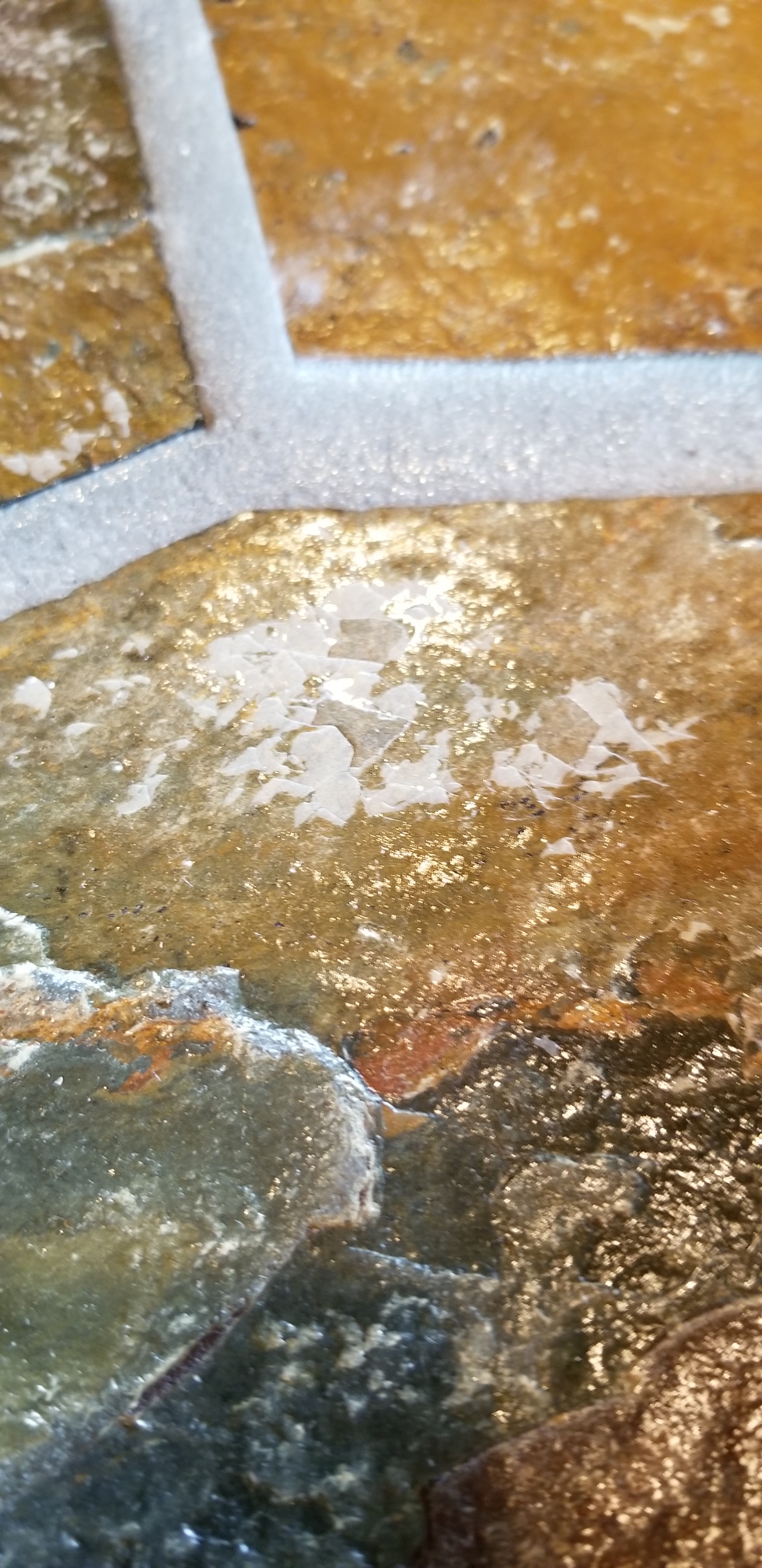

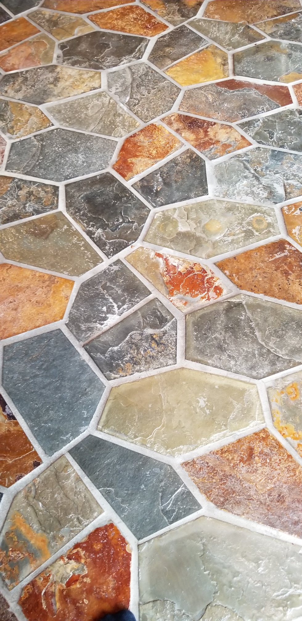

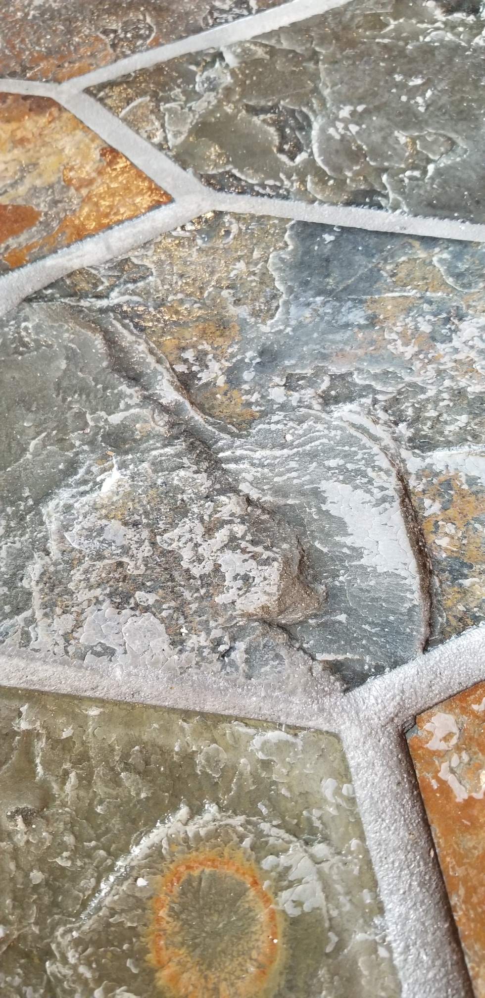

Mark was asked to correct this failing enhancer.
Looks like a topical mess to me , not an enhancer

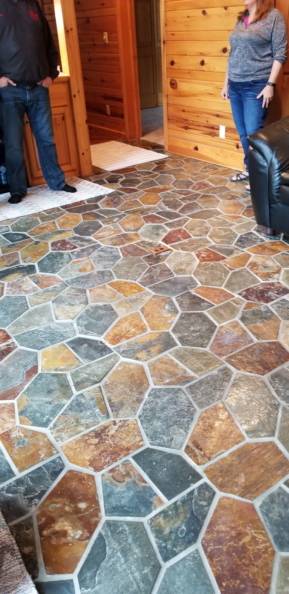

9 month old install, customer swears onlt the shown product was used..
clean image

Great product used incorrectly
Enrich and seal is a 100% solids penetrant enhancing sealer.
Goes in, not on the stone.

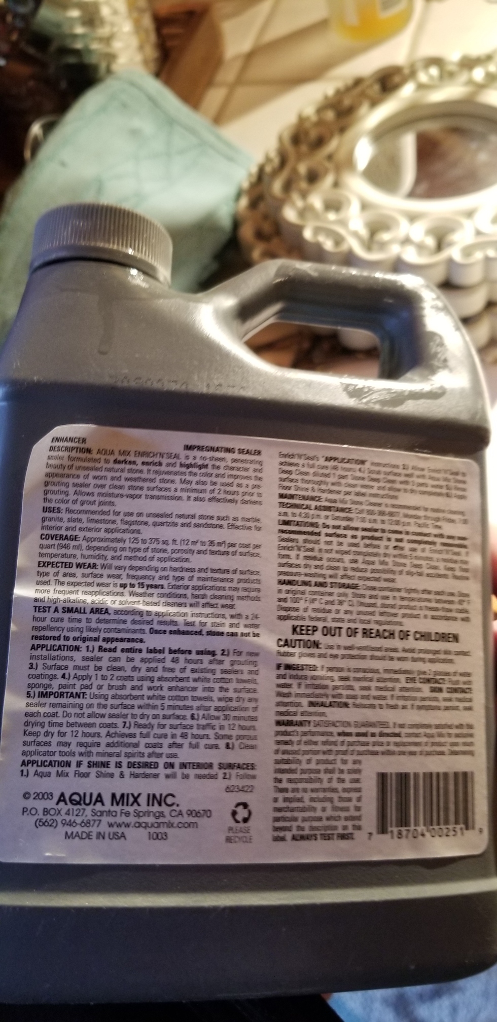

Clearly states it right in diections
Andy
Feb 5, 2016
966
No Where
Doesn't Matter
Agreed Over applied. If leaving it with the customer the label mentions to use Aqua Mix Stone Deep Clean to get it off.

It also said, once enhance, stone cannot be restore to original appearance...
