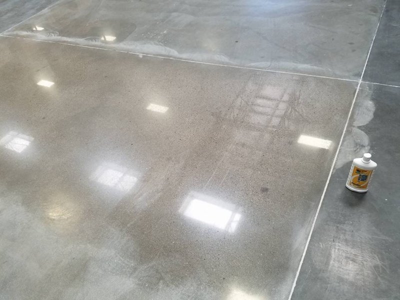

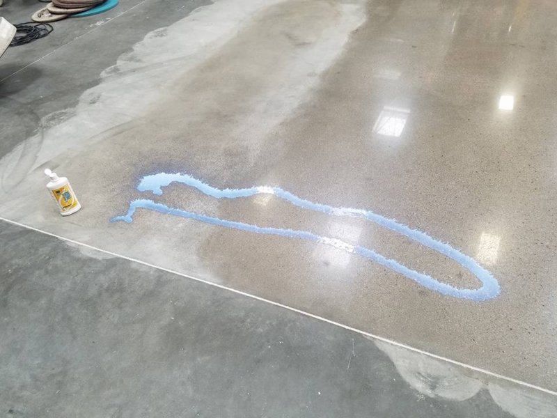

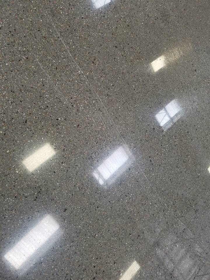

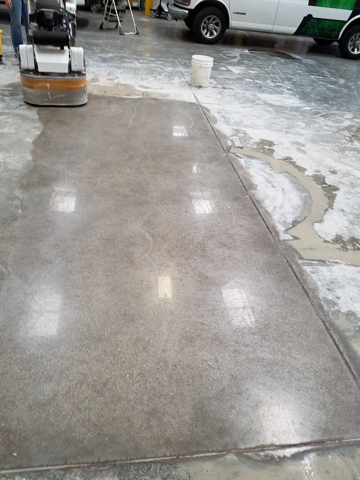

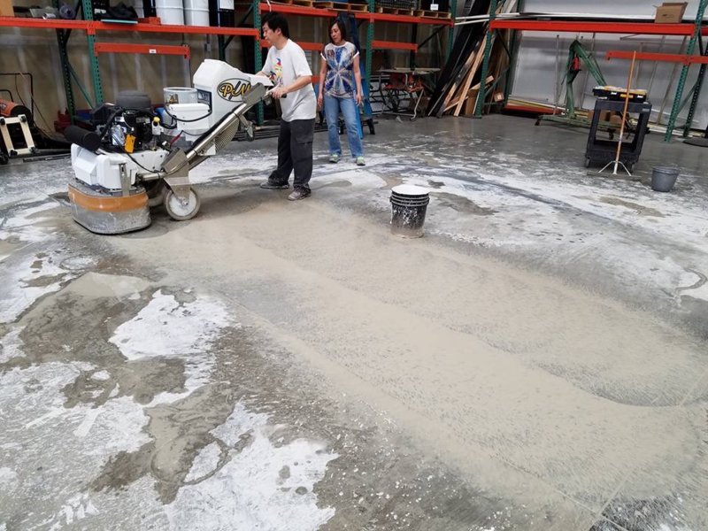

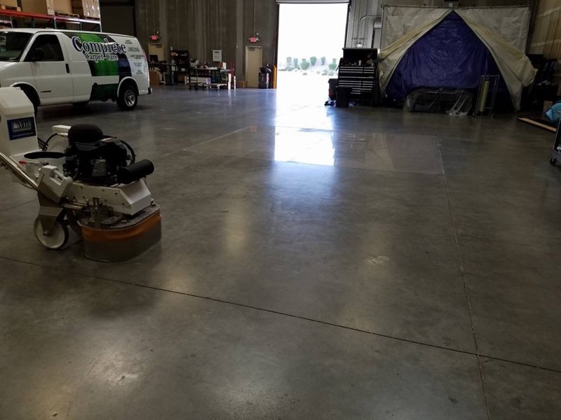

Here are pics from another training session. We got the floor naturally shiny and then I showed what a difference the guard makes. The drama is that guard can scratch, but naked concrete can stain. Guard is usually used for commercial and natural for residential or high end commercial.

Aramsco Interlink can rent the equipment and provide training to a cleaner who scores the occasional garage or convinience store polishing job, but they have to purchase the diamond abrasives, so there is an investment.
The first 3 steps to grind down and totally expose the aggregate are metal bond diamonds that cost about $120 each and you need six for the smallest rental grinder. The epoxy resin polishing grits are about $35 each and those steps are 4-8. If the concrete is dull but not deeply scratched you don't have to start at the lower, more expensive grits.

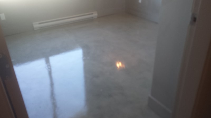

My problem is I have a situation where there's lots of concrete available for me to do with a larger property management company that I've serviced for 12 years now , but it's all stained or etched. The potential is substantial, but I'm such a virgin in this area that I'm reluctant. I pull 4ok a year out of this account, so I really don't want to eat crow there. This is what I've done , but it's all scratchy and needs to be resurfaced. The pic was of a condo where the floor was epoxy coated and just didn't have the flash the client wanted. I can make it shiny, but ......

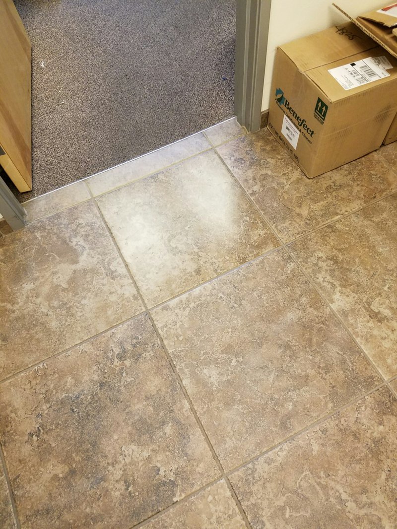

My new favorite finish is Formula 404 from Sentinel Products. It acts like a high end concrete guard but it's priced like a high end floor wax, and it even works on ceramic. I've had clients give me rave reviews over how this product has held up. It even worked on a notorious strip club stage and held up against all the high heels etc. I put some on a ceramic tile outside my office door over a month ago and it still looks great. It will set you back $178 for a 5 gallon pail and is available from Aramsco Interlink.
