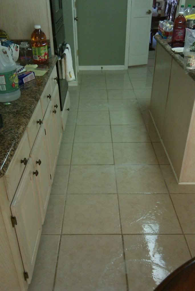

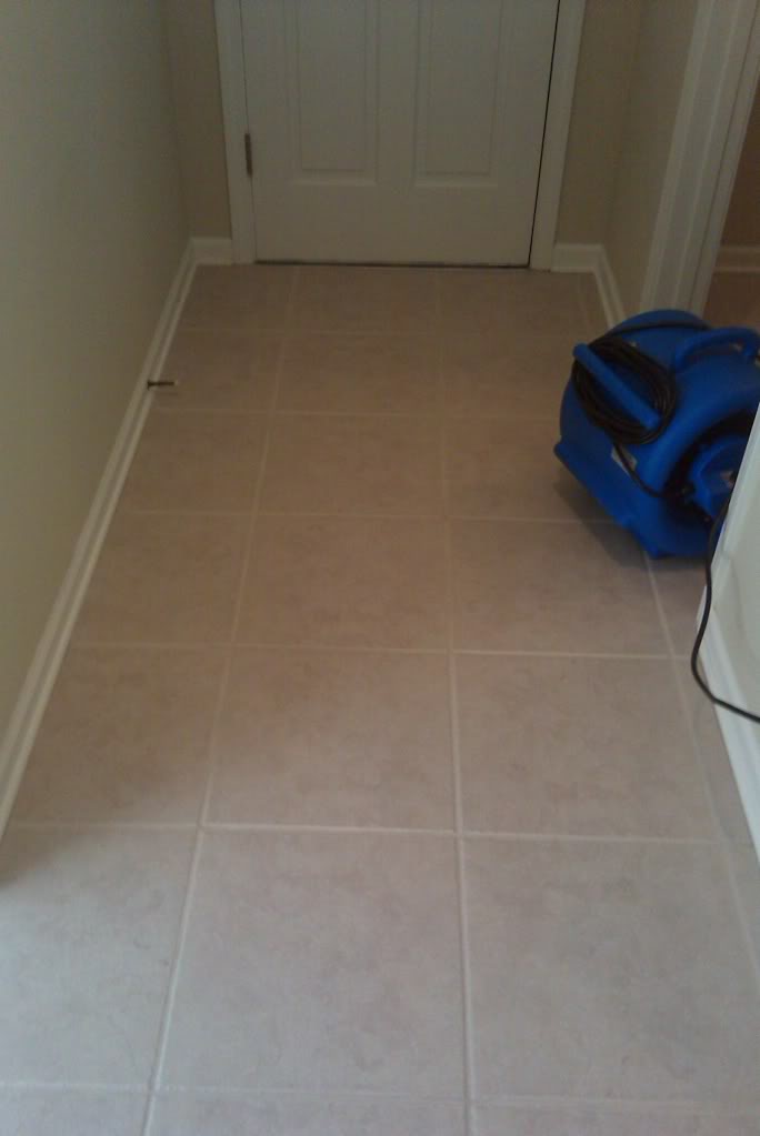

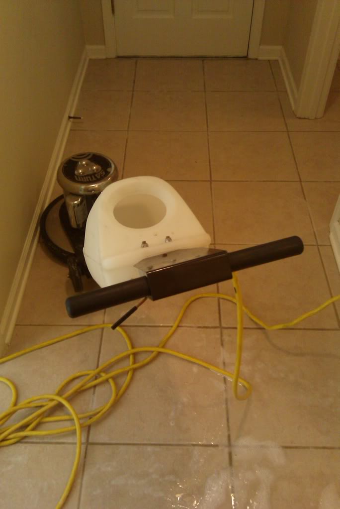

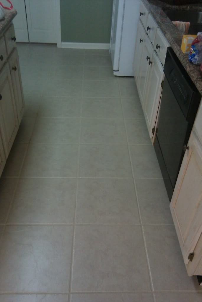

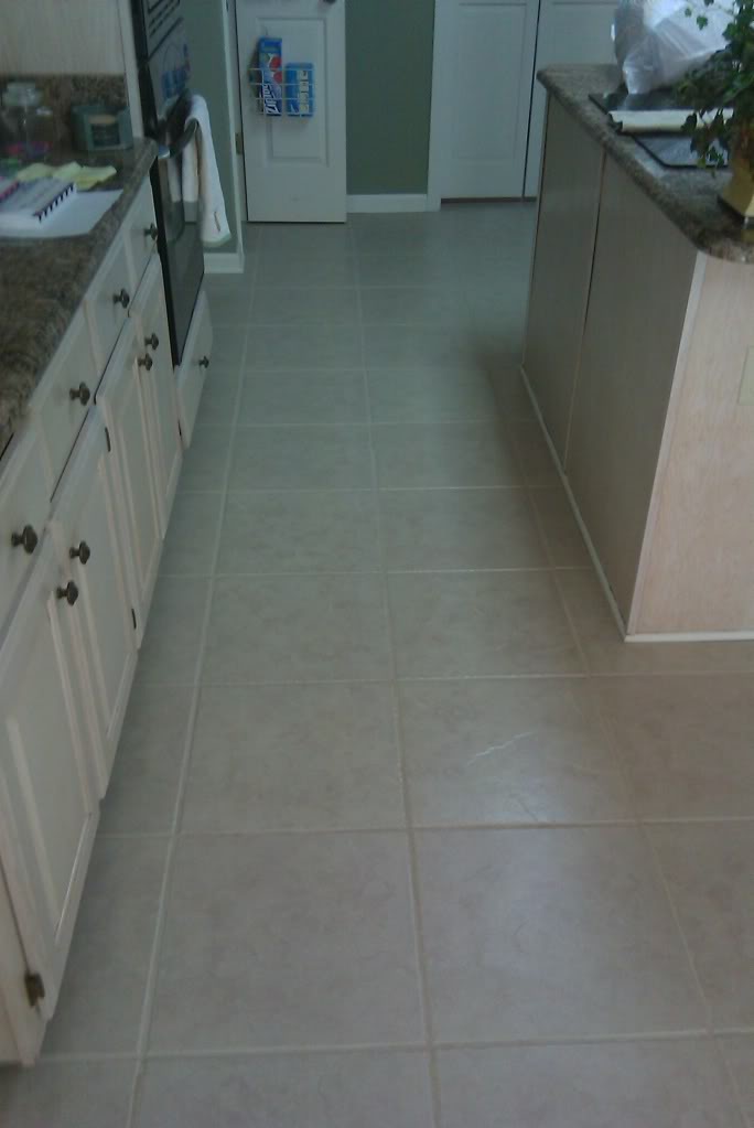

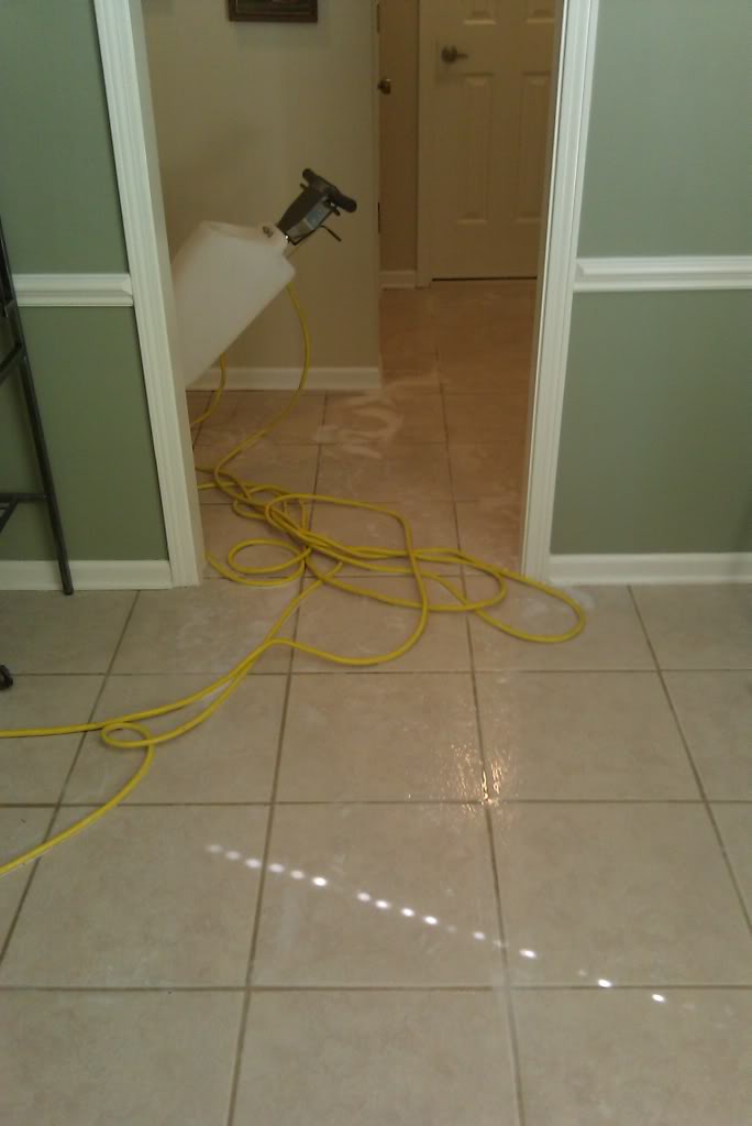

Sep 7, 2008
3,797
I have tried several tile cleaners including strippers. If the floor is dirty they will clean the floor with dwell time. If the floor is stained from the customer mopping with mop n glo or pine sol it is going to need to be scrubbed. I have a new chem I am going to try next time. I hear it just needs to be spread around and then sucked off. We shall see. The photos are after scrubbing for thirty minutes with a 175 and grout brush.
